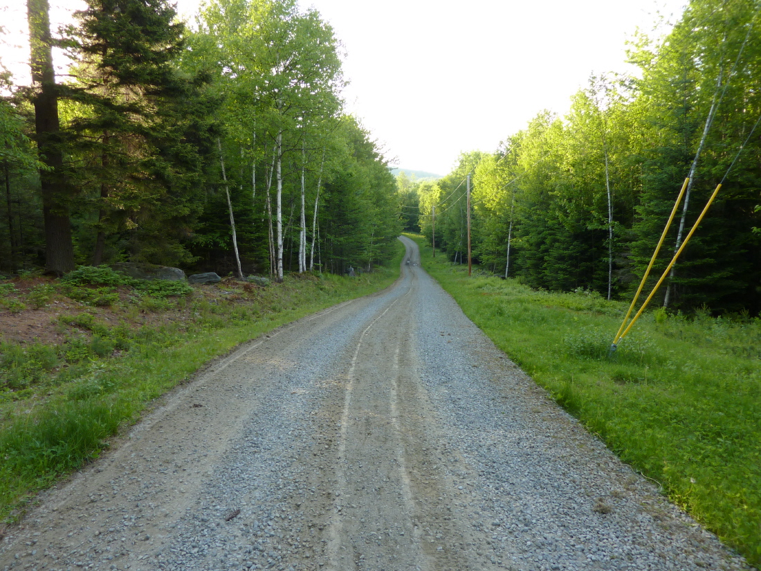

I have a hilly drive. It is hard to get a good picture of steepness. This is much steeper than it looks. Approaching 10%
I grade this with a 30 hp tractor and a 5' landplane w/o any trouble. Traction not hp is the key as said before so you want a heavy tractor. I probably make 3 or 4 passes up hill for each one down. As Steve said you want to move the gravel up to offset nature moving it down.
