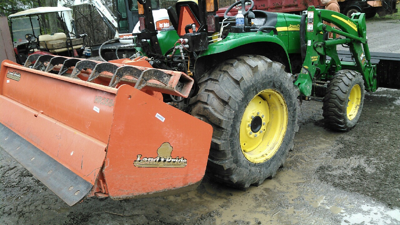

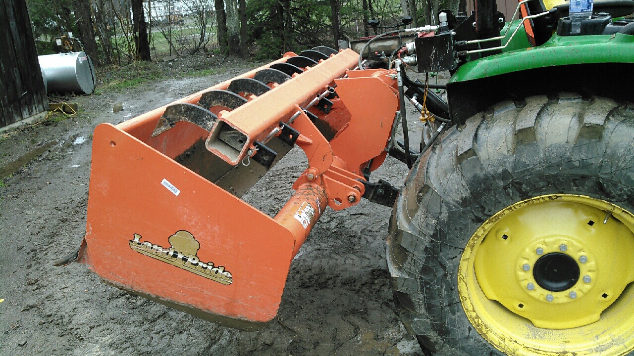

Well I just got done unloading the box blade and so far everything seems ok , a couple chipped scarifier teach, the first thing I dis was look down the lenght of the cutting edges and didn't see any bow or deformation in them . I will post some pics when I get on the tractor later today

Here a a couple quick pics

Looks really good, mine's not much better and I paid way more for it.
/ Landpride 3584 #38
Looks good. And not a slam on your tractor, but, that BB will wear out several tractors that size. You did good.
If you want to test your tractor, drop the scarifier and stab it in the ground. You'll see what I mean. That BB is a beast and will never suffer any damage on your sized tractor. Good find.

I totally agree with you, it is a beast and gives my tractor a workout like it hasn't had with the other boxblade it replaced I wouldn't want anything bigger. I am very pleased with it so far but have to get used to the floating tailgait it makes it very sensitive to the top link settings
/ Landpride 3584 #40
You probably already know it, but you can lock the tailgate in place with a couple of bolts. I haven't locked mine yet, but will in the next week or so for smoothing some of my roads. My TnT really helps, but I still have a way to go to get as good as I'd like.
