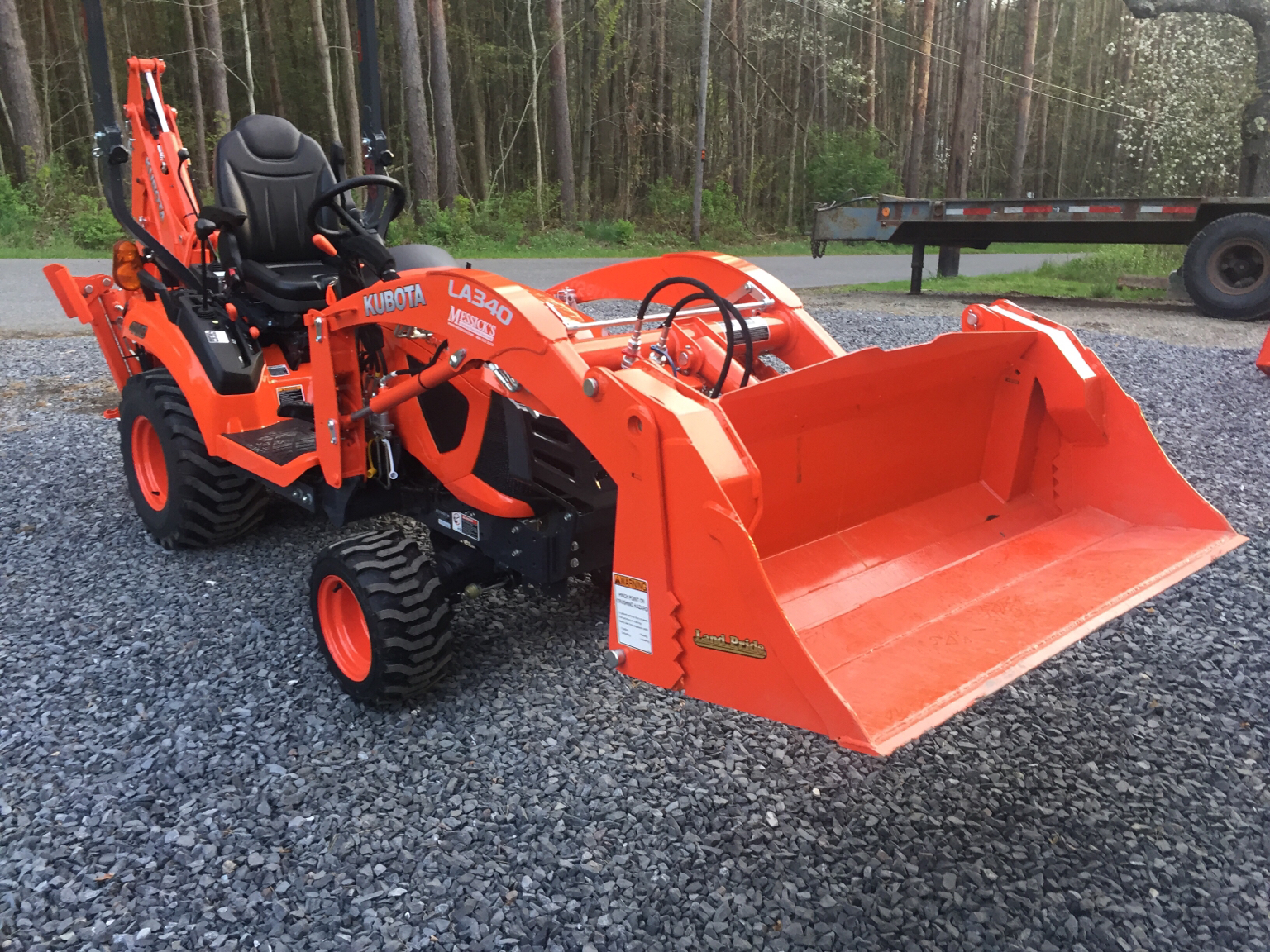

This looks like it could be a pretty useful item for my bx2370. I believe it works with either the quick tach or without. Anyone here used one of these? Thanks....

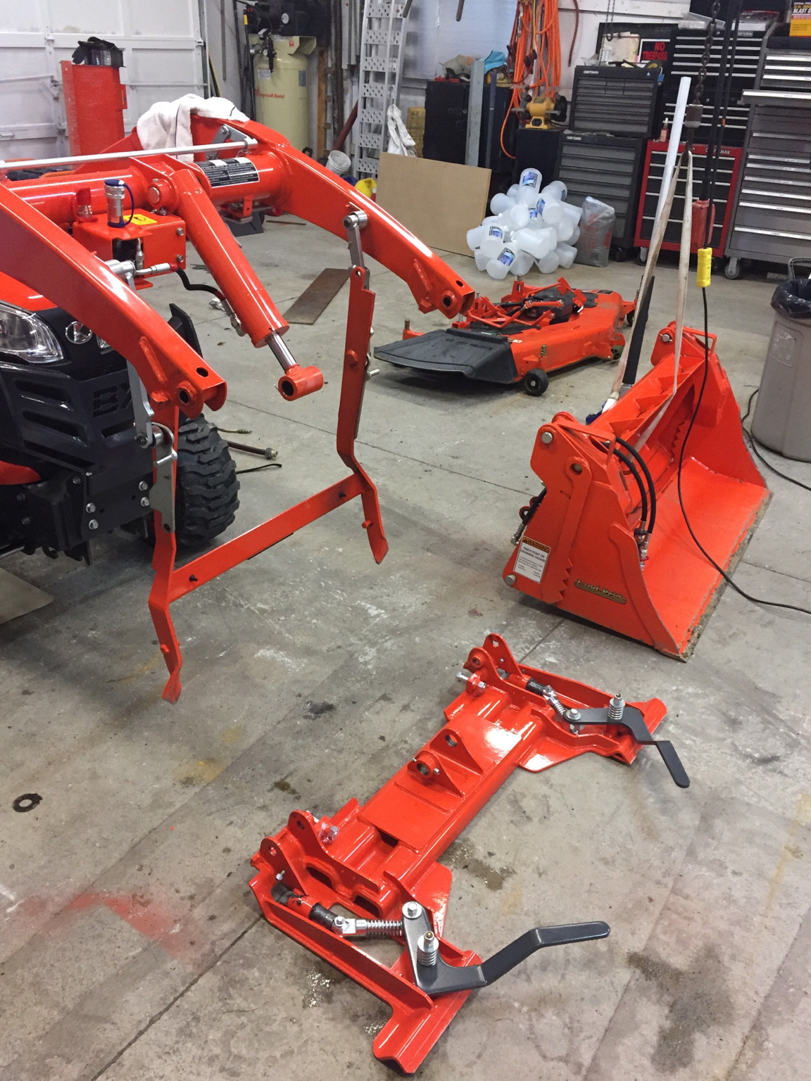

I have one. It's only available in a pin on for the bx. Biggest problem with it is it doesn't come with any kind of level indicator. An you can't see the front edge of the bucket at all. I added one to either side of the bucket when I got it home. IMG_6073.JPGIMG_5897.JPG IMG_5959.JPG

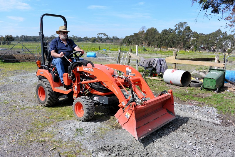

Clearly mine comes from somewhere else after seeing the pics, I utilise the flat bar across the bucket that protects the hoses as a level indicator.

I have one. It's only available in a pin on for the bx. Biggest problem with it is it doesn't come with any kind of level indicator. An you can't see the front edge of the bucket at all. I added one to either side of the bucket when I got it home. View attachment 531914View attachment 531913 View attachment 531915
I can't see the front edfe of my regular bucket on my BX. The only time I've actually been able to see the front edge of a bucket was on my Bobcat T190 skid steer loader. Is this your first tractor?
Yours looks like a factory kubota bucket
