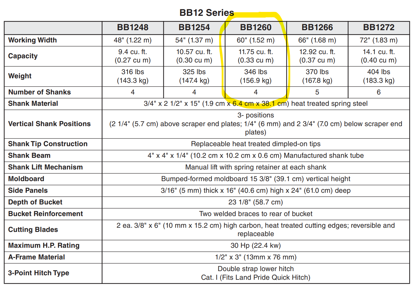

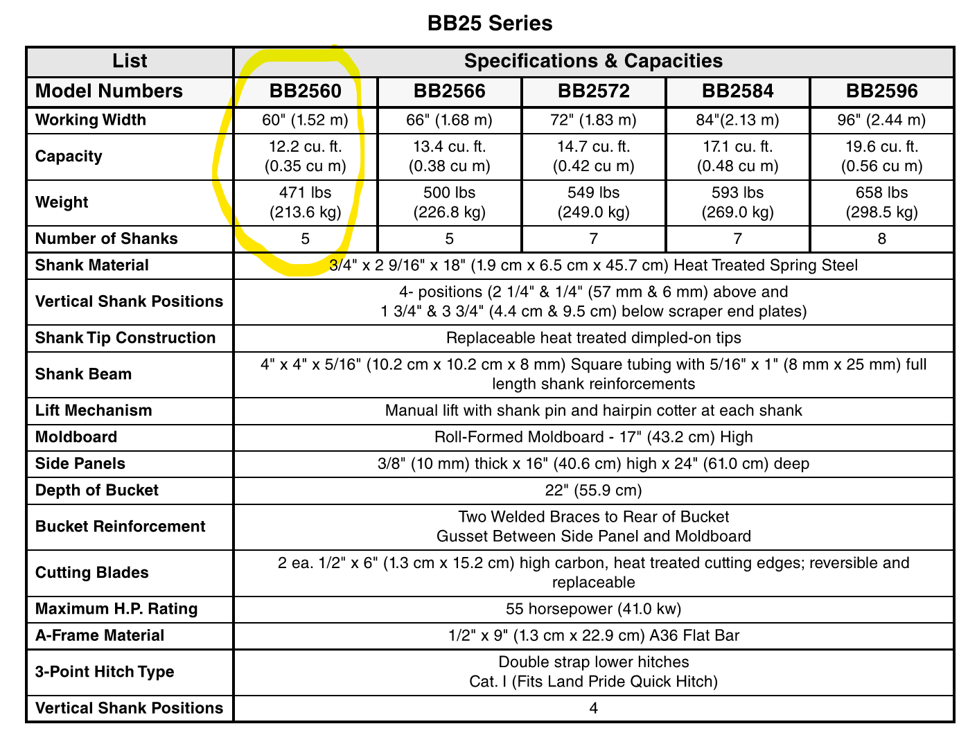

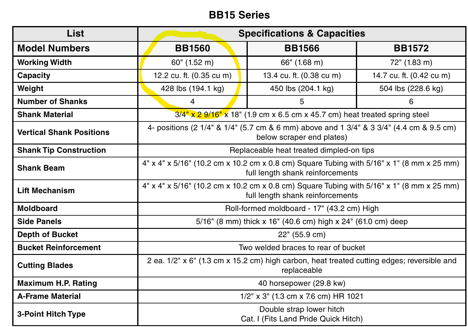

I need a blade box for light residential driveway work - for removing some rots and spreading new gravel. I have a Kubota B3200 with loaded tires and 4" spacers.
After reading the forums, I left with the impression that for grading work the weight of the box blade was vital. Because of this information, I went to my Kubota dealer to price a Landpride BB1560 @ 428Lbs or a BB2560 @ 471 Lbs.
To my surprise, the Kubota dealer is telling me that the best match for my tractor would be a BB1260 @ 346 Lbs. Of course, ironically this is the only blade box he has in stock. They want $1,000 for it, which is tempting.
I would like to get a second opinion from the group to verify whether a lighter blade box like the BB1260 would be adequate or a waste of money. Is 346 Lbs on a 60" box good enough for residential work? I honestly would love for this smaller BB1260 to work well with my tractor and my needs but I need to double check with the group.
Yeah, its great dealers when try to convince you what they've got in stock is what you need...
Go heavy on box blades or rear blades if you plan on moving a lot of dirt. My place is all slopes so I make roads and flat spots all the time and the box blade and I've been redoing my 1/4 mile driveway ditches this fall and its a good tool for that. I think about 25% of my total tractor time has been with the box blade, and I've glad I got one that ended up in the 150lb/ft range. But probably one near 100lbs/ft should work well.
If you think you are going to use it a lot then going heavy is worth it, a light one will probably work, but it will more take more care not to break, and more passes. A hydraulic top link is nice to have to use the scarifiers without dropping them, and dumping a sticky load of dirt, also I should get a side link as well.
There are a few things a box blade can do that other tools can't, with the scarifiers, dirt containment, and pushing with the rear blade, all in one.
