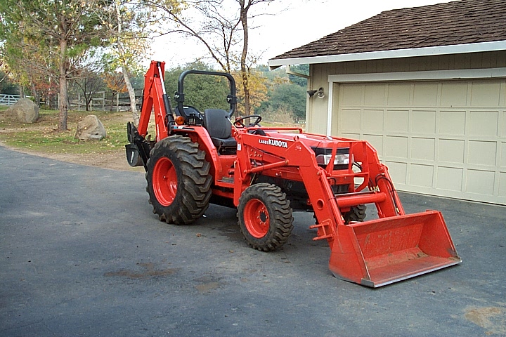

Here is a picture of the Loader mount. It is the bracket on the right loader arm just behind the bucket. I use the top-n-tilt remote hydraulic valves to control the auger on the bucket. When mounted on the backhoe, I use the bucket curl circuit to control the auger speed and direction.
Hope this helps.
-Roger
