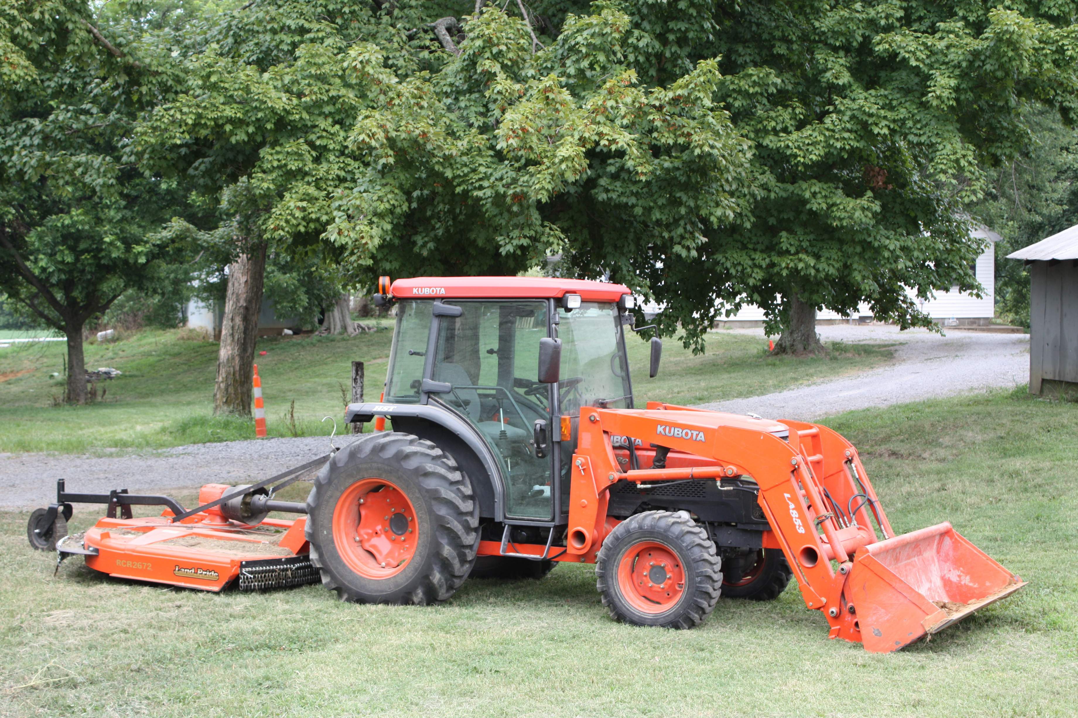

I have been running a Land Pride RCR2672 first behind a L5030HSTC then L5740HSTC and routinely use it on steep hills, pond levies etc. and it has cut 3" and a bit over and is, in my opinion as good as Woods or Bush Hog, we also use a Woods DS1260 on our M8540. I've heard Brown are better, but I couldn't afford the price.
The RCR2672 weighs 1100 pounds and I have to leave the FEL on in hills, but it does fine on flat land.

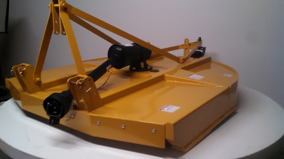

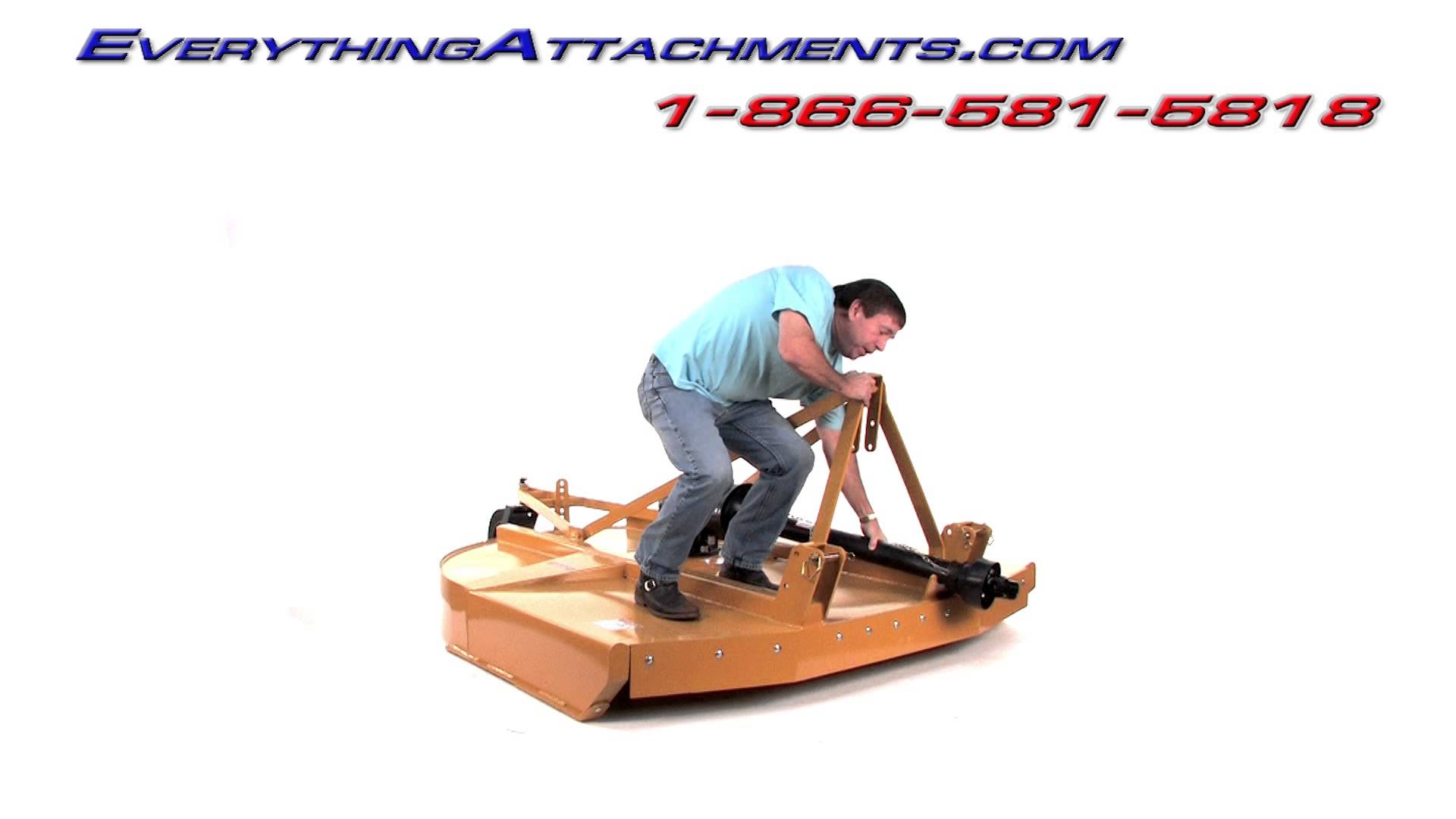

Have you seen the EA 6' cutters? Land Shark Tractor Attachments | Land Shark Rotary Brush Cutter
http://www.tractorbynet.com/forums/attachments/322653-bush-hogging-how-video-eta.html
The Landshark:
And the heavy duty model: XTreme Duty 72 Inch Rotary Brush Cutter Tractors with up to 75 HP by Everything Attachments
http://www.tractorbynet.com/forums/...ary-cutter-first-post4066647.html#post4066647
