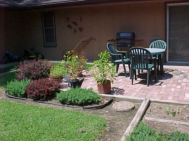

Earl here is a pic of my small patio set with old bricks on a bed of sand, used pressure treated 4x4s, drilled 1/2 in. holes and drove 18" in rebar through the holes into the ground to hold them in place. see attachment
jim
