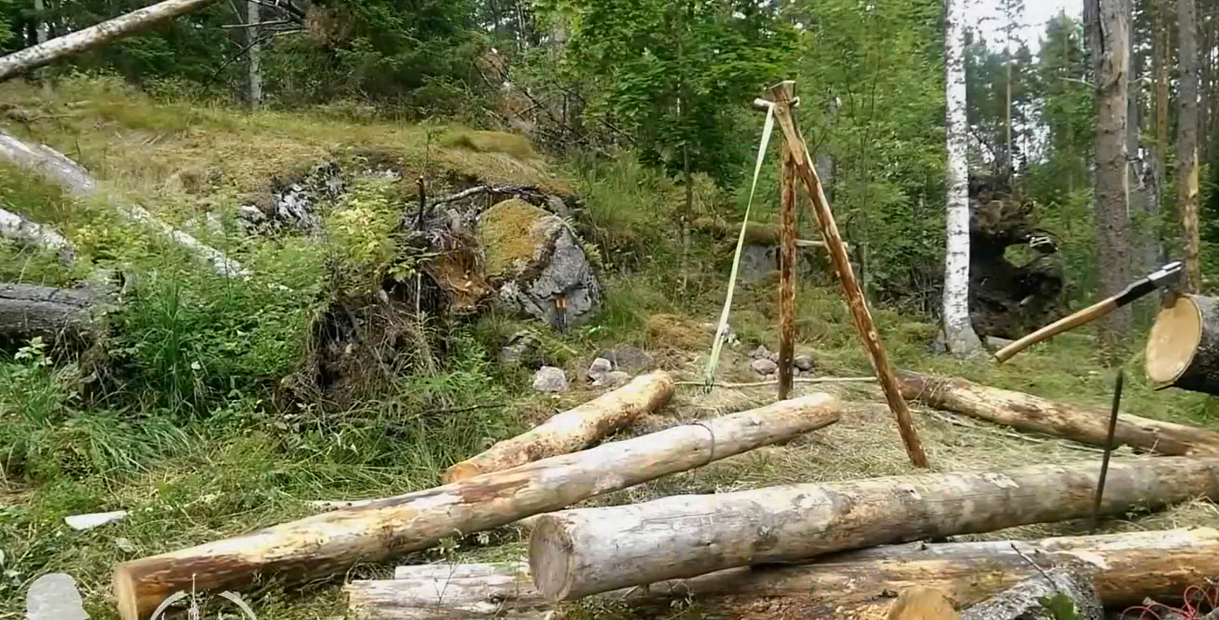

bigger machine and utilize a A frame above it check how he utilize it in the first second of this video.
I love the video and the simple tool construction.
