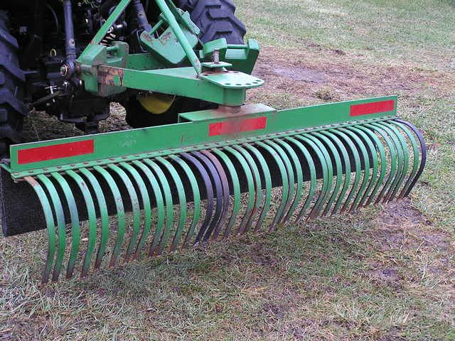

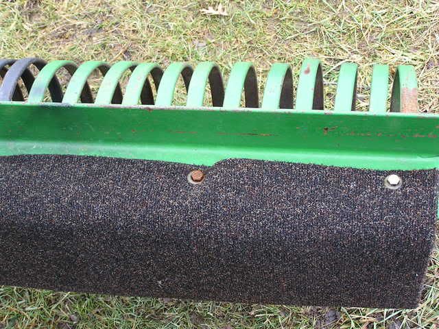

ccsial, here are the pics of my landscape rake that I added the indoor-outdoor carpet to deflect any stone away from the rear and glass on my tractor. If you have any questions feel free to ask.
I started by doubling the carpet for added strength. Then I punched holes so I could install grommets in the holes to prevent the holes from tearing out once the bolts were installed. I put the folded edge of the carpet towards the ground. Once the grommets were installed I marked and drilled the rake frame so that I could bolt through the gromlets and rake frame. I kept the carpet about 1-1/2 inches off the ground when the rake is fully lowered,so it wouldn't wear from coming in contact with the ground.
The below pic shows the carpet mounted on the landscape rake.
The below pic is of the landscape rake from the rear.
The below pic is a close up showing the bolts thru the grommets.

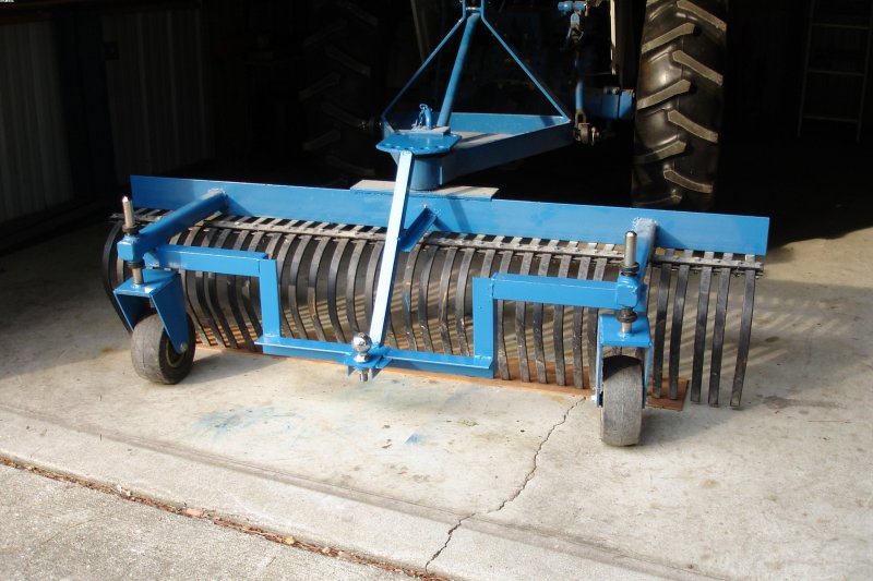

Thanks Dirt,
That looks good. I have the same rake you do except I painted mine Ford Blue. I also added gauge wheels and a tow bar for my water trailer. I'm going to do the same thing pretty soon. I have been thinking I needed to do something but have not really thought much about it. This looks like a real good solution.

ccsial, geez now I wish my rake was all painted up and clean.lol. Not my color but,nice looking set up. You will find that the carpet works really well to keep any stone from bouncing of the rear of the tractor or even you. I had been hit a time or two on my old open station JD870. I also was amazed at the amount of little stone chips on the back of the 870.

I took that shortly after I painted it last year. It won't stay that way though. I'm looking forward to grading the trails this year with the carpet. I even have some blue carpet left over from my boat.:) Thanks again.
