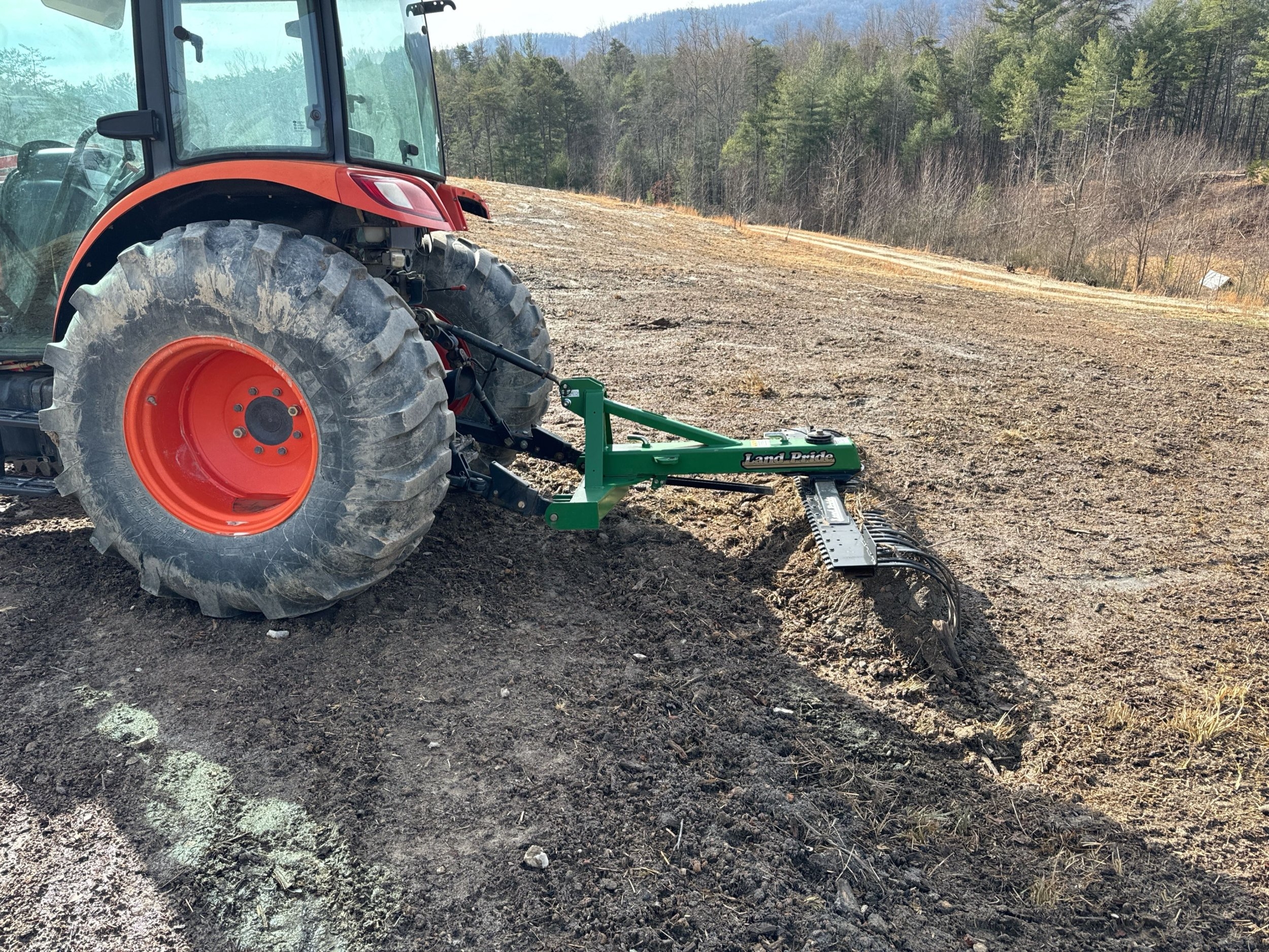

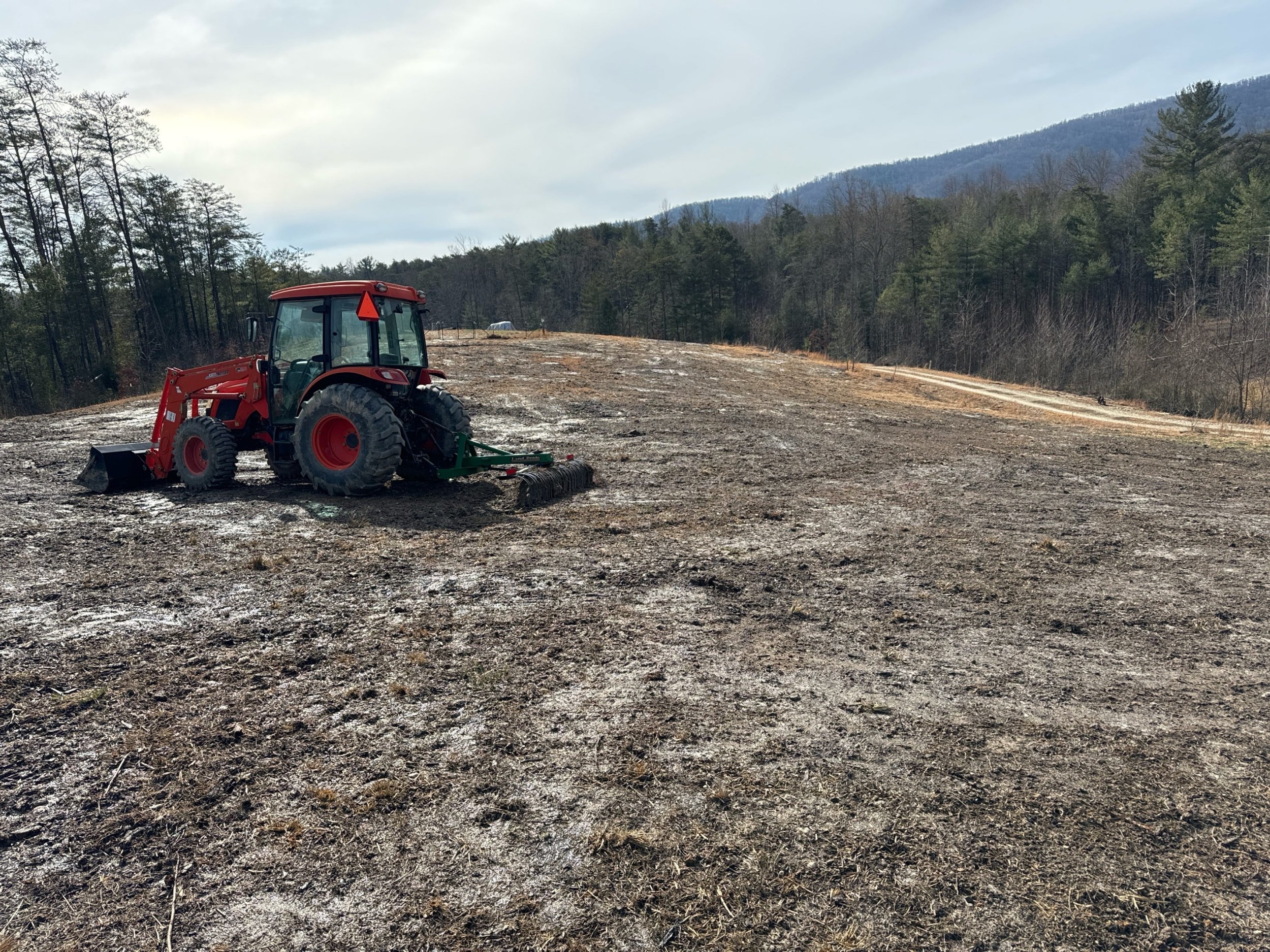

I'm not sure why you would want to back up with the rake on the ground. The York doesn't work well in reverse. The curve of the tines causes the rake to ride up over the material being raked.
Once in awhile, if I have the gauge wheels fully lowered, the 3pt hitch won't raise the rake enough to clear debris on the ground. I considered making brackets to extend the gauge wheels farther to the rear so they would rotate 360 degrees. Instead, I installed a T&T kit which solves the problem.
View attachment 854657 View attachment 854656
I wonder if set so one pulled it with the tines reversed if it would break up manure clumps.
