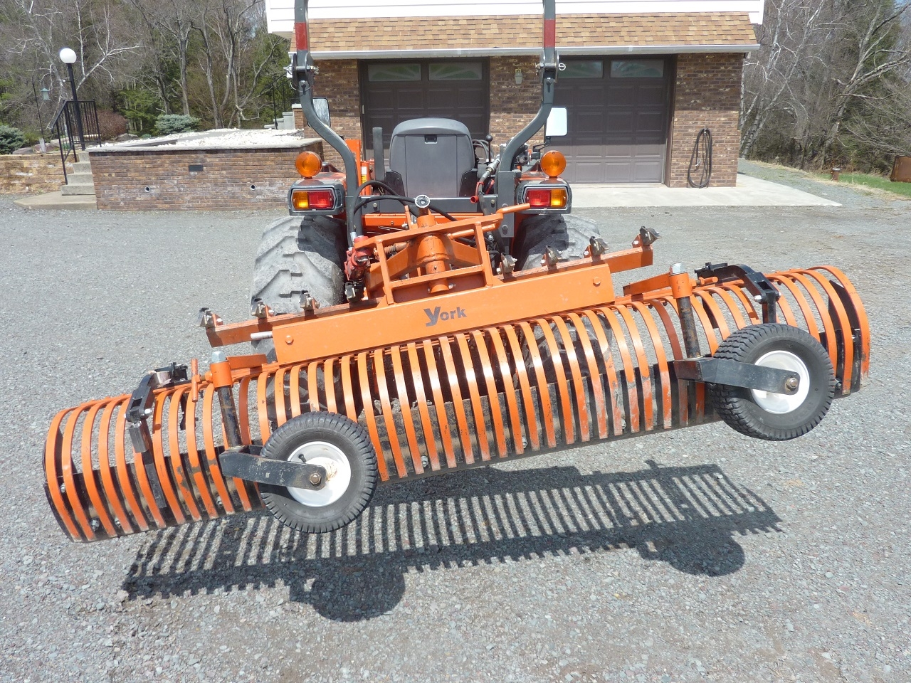

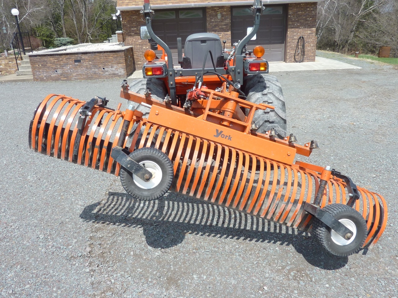

I've had great success using a York rake with a T&T kit and gauge wheels.
I go slow with one hand on the tilt lever and rarely scalp the lawn.
   / Landscape Rake to get gravel back onto road? #17
That is real nice.
