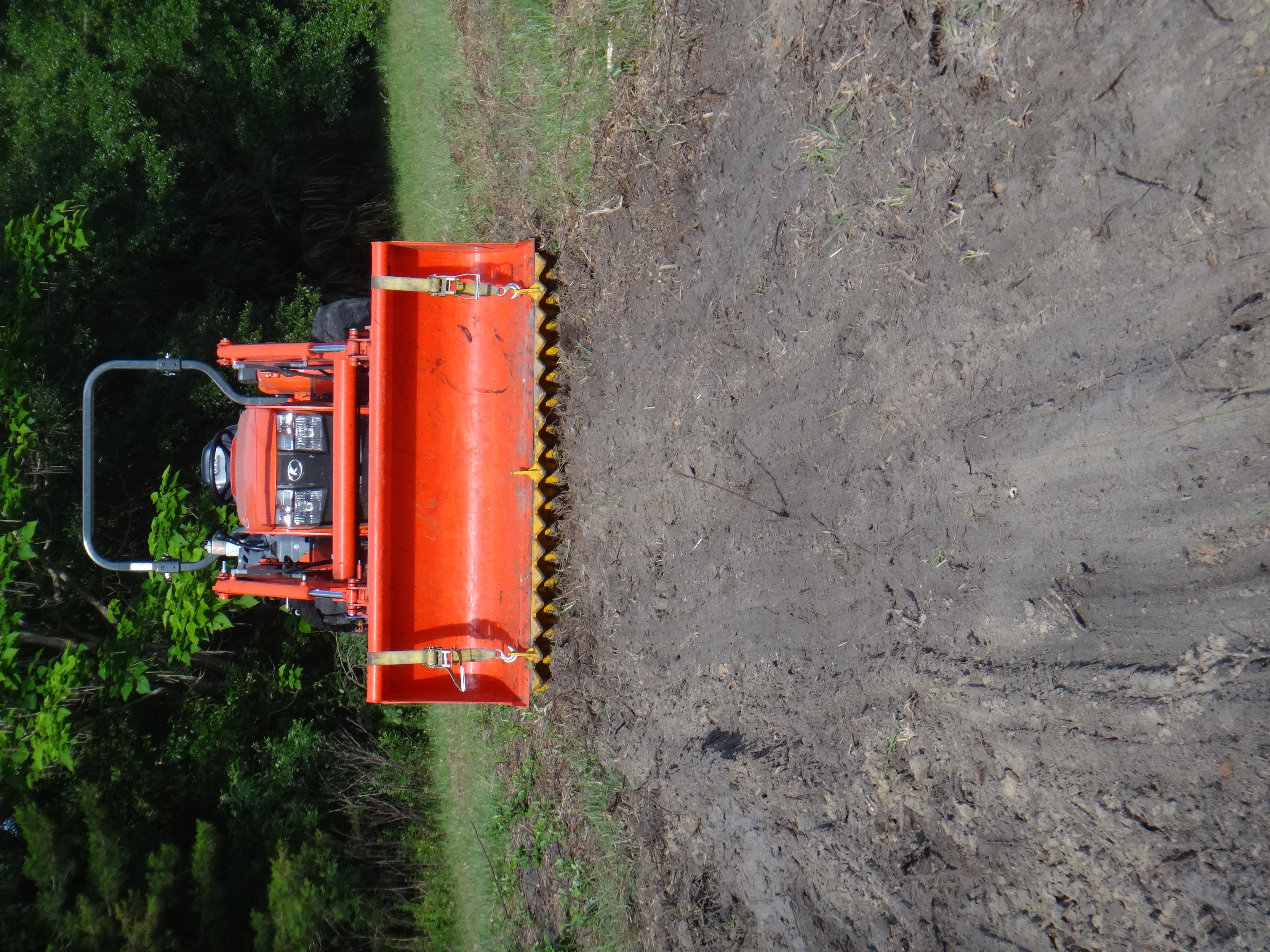

So long story short I was approached by a gentleman who recently purchased an old nursery, and wanted it bush hogged. After mowing the property he asked if I would be interested in removing about an acre to and acre of half of landscape fabric the old owners had installed, and has since been covered by about 2 inches of dirt, and grass now. I explained to him at this point I have absolutely no idea what would be the best bet, however I would see what I could come up with. I am thinking that a landscape rake may be the best option to try, and catch one corner possibly and just slowly work my way across the property a little bit at the time? The owner wants to plant fruit trees back in the area using an auger, so I am concerned with having the fabric getting caught up in the auger bit. Any ideas would be much appreciated.

I think the 2-inches of dirt is going to get pretty heavy for the rake after a few feet of pulling. The tines on the rake will bend and spit the fabric out. Either leave the fabric in place, and cut as needed for the auger, or use a dozer. But, using a dozer will leave you with a mess of soil and fabric to deal with.

After mowing the property he asked if I would be interested in removing about an acre to and acre of half of landscape fabric covered by 2 inches of dirt and grass.
The owner wants to plant fruit trees using an auger, so I am concerned with having the fabric getting caught in the auger bit.

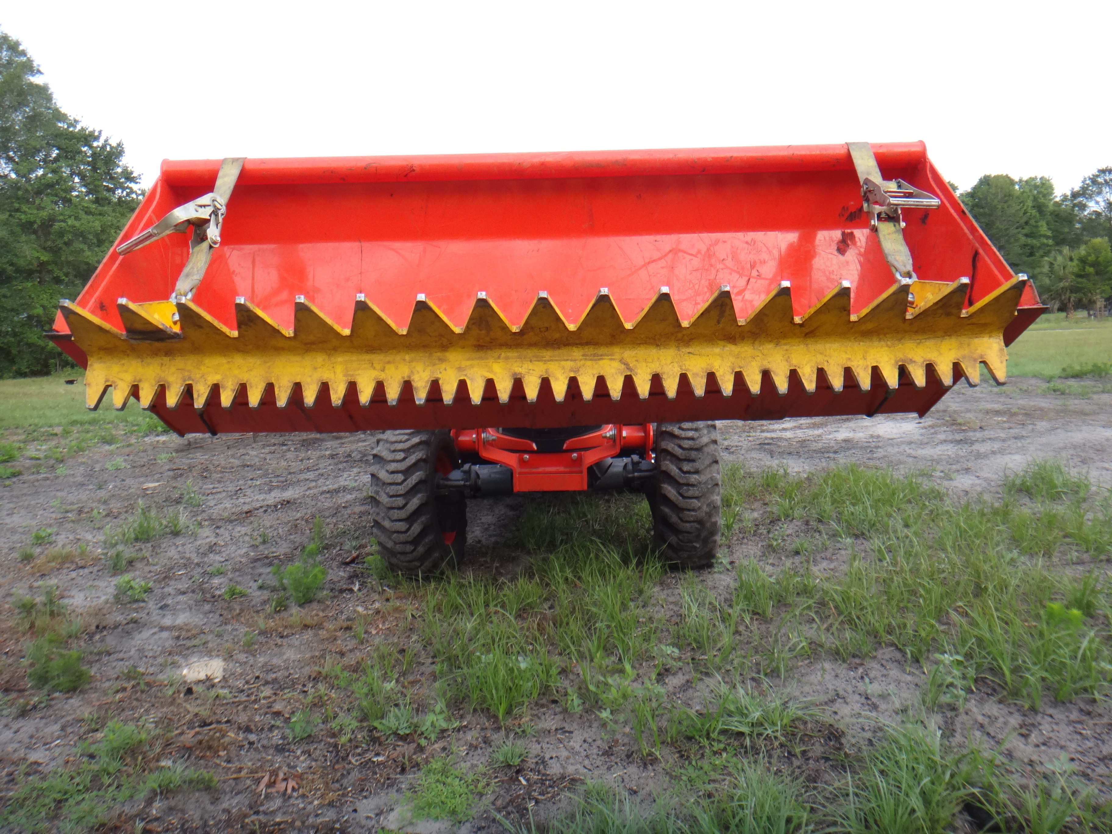

Most mulch fabric is weak after five to seven years. I have 15 year warranted Dupont mulch fabric, which an auger would go through after ten years. Most mulch fabric is warranted for three to five years.
I would trial punching through the fabric with the auger as first step.
If the fabric still needs to be removed I would use Box Blade scarifies to pull it up.
A versatile Ratchet Rake Bucket Attachment would work well too.

It's tough to get up and when I've done it, the best way has been with a bigger tractor (90hp) and a set of heavy chisel plow cultivators maybe 8' wide. The cultivators start to rip it up but it disintegrates even if in good shape. So, you'll need 3 or 4 strong guys to finish pulling it up. I've tried lots of ways and the above way worked the best. I figure a landscape rake would offer zero chance of getting any up but would just ride on the surface. A rototiller doesn't work either and the stuff just balls up in the tines and takes forever to get off. No thanks on that.
I would pass on that job or say you'll give it a shot for an hour and then decide if you want to continue. That landscape fabric comes up hard.
