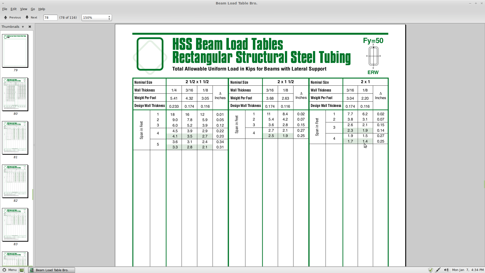

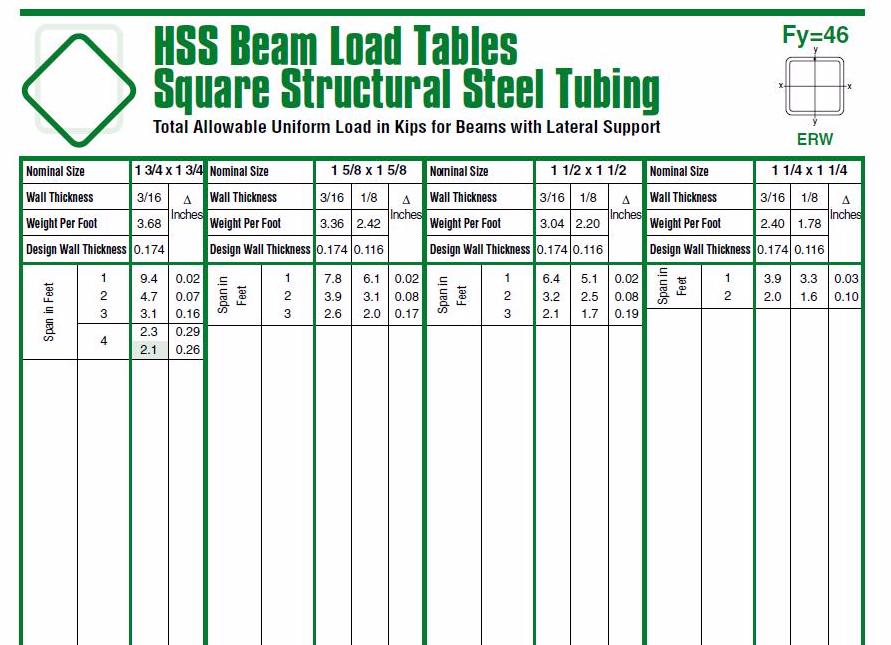

Very interesting to hear about pricing in different location. In my area square, and rectangular tubing is outrageous in price.:shocked:
If you do decide to go with tubing, may be these charts will help. The spans are awfully short tho.:confused:

I had to look up Kips....Not a trained engineer...but easy to understand versus other measurements of strength and easier to apply.
A trailer like a 5x10 would typically use 2x2x 14 or 11 gauge tubing or 2x3 x 14 gauge. This is what is used around here for short trailers. Larger ones step up to 2x4 or 2x5 rectangular tubing 11 or 14 gauge for up to 20 feet. Not seeing that on your chart...did I miss it?
I got a quote last week for a trailer I was going to use 2x2x20, 11 gauge tubing and it was 37.10. A 2x3x20 by 1/4" angle iron was 47.70. 2x4x24 x 11 gauge rectangular tubing was 66.53. A 2x6x20 x 11 gauge was 73.83. And 2x 4x20x 3/16 rectangular tubing was 78.61.
In general use, a trailer like this would either use 2x3 3/16" or 1/4" angle or 2x2 14 or 11 ga tubing. It's not so much the overall strength as it is the flex in the trailer. Angle iron is not good compared to the rigidity of the trailer. I had asked about the 2x2 angle for part of it, but was not much cheaper than the 2x3 angle.
