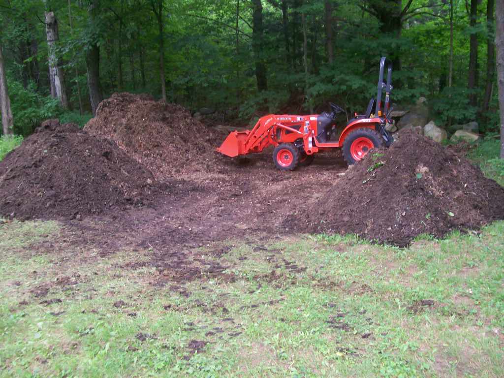

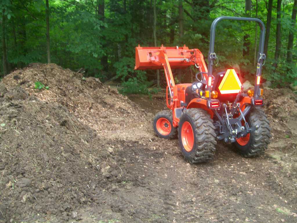

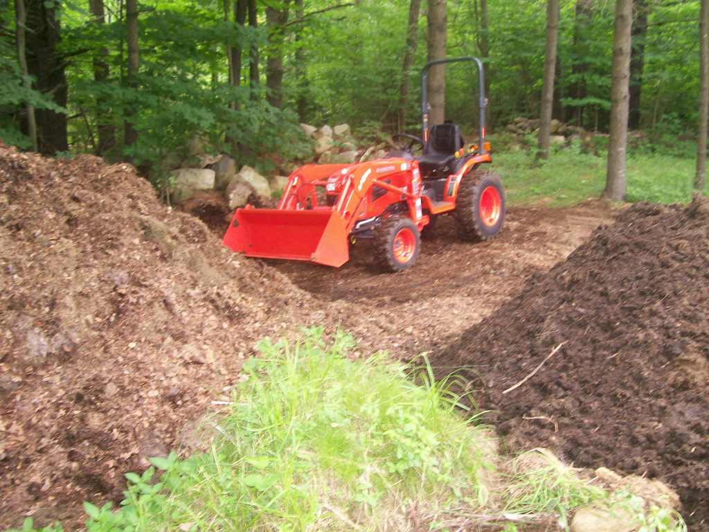

I like the same things, but I have taken to building the compost in it's own pile, and then moving it where I want with my loader, or the trailer.
I sure like that pine straw rake too! I'll have to go to Everything attachments, and check it out some more.

Looks like you have last years leaves composting in one pile then loam and another aged compost pile there. I do the same with an active pile and a composting one.
Every year I collect 20+ yards of leaves in Oct/Nov sprinkle with a little 10/10/10 and lime and turn every few weeks. By this time of year its great material for top dressing the yard mixed with a little loam.
Been looking for a small manure spreader to use to top dress - saw one on ebay and CL but didnt get it.. Now looking to build a spreader. I looked on line and seems $1000 is the asking price or more, and then old spreaders that are large are too big..
Have you or does anyone have ideas/built a compost spreader to evenly spread it out? The FEL drops clumps then need to rake in and its not uniform.
Carl
