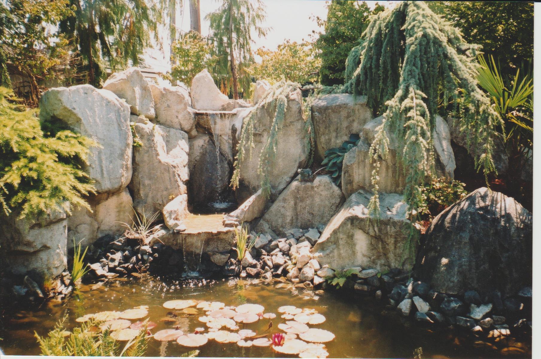

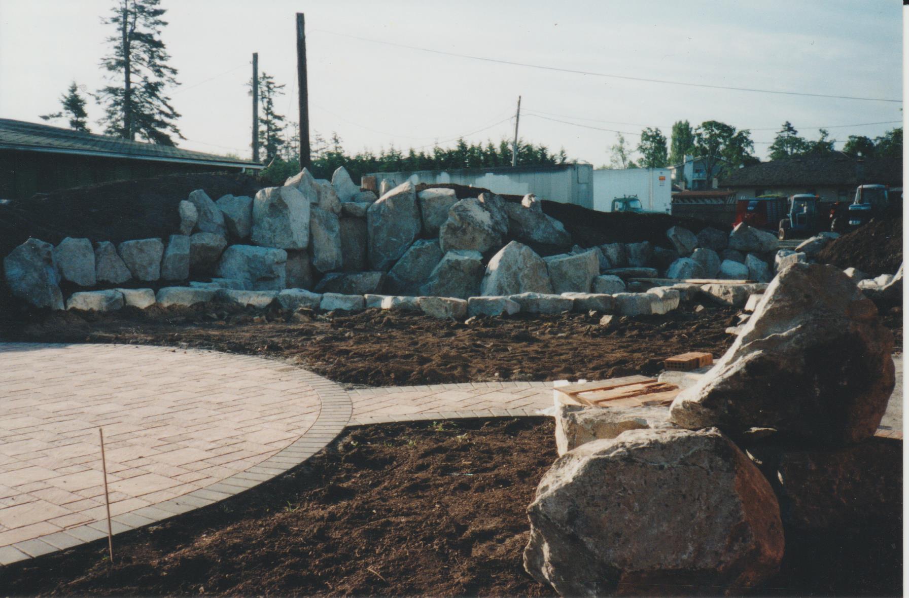

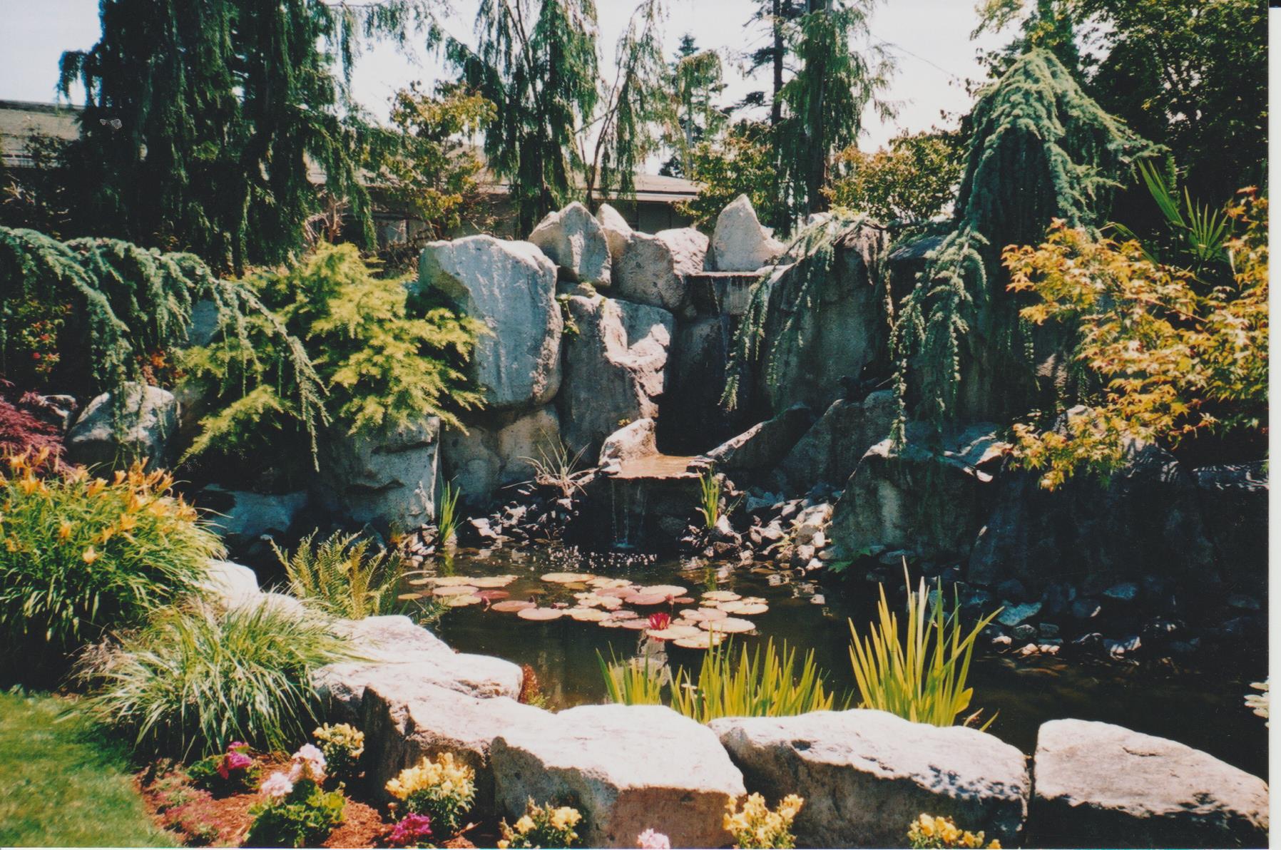

It hard to provide technical advice without a plan. When I built my house in 1994 I put in a pond and waterfall with a bridge that led to the path wandering through the garden to work. ( the farm maintenance yard behind my house.
Here are a few pics from that timeframe.
The first pic shows level elevation and the building of a berm to screen the farm buildings and equipment.

As you can see the water feature and berm were necessary to create my own views from the house and to segregate the workplace from home life.
