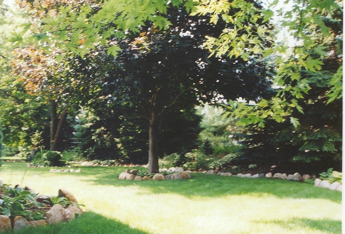

   / Landscaping Borders #6
I've been using field stone. It's free and looks good. Only issue is mowing next to it, but spraying roundup along the edge takes care of it for a summer

   / Landscaping Borders #7
Nice job YAK651. Looks like a park!
RS - can you give us some more information? How many feet of border? Sloping or level? surface smooth or rough?
