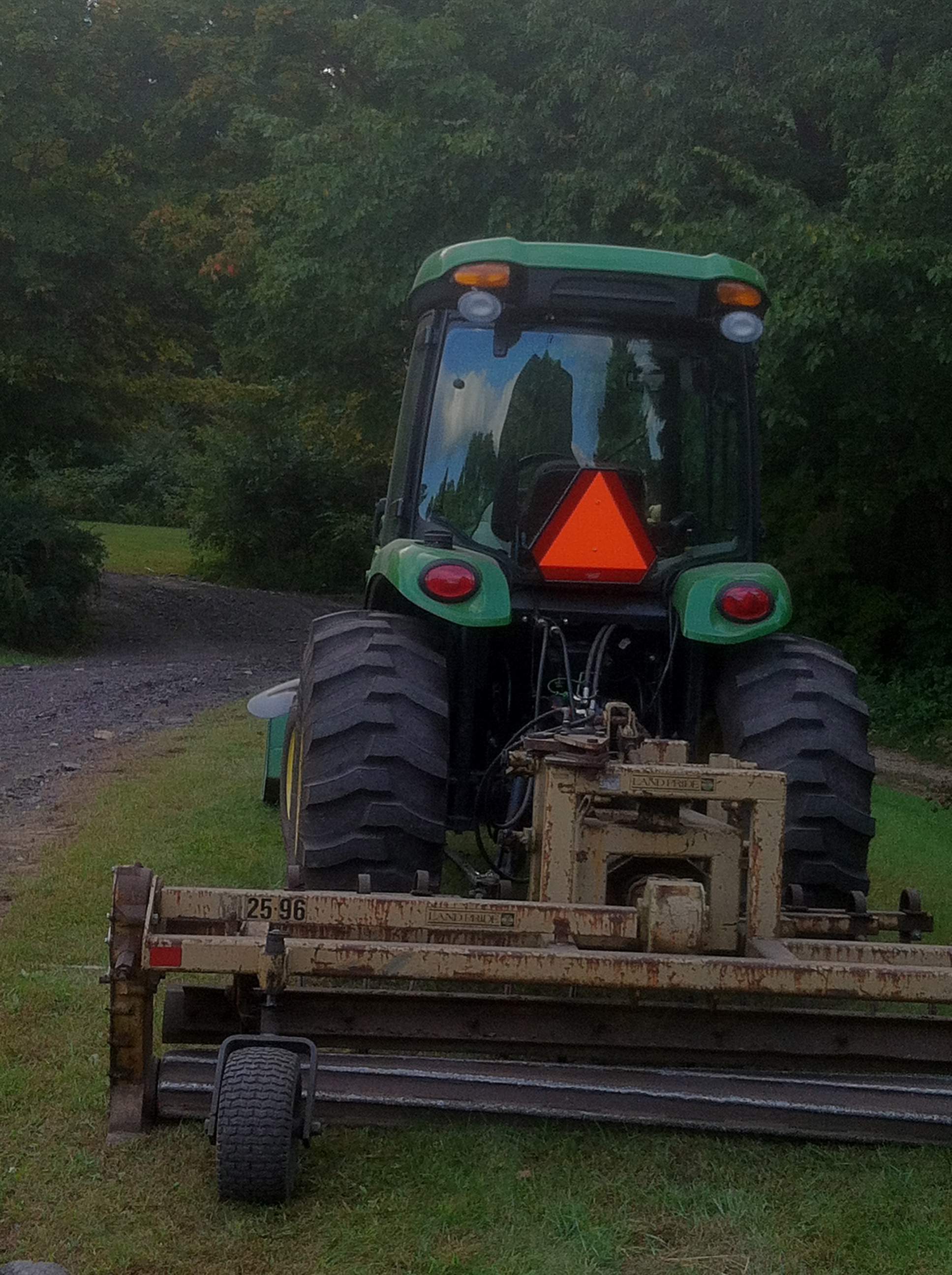

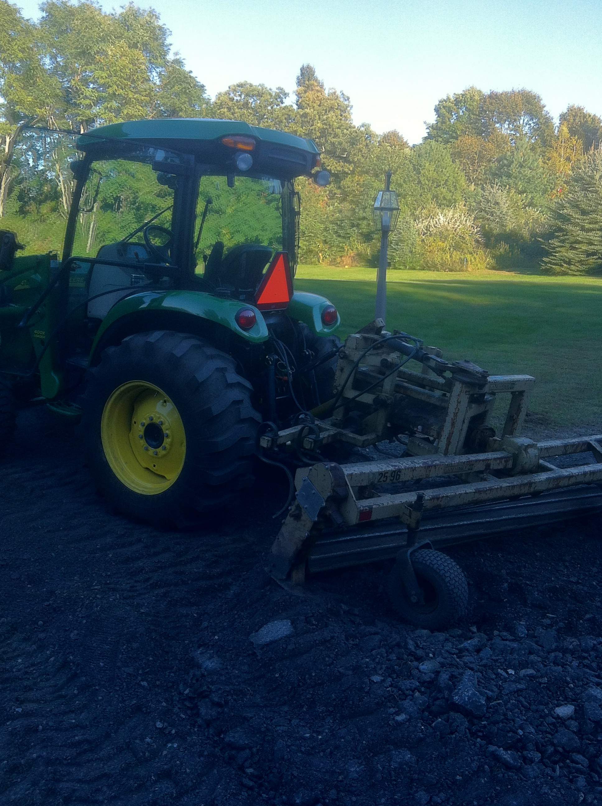

My two cents- As someone said-you are not building an Interstate. I think key is get the loam out first-and if it's nice stuff, that is worth money so that is not lost effort. 6"-8" of good bank run gravel or what is known here in New England as graded base-that is typically 3/4" crushed stone mixed with stone dust- no voids and it compacts well. A decent Vib roller is key- and if you can put your base down in two "lifts"-i.e. if 6" ,two at 3" etc.
And that could work as your final if funds are limited right now. I too am a big fan of asphalt millings. They were very reasonable until the state of Mass. changed asphalt specs and allowed plants to use as much as 30% millings in new mix. One big outfit near me won't sell it to you anymore-instead they willsell a 1/3 blend of millings, ground shingles,and ground concrete- makes a goodbase, but not a top surface. We do have another operator that will sell it but at 12 bucks a ton. On the plus side, they run it through a crusher and guarantee a 3/4" minus making it nice towork with. The stuff that comes righjt off the millig machine can contain some big "bones" that are a pain to deal with ifyou are trying to spread 2-3 inches.
I just did my 22 year old 500+ foot gravel driveway this fall and was lucky as a friend of mine who is a paving contractor had a good supply of millings that he gave me (I have a big IOU). I was also lucky enough tohave access to an 8' Landpride landscape rake and that did a great job. Also borrowed a small Vibe roller. Only negative, did not have enough good warm sun which really helps in the compaction. So late spring I will haul in a load or two of the 3/4 minus stuff and dress the top.
