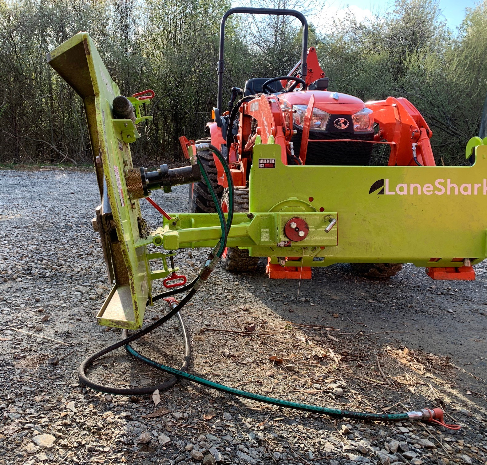

Also, @photoneffect - I googled "lane shark b2650" and found this - FS: 2017 Kubota B2650 with 299 hours (w/ loader, backhoe, 3rd function). In the Google cached version, it says you had a LS-3 and the tractor was plumbed for it. How did the Lane Shark work for you?
Thanks.
Yeah, I had the B2650 with an LS3. It worked great. Only reason I sold it is because I'm upgrading my tractor and the LS3 flow is too low for my new tractor. I'll be getting the LS2 with high flow motor to replace it.
The Lane Shark folks said the same thing about the B2650 being too small, but with the backhoe I had zero problems. I don't even have filled tires. If you want to go in the offset position you can swing your boom (still curled) over to the opposite side and it'll give you even more balance. But even before I thought to do that I never felt wobbly in the slightest as long as the backhoe was attached. The only limitation is that when you're raising the loader you'll hear the mower head slow down a tad. You end up getting into a rhythm where you raise the loader as you backup and then lower the loader as you go forward into the brush so it becomes a non-issue. For all I know this happens on the larger tractors too as a simple result of the loader and third function sharing a pump. And as an aside you're much more productive if you set the height of the Lane Shark to one level and then use your wheels as you mow. Lower the loader height a few feet and repeat. It's just better than constantly moving the loader up and down in one spot before you move on.
Only downside is because it's not an officially supported model you won't be able to buy the valve kit from Lane Shark with all the lines the correct length and fittings included. Your dealer should be able to figure it out or you could just get the version of the kit for the tractor that's closest to yours (maybe the L2501?). Might have to modify it or replace a line, but would get you the whips and the switch at least.
edit: By the way, that lean on the Lane Shark in the picture is by design. I thought it was a little odd too and this picture is actually from when I emailed them asking. The tractor sits level and stable.

@photoneffect - Thanks for all the info. I figured that between the backhoe itself, swinging the boom, and my loaded tires, I'd be fine, but the guy on the phone was pretty adamant. I still think I'd be fine, and since I'd be using this along the fence line with no obstructions on one side, I could even put the backhoe far out and down if I wanted to. I'm guessing that as their company has grown, they've had to stop separating a B2650 with a backhoe and loaded tires from a regular B2650 for liability reasons.
Three separate questions if you don't mind:
1. You were running the LS3 off your tractor pump, not a separate PTO pump? So 5ish GPM and the performance was fine?
2. Did you trim in the vertical position along any fence lines? One of the things I'm worried about is flinging stuff downward into my fence and breaking it. Sickle bar has a definite advantage there.
3. How did you plumb your unit? I'm thinking of running the outlet of my third function, which is power beyond, to a motor spool valve, with two returns to tank (one from the valve, one from the motor) and using the power beyond on the motor spool valve to power everything else that's currently downstream from my third function.

1. Yes, off the tractor. No issues other than the slow down when raising the loader.
2. Yes I used it on the vertical position frequently as I have over a mile of tree line. It doesn’t throw anything down. If you cut a branch and it falls on the fence I guess that would do it. Doubt you’d be cutting anything thick enough to do that, though, unless it’s a delicate fence.
3. You’re super overcomplicating it. You use your existing third function feed and then plumb a single return line from the LS to the sump. You have two whips from the LS to the existing third function feed coupler and then one to the dedicated return line coupler. The switch you buy from them will wire into the power beyond. There’s at least one install video from LS showing how to do it. The only annoying thing is they don’t provide a kit for the B2650. But all that means is they don’t have precut lines. You can get lines made and you’re good. If I were you I’d probably buy the kit for the L2501 or something and then hope the lengths are good. Will save you some time.
