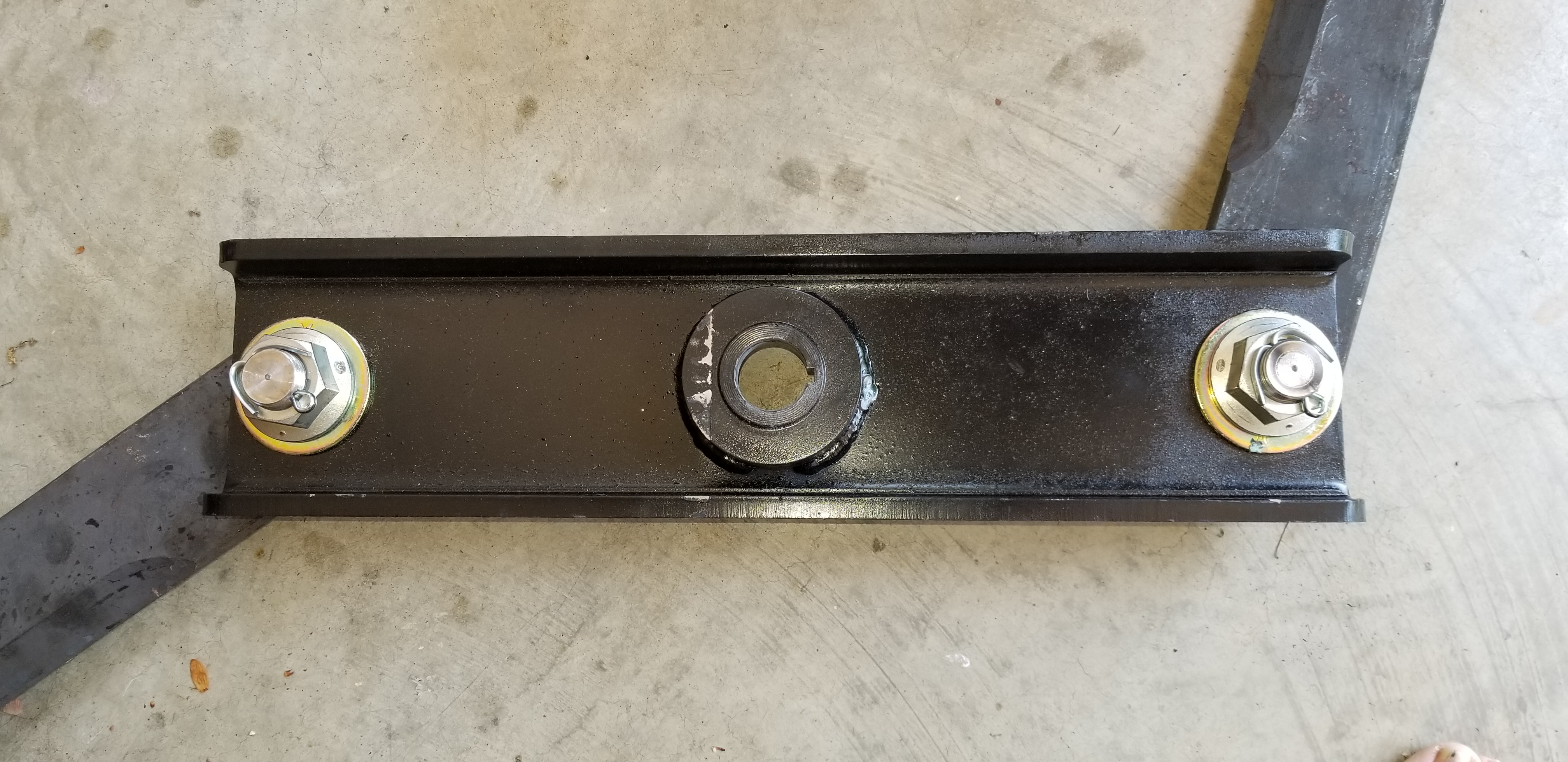

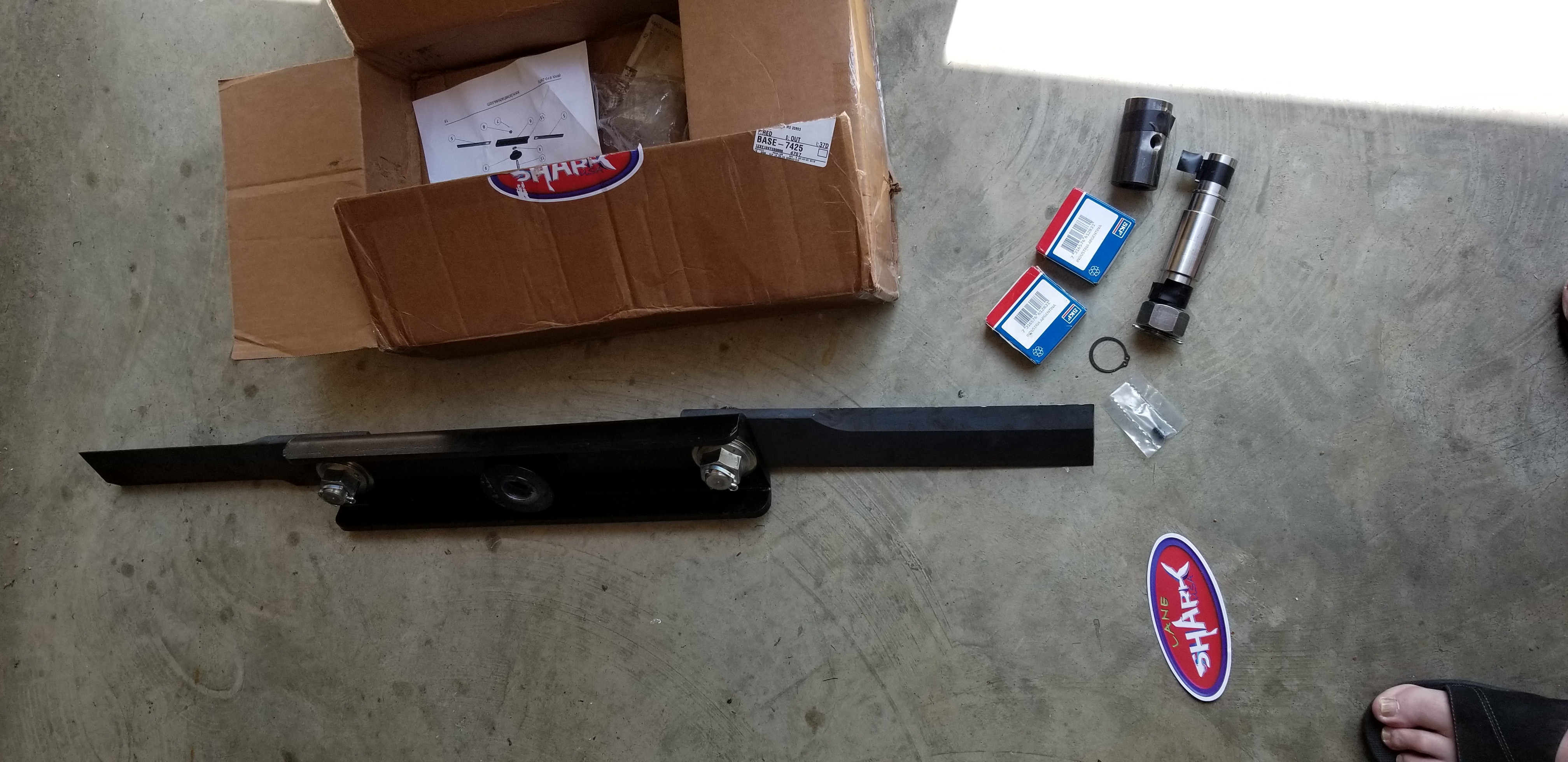

...because of the spring loaded blade tip guard and use of blade bolts that do NOT use lock-nuts.
Hope this helps!
The spring loaded blade tip guards are about the only thing on the Titan units that are not a knock-off plagiarism of the Lane Shark. The Lane Shark now has newer blade bolts and blade carriers (which they provided to me replacing the older design) and the new ones DO NOT use lock-nuts. They have shoulder bolts and cotter key nut retention.
