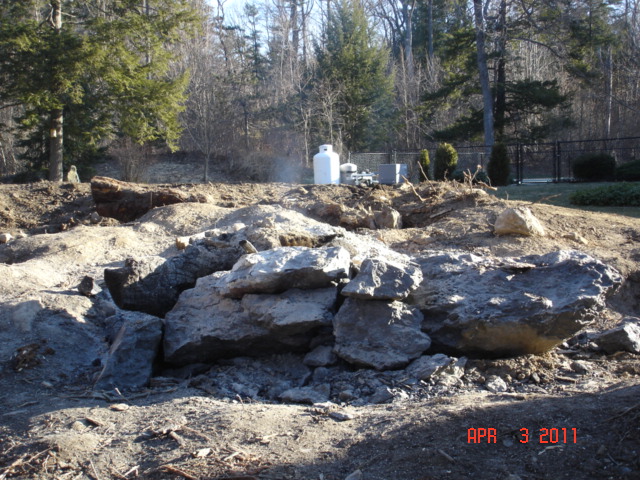

This was a long winter we never got a break from the snow, so no progress on the rock, untill today. I still can't believe how well this is working.:thumbsup:
If you have any plans on doing any stone work at all in the future (steps, firepits, benches), be careful how you break the rest of that up. Look for the lines in the stone and it will tell you how to cut it up into nice usable pieces. A hammer and chisel, some feathers &wedges or shims &wedges (they call them different things in different areas)will work nicely. A carbide chisel vs. a steel chisel works better.
Glad to see you are solving your problem using techniques devised many years ago that do not require power tools or explosives. There is a real nice video of a guy splitting stones on youtube with about a 5lb hammer and two to three chisels and a wedge. I am still trying to teach myself a craft that is dying here in the U.S. It is frustrating working a piece straight just to have it blow out towards one side at the end of it. Man I wish I had that thing in my yard. I see a lot of useful material there.
Most likely you just want it out of the way.
thanks for the pictures.
   / Large boulder must go
#68
I did save all flat faced rocks for future use, and this is the end rock is gone, total cost $0, plus lots of junk wood burnt up:)

I hate to be stupid but was it just the fires that broke up the rock? Did you spray water on it once it was hot to get it to break? What ever you did it seems to be very simple and easy on your back as opposed to the jack hammer that you started with. Congratulations.
Rick
#70
I didn't try the water, seems like heat worked good on limestone.
