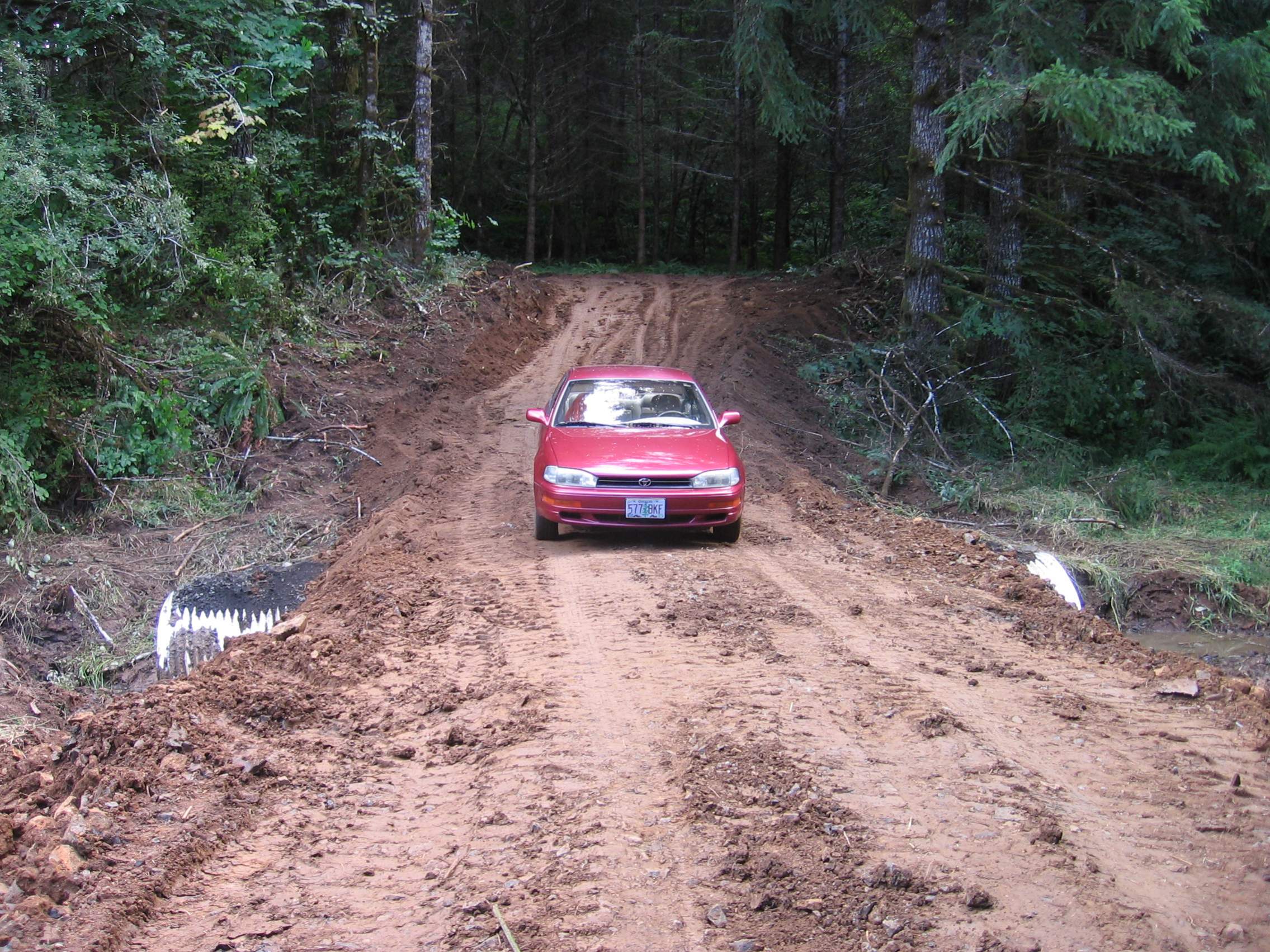

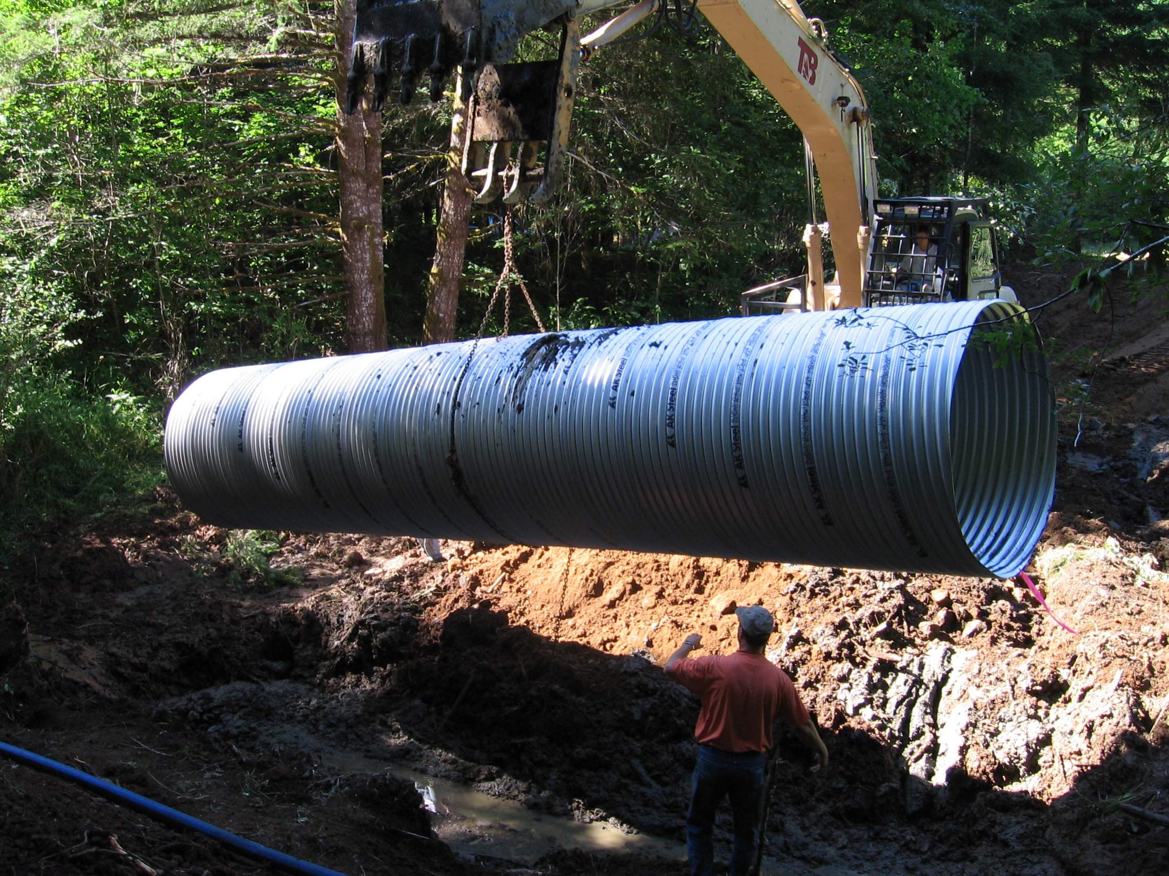

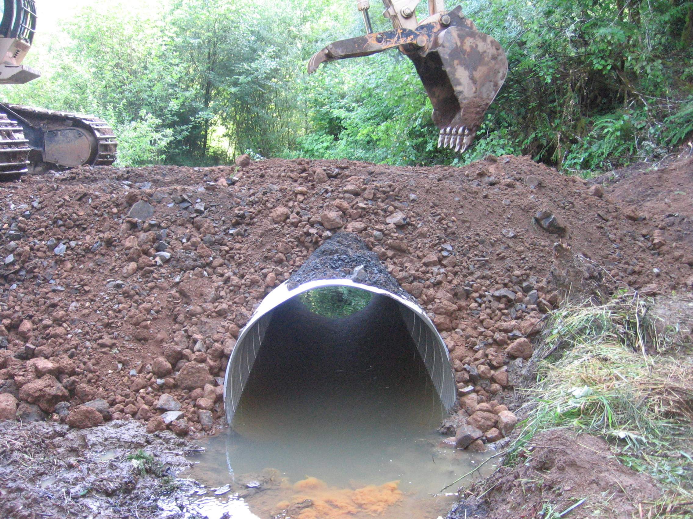

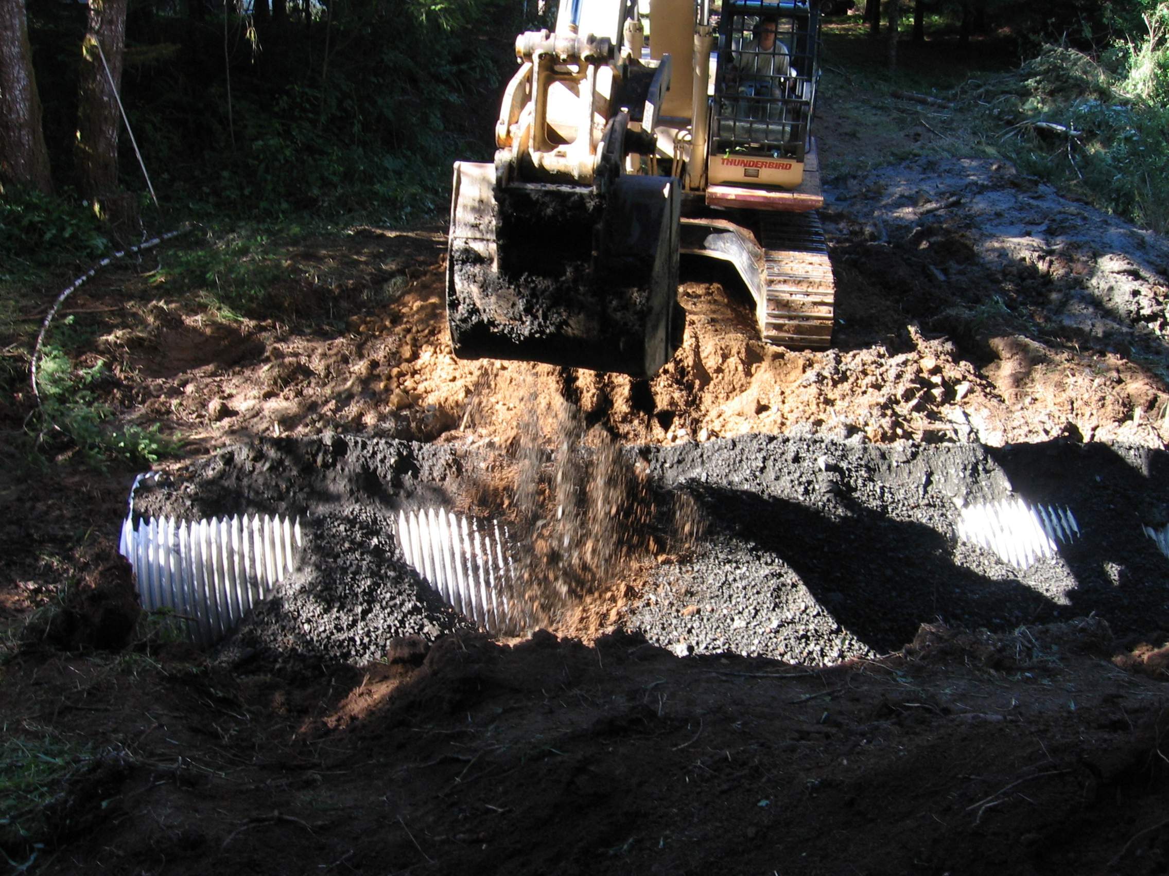

I contracted for a culvert placement to cross a small stream and gain access to property for timber management that I previously had to access across a neighbor's place. The result was a 66" diameter x 28' long culvert that was approved as "fish friendly" for fish passage. As this was timber property, the Oregon Forest Practices Act applied so the culvert had to be approved by the Oregon Department of Forestry (ODF). The ODF made the determination of size based upon the upstream watershed area, the kind and amount of excavation and fill needed, etc.) Total cost of the project was $6,300 (including aligning approaches, etc.). Cost of the culvert was about $1,300. I would really recommend seeking professional help regarding the size of the culvert and scope of the project based on the watershed, estimated 100 year flood potential, etc. Depending upon what is downstream (in my case, a county road with culverts, some yard and landscaped areas, etc.) the liability for a failed project can be significant.
