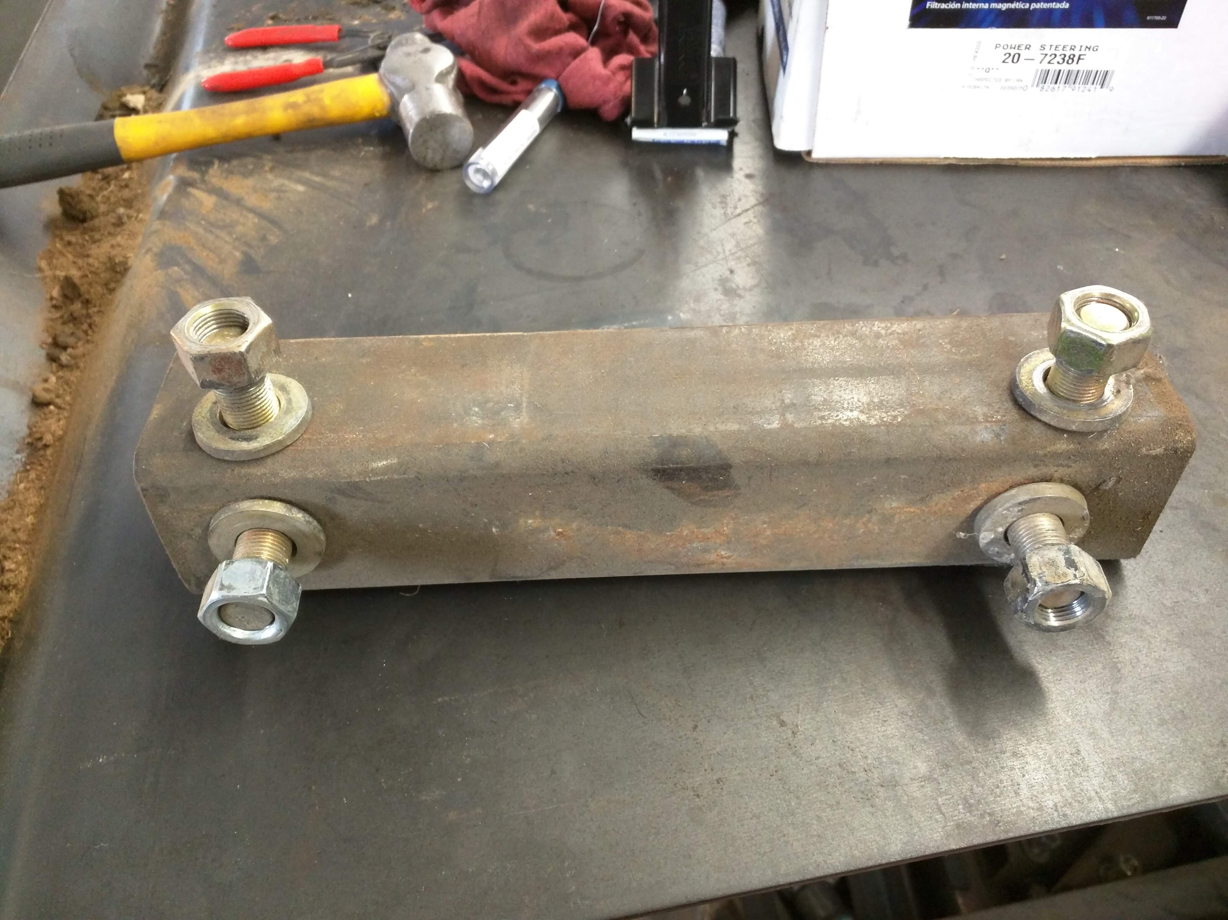

Sorry this took me so long, I couldn't find the blocks for a while. Pretty simple, 2.5 inch square tubing, 1/4 inch. I welded the bolts so I didn't have to mess with washers or backup wrench inside the tube. The torsion axles were originally bolted up into the frame, but also had flanges at 90 degrees. So I bolted these blocks in the original holes in the frame, then used the side flanges to secure the axle. It bothered me when I bought the trailer that the wheels weren't centered in the wells. The side flange holes were offset just enough to relocate the axles to cure this. Otherwise I would have taken the opportunity to do it myself by offsetting the bolts in these blocks.
Scott
Thanks for the picture and explanation.
Wayne
