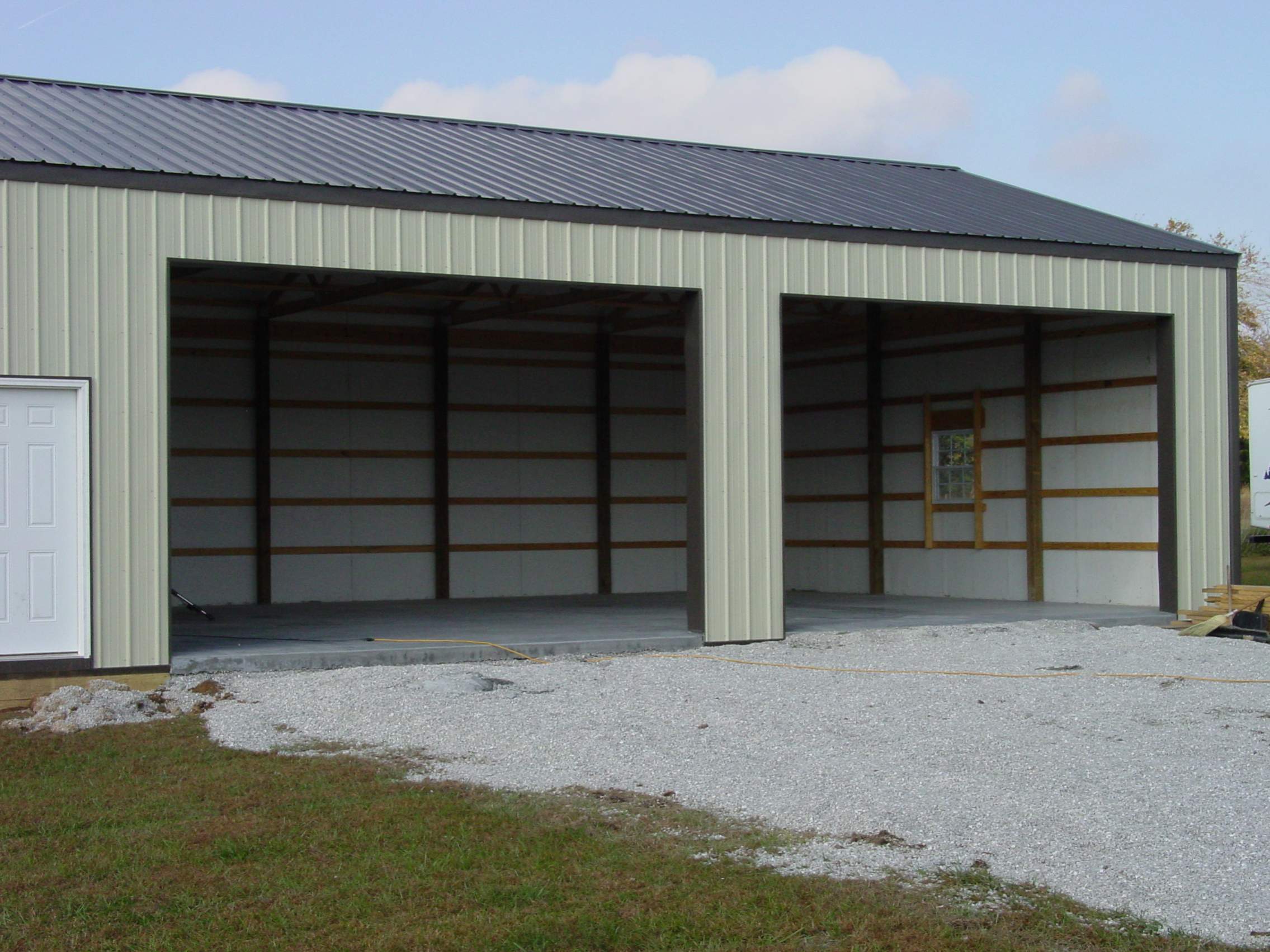

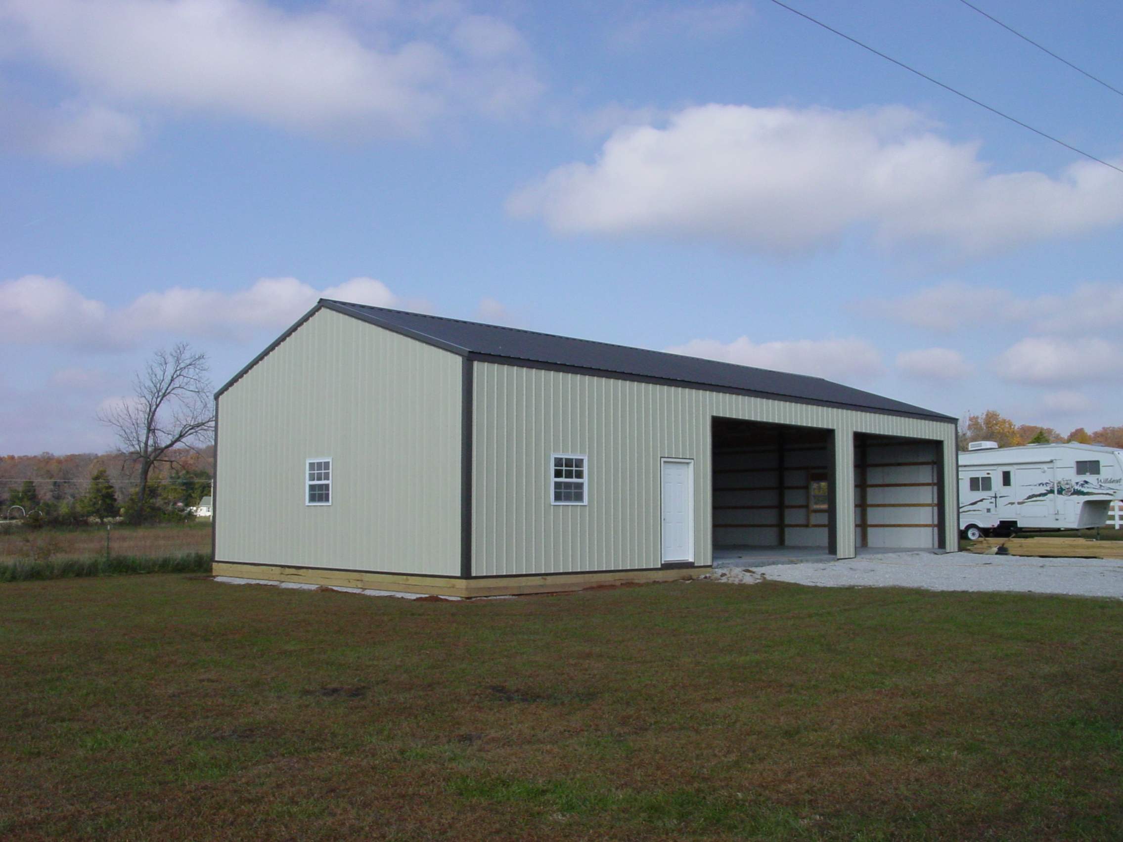

   / Large Garage Shop design and cost #13
I'd love to see the pictures, but the links don't work.
Sounds like a nice shop.
Well, lets try this again: 002.jpg
