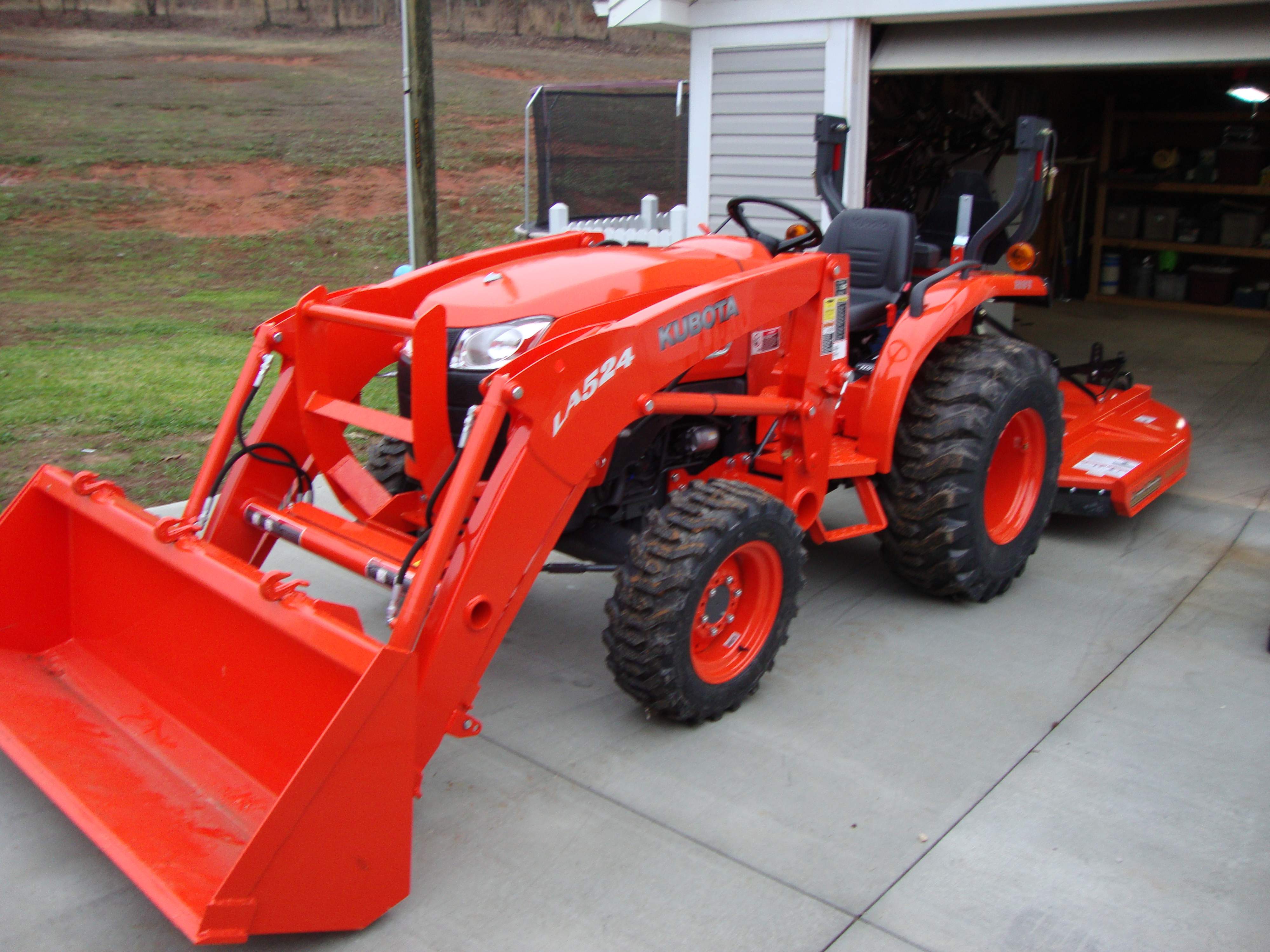

OK guys from what I've read from you all,, thinking I will keep my 60" plus buy me a 66" and forget the 72".... no longer than I've used the Tractor I can tell it will tip if you have a load and your front wheel drops in a low spot. Still thinking of getting spacers and make it 66" wide to match the loader I'm gonna add. Can't hurt being at least 6" wider.
   / Larger bucket #24
Tractorshopper just exactly what I wanted to hear. Thanks a bunch for the information. One other thing is your loader a LA524 with a 66" bucket?
Yes, that is the one.
This is a pic before toothbar and the 43 hours I've put on it since early Jan.

Moved dirt with the 3800 today, I'm thinking the 60" bucket piled high with dirt is all anyone should put on the loader cylinders. But I would love to have the 66" for the width just couldn't over load it like the 60"
