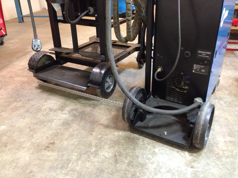

I agree. I would probably extend the axles or extend and add "duals".
image-121246464.png Terry
   / Largest Cylinder That Will Fit On Miller 350P #5
Here's a wheelbase comparison between one of my home made carts (on left) and my MM350P
Terry
