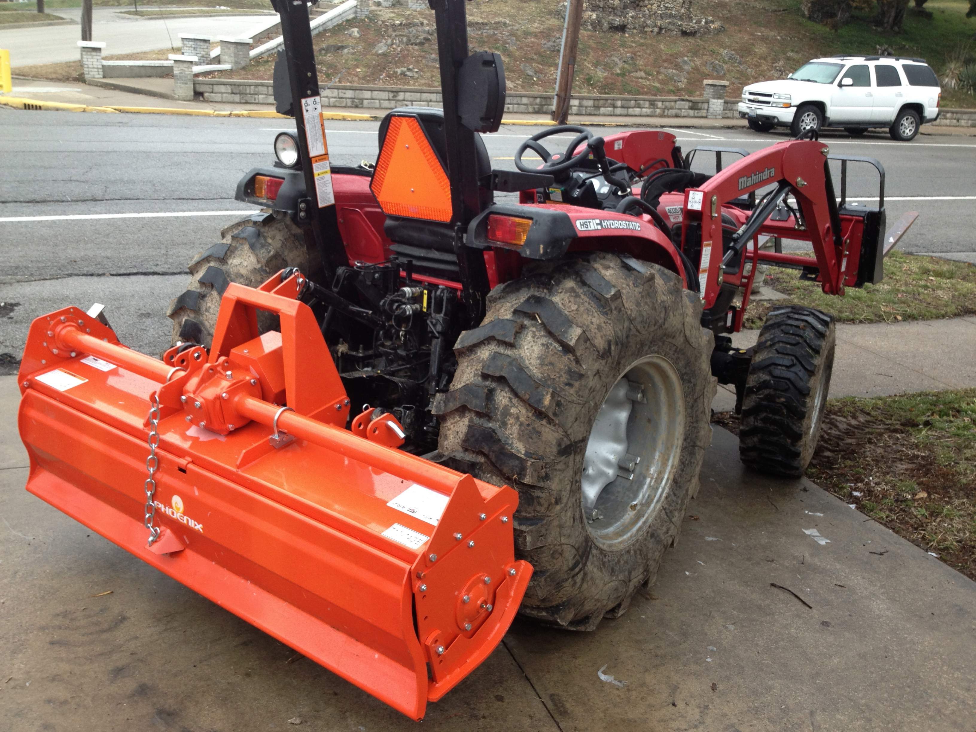

Well I just pulled the trigger on a Phoenix T10-GE Series Heavy Duty 74" Tractor. Hopefully it will come fast and I will have no problems.

Well - it was snowing, raining, blowing and just cold - but got it unloaded and attached - at least long enough to get it moved back out to the farm.
   / Largest tiller for a Mahindra 4035 HST??? #19
CONGRATS!!! Ok Action photos are now needed.....LOL!
