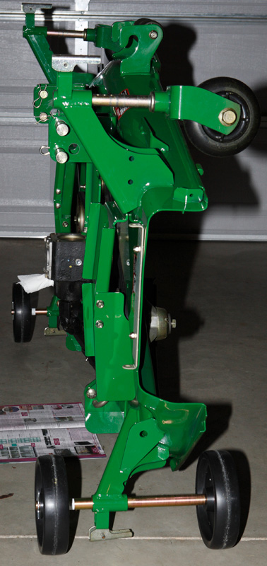

My 62D, purchased last spring, has no vent.
Incidentally, I've been collecting the pieces to make my own axle stands, including 7/8" and 5/8" steel round stock and four 8" steel wheels with hard rubber tires.
After looking at the "Larry's" axle stands, I can't figure out how the wheels are big enough. They don't look like they're even 8 inches and I figure that with 8" wheels, the gauge wheel adjusters will have only about 1/2" clearance to the ground.
Anyway, my design will be a 10" long piece of 7/8" round stock, with a 3 inch piece of 5/8" round stock welded on each end. Then, I'll cross-drill the 5/8" stock to pin the wheels on.
Hope it works, but if it doesn't, I won't have much invested.
While the attached pic doesn't illustrate the clearance well, there is plenty of clearance with the "Larry's" wheels. Since the adjusters are parallel to the axles, you would have to have a _/\_ shaped profile between the two wheels for the clearance to be an issue. I think you are more likely to get high centered going over something front to back than have issues with clearance between the axles.
<deleted text>
I used 8" wheels and the wheel height adjusters hit the floor at times.. I am thinking about getting some 10" wheels for it..
