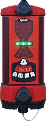

I may be missing something, but from a geometry standpoint, I don't think the receiver still needs to be plumb after you tilt the blade. Yeah, the laser line will intersect the receiver axis at the angle of blade tilt but the only point of interest is when the laser line passes thru the target point on receiver- where the two arrows touch. You'd still be able to distinguish that.
I don't have any experience with this, but from what I read on the Website, I think it needs to be plumb after the blade is tilted to the desired angle, then it will show "level" and "on grade", keeping the blade at the desired angle and on grade. But I have been wrong before.
The receiver shows on grade and tilt:
ES3073-Apache-Bullseye-5-Machine-Control-Laser-Receiver-with-Alkaline-Batteries-md.jpg
Product Information and Details
The Apache Bullseye 5+ Machine Control Laser Receiver has built-in blade tilt indication which helps the operator keep the blade level for increased production and accuracy.
Can be programmed to match an existing or known grade for slope matching operations.
Center On-grade provides an equal amount of grade information above and below on-grade. Use on dozers, graders, scrapers, and box blades.
Plumb indication built in for quick and accurate grade checking.
Offset On-grade provides more information above grade utilizing the entire receiver for productive excavation.
Three selectable accuracies for each on-grade location.
Up to six channels of grade information plus directional out of beam indicators.

Xfax - Here is the Bullseye 6 link http://www.engineersupply.com/Manuals-and-Help-Docs/Apache-Bullseye-6-Laser-Receiver-Manual.pdf. This one has "ACE" or angle compensation. It's $500 or so more than the 5+. From what I read I believe that it can be programmed to make up for off-plumb. I'm pretty sure that your swing plate idea will work just as well and be just a bit less expensive. :thumbsup:
After thinking about it a while I'm pretty sure that having the mast centered will aid in averaging the grade over the width of the blade.Offsetting the mast to the right for my tractor neck will only read that side of the blade. That's probably fine for swales, but not for flatwork, taking into account the slop in the 3-point linkage.
