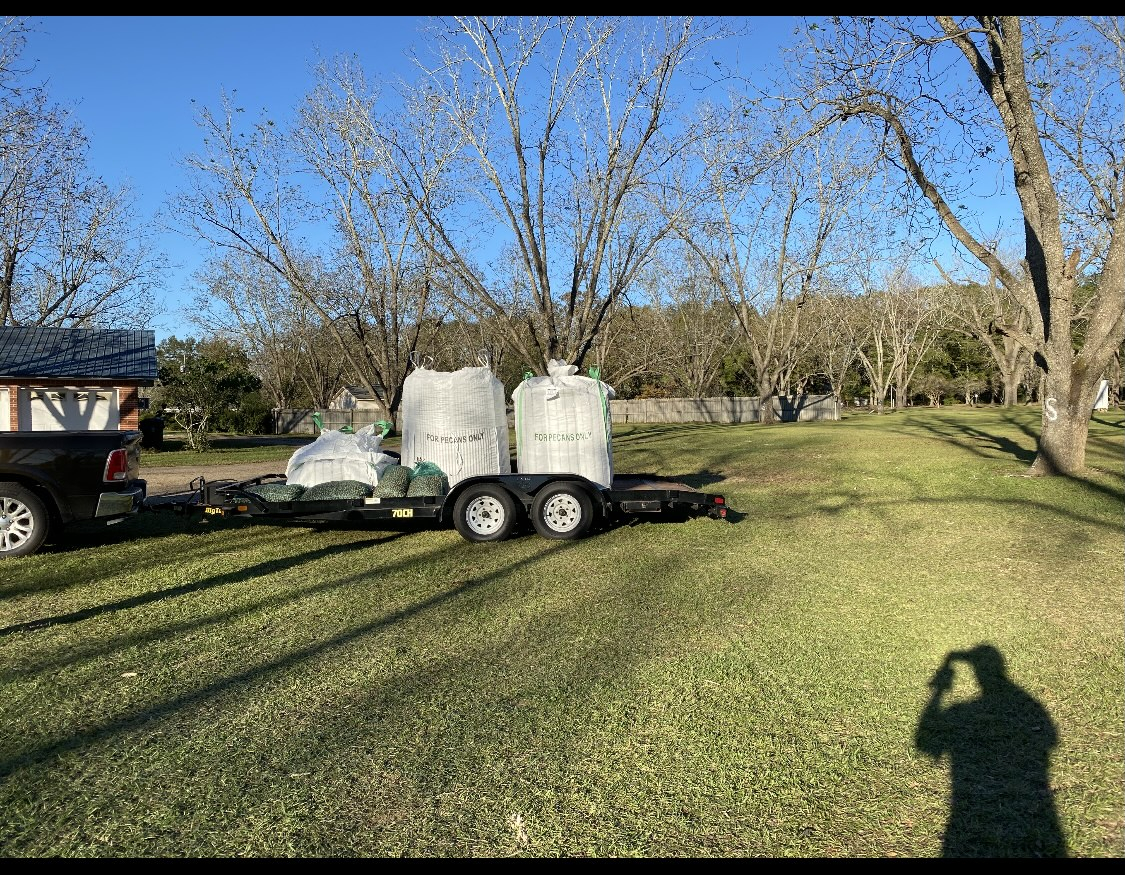

The wife and I are dead set on a HST tractor with a cab. We also intend on lifting pecan super sacks that weigh 2000-2500 lbs occasionally and will mainly use the tractor for mowing and tree line maintenance.
Is there any reason this tractor won’t do what I want and should I look at other brands/models with price being a consideration?

That’s kind of what I think/hope I’ll be able to do, lift them off the floor and be able to just move them using a pallet and possibly load them on a low height trailer.

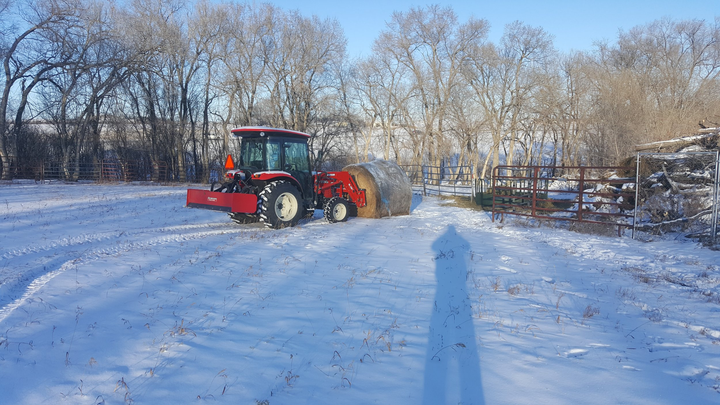

This is a 6' round bale from one of the times I fed my old neighbor's horses (the bale was pretty soft and mushy). It was ALL my tractor wanted. Picking it up was ok, but traversing through the snow across uneven ground was a bit "dicey". I'm guessing it at around 1600 lbs...:
A heavier 3pt attachment would have helped, but in winter I put my rotary mower away for the season and the box blade was what I had.

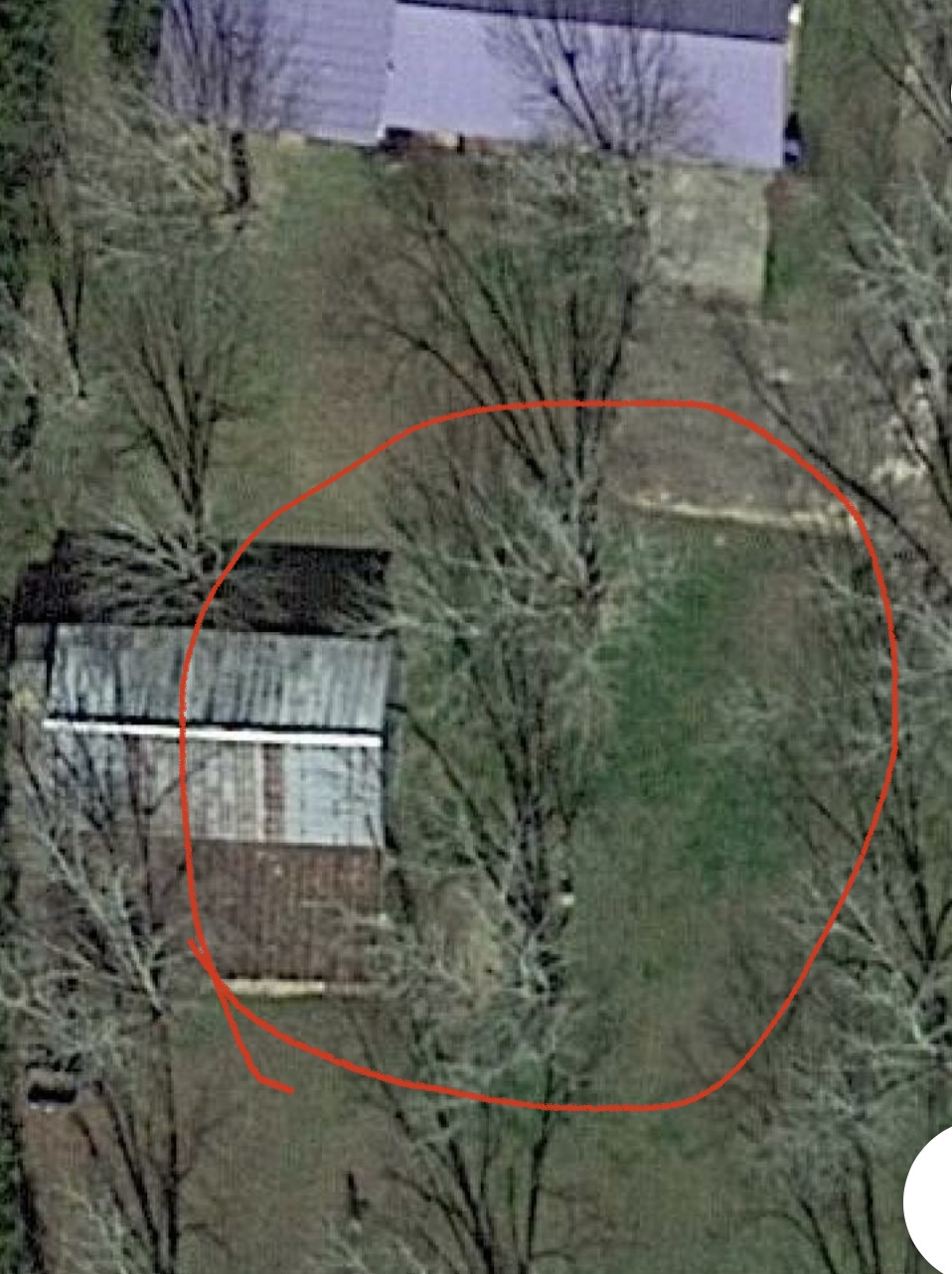

I only would be driving in the red circled area which is flat and in and out of the concrete barn.
Worst case is I pick the sacks up on pallets just high enough to drive them into the barn after sorting and use the hoist to load the trailer. Annoying but doable.

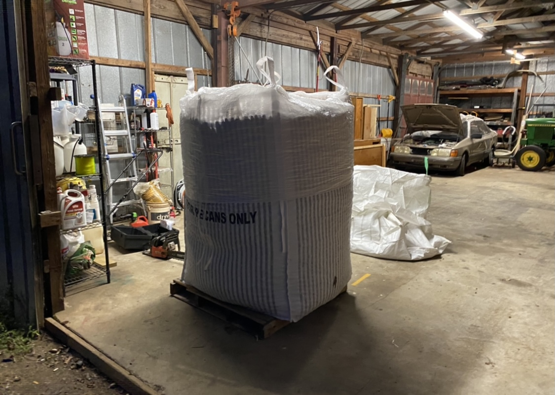

The yard/trailer in question
The inside of barn in question
   / Last chance-Talk me out of a HST cab 20 series #10
If you'd be lifting the sacks on pallets I think a 20 series would do it. Your terrain is probably not an issue. Last summer when we were under fire evacuation warning I moved my firewood totes to a space away from the barn. That was up a hill across mildly uneven terrain. I was in a hurry too. It went fine and I didn't feel like it was unsafe.
I think a 20 series might have a problem lifting the sacks from the loops on the top.
