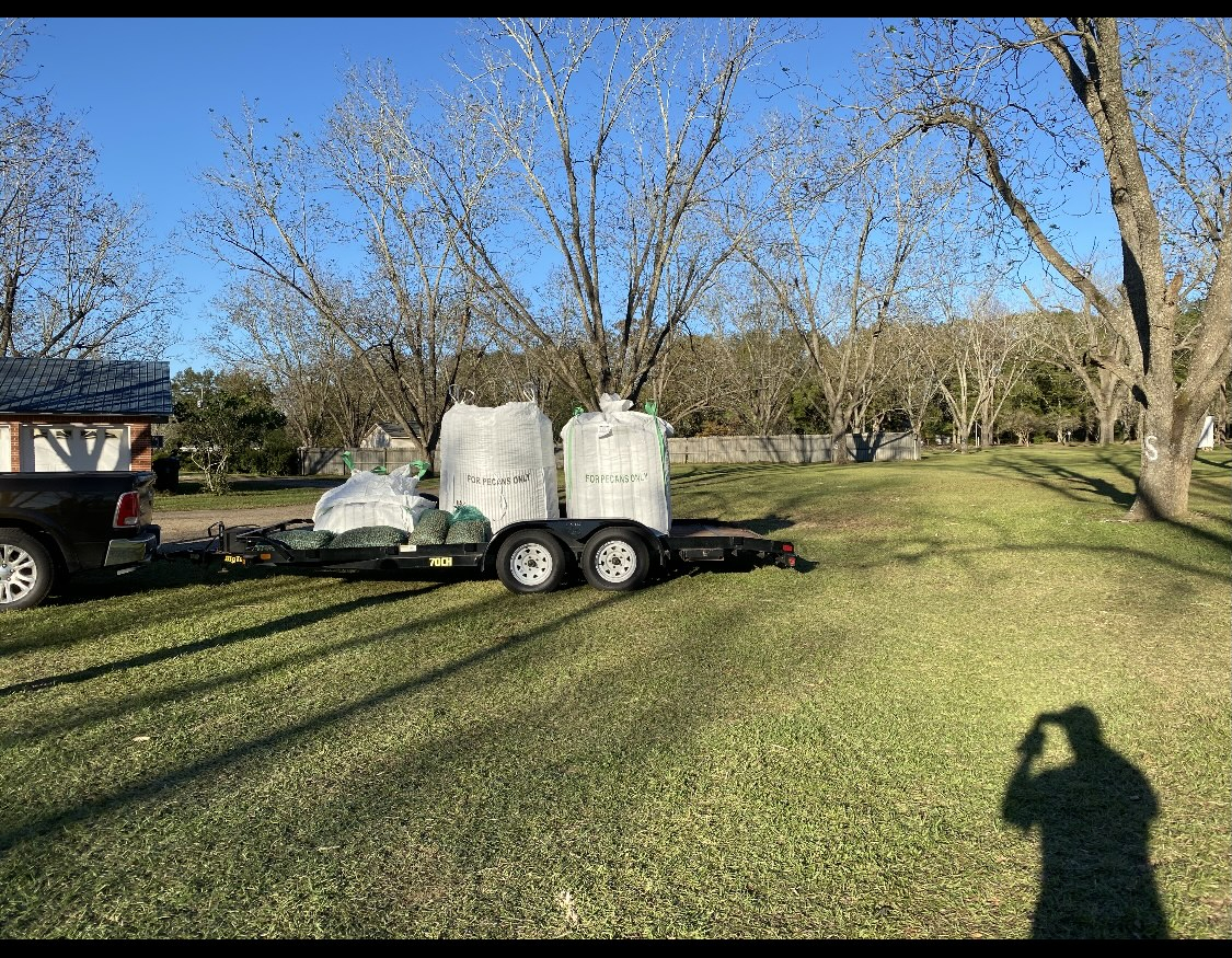

The yard/trailer in question

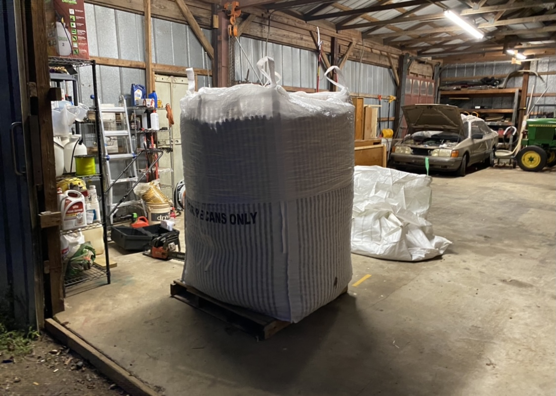

The inside of barn in question
That's a whole lot of nuts right there!
:LOL:
If you can lift them by the pallet and not sling them by the straps you may be ok. You can also check your hyd pressure to make sure it's up at max rated, sometimes they ship on the lower end of the rated range. Some guys bump them up a little too. I would absolutely fill your rear tires and put as heavy a 3pt weight on as you can find. My 3pt mower isn't that heavy, but it sits way back and the added leverage helps. If you're putting a 3pt weight box or concrete drum on it will be closer to the lift arms and you won't gain the benefit of the extended leverage. So what I'm saying is make it *heavy*, like 1500-2000 pounds.
