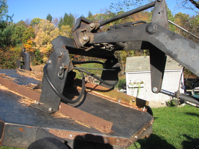

Notice how it has those two straps bolted on? They look like guides so that the unit can tilt side to side, but not flex the pivot joint fore and aft too much.
They replace the welded on stops and let them use a lighter weight pivot shaft, you think?

The limiters on the new QA/pivot do seem like a nice touch, though...

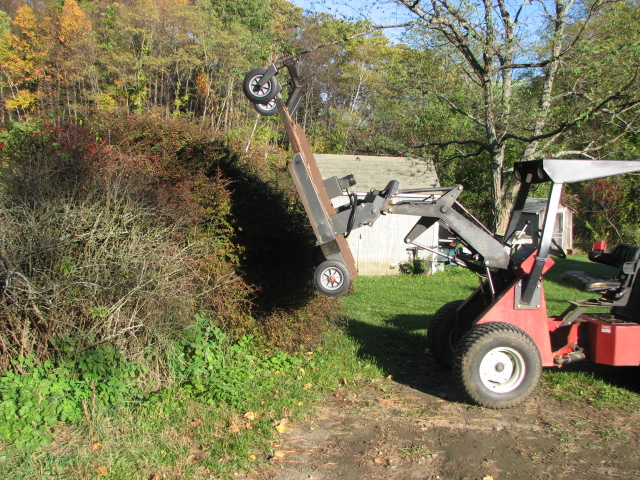

I have a new brush mower (mid-summer 07) for the 425. The possible angle of the tilt up and down mechanism makes it so you cannot tilt the deck up in the front. You can lift the whole deck straight up, BUT that's freaking scary, can't tilt/roll it 6" up in the front to hit larger brush at a angle, not so happy about that feature lack. A homemade removable stop will take care of that, but that seems like a pretty basic feature to lack in a brush mower. :confused:

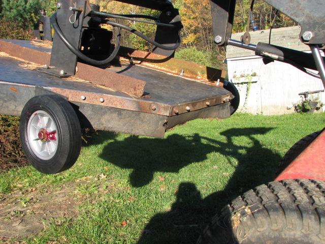

Is this tilted up enough? I think if you look at these pics and look at your brush hog, you will see how to lock it pretty easily to cut brush and unlock it for field mowing. The third shoot is of the rubber installed at the rear of the brush hog to make me feel safer and also keep most of the cut grass from coming back and getting caught inside the left front wheel.

I meant to say rubber skirt on rear of brush hog. Have to keep it clean around here.
