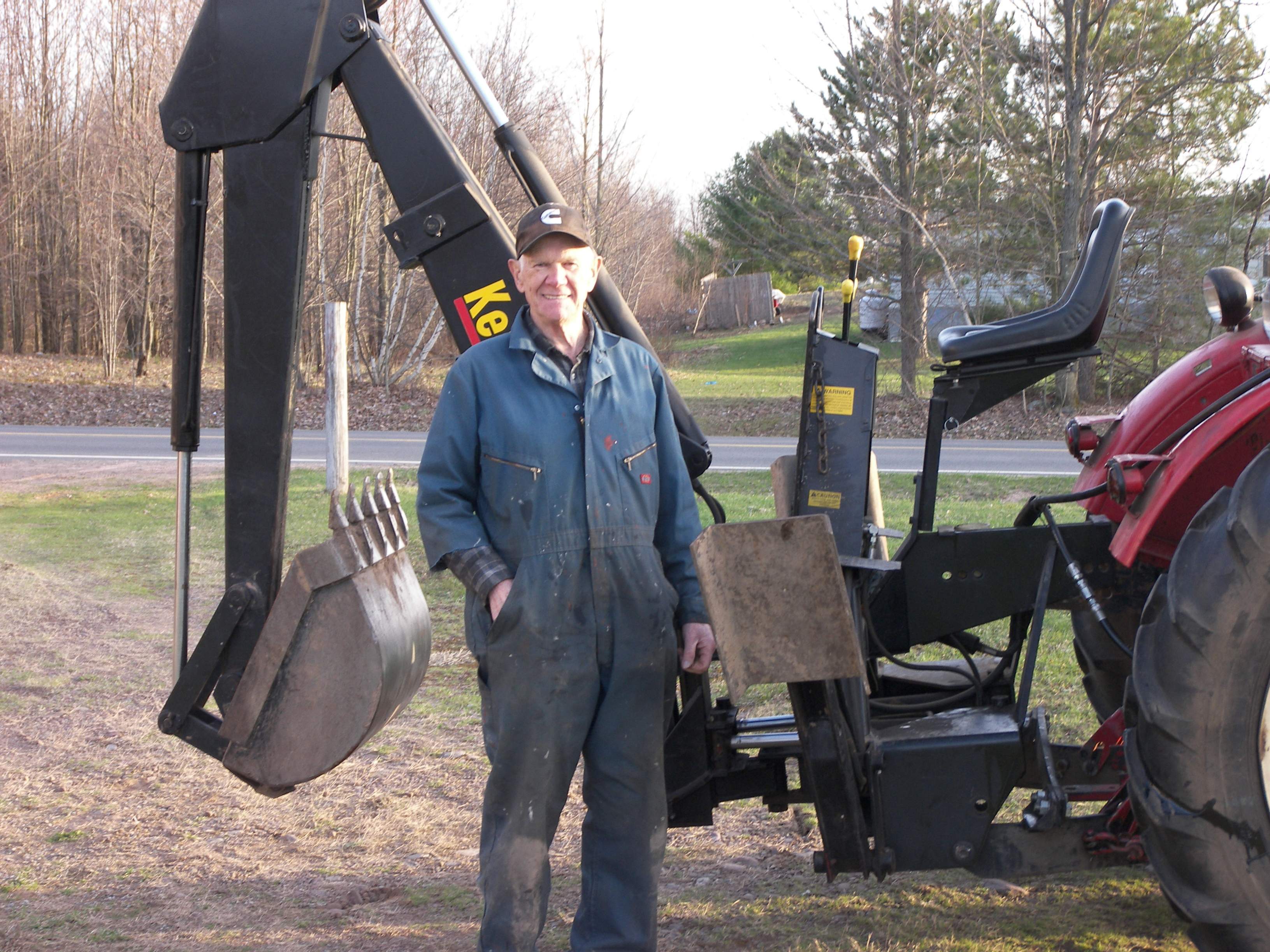

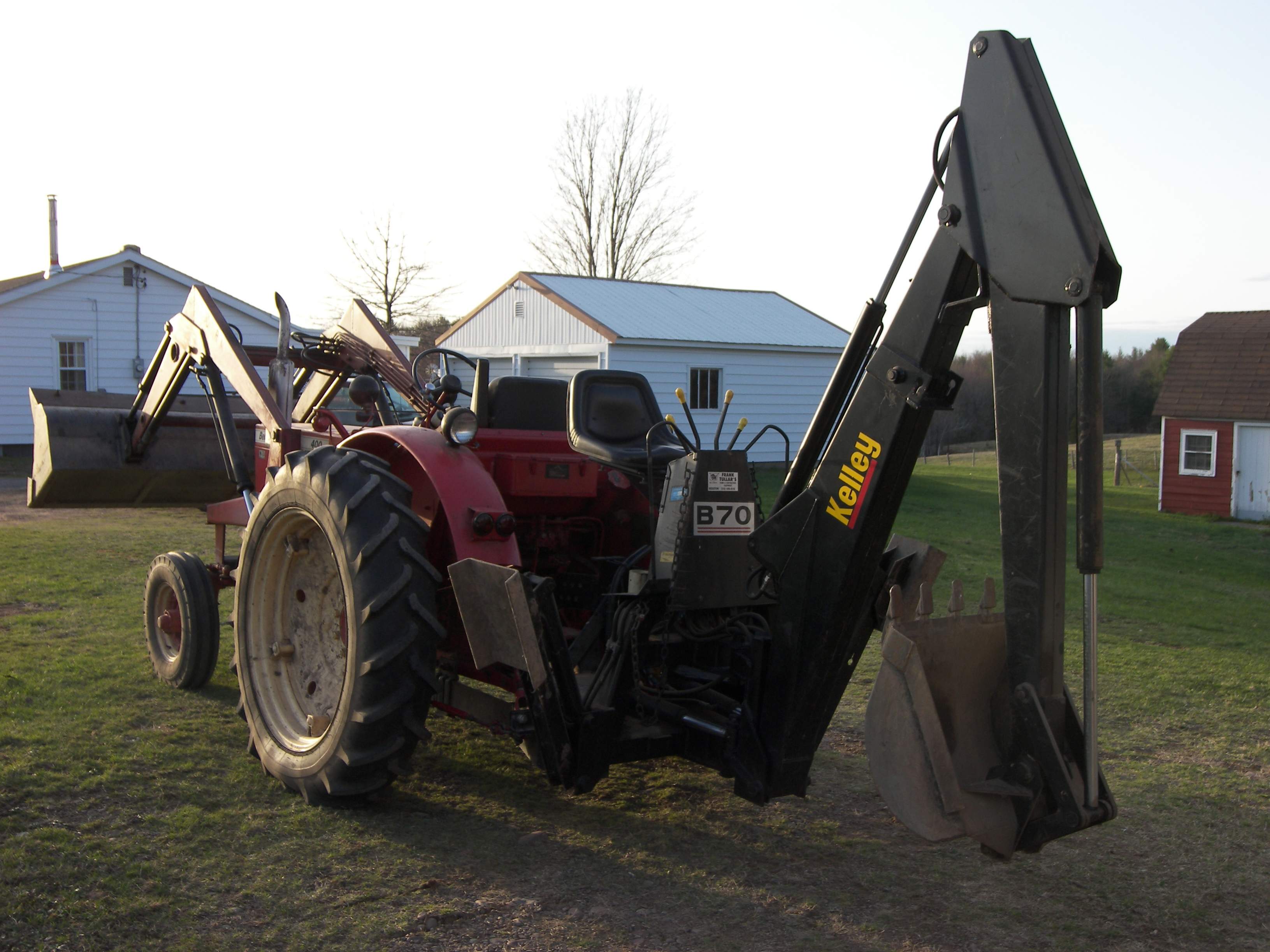

Well arsenix2001 the topic has went from snowblowers to poopsicles, so i guess the time has come. We must classify the Woods snow blower as an old "wringer washer" real agataing! Through this enperience it's been a great learning experience for me! Don't buy "Woods" Buddy i think you have lost the battle so take the washing machine and roll on. did i say "washing machine?" i meant blower, go home and wait for spring. When i got it home i would lube the "bejeepers" out of the chain and then run it till there isnt anything left of it! Thats what i do with mine. Don't feel like the "Bad Guy" here, i've been there many a time years ago. I bought a Belarus tractor and loved it! then i bought a Kelley B70 BH. my tractor dealer put the BH on the tractor and made the mistake of stating it would dig like a comercial machine. He put it in the contract. To make a long story short, (long story over 4 months long now) well the dealer replaced the tractors Hydro pump 12 times at a cost of 500$ a pop! after the 2nd pump he said he was done! My problem . . .WRONG, WRONG, . . WRONG thing to say! The problem actually resulted from an error on the mechanics part that cost the dealer 6000$. i WAS REAL PI**ED OFF, went to the dealer and set down with the mechanic and replumbed it the way i wanted it done in the first place and guess what? it run over 1000 hours trouble free before i sold it. I got no bills from this nor did i pay the trucking to or from even though i was threatened with a law suit. It took a couple of years for the dealer and i to become friends again but "WORD OF MOUTH CAN BE YOUR BEST FRIEND " in dealing with BIG COMPANIES! Your probably not going to win, but Tell everyone of your experience with woods which you have done, Word of mouth travels FAST! hold your head high, and use this as a learning experience. Sorry friend . . .John
Pics of my dad and the Belarus BH
