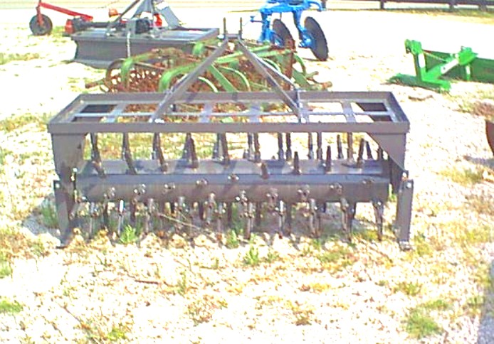

We stock the 5 ft "Tarter" core aerator at $1195 for 3 point and customers rave about the good job they do and how well they are engineered. Ken Sweet

Actually, you can turn corners with a 3 PH aerator if it is built correctly.
By "built correctly" the tine wheels are individually mounted on the axle or in pairs and rotate independently of the others. I have a couple of them and they make turns just fine. One is similar to the model sold by Sweet.
The pull behind ones with the tine wheels all permanently mounted to the axle really tear up a lawn on turns.
