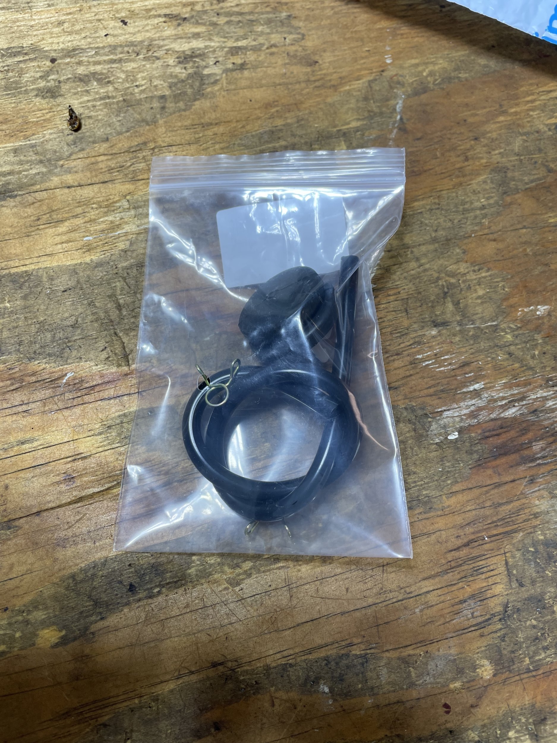

Success. I ordered a new primer setup, included a new primer bulb, the base and the primer hose. What should have taken 45 minutes took more like two and a half hours. The first attempt I’m guessing the primer hose didn’t get attached well, one of the screws holding the carb on is in the way. The second attempt I took the carb off, all the linkage fell off and I had to watch a YouTube video on how it went. That failed also as I discovered a gasket laying on the mower deck after pulling the start cord 20 times.
The third attempt was a success. I had my wife help me as getting the carb on with two gaskets and a metal plate (heat shield) in between the carb and engine is like trying to push a rope. It started on the first pull. I’m still not sure what was wrong in the first place but something with the primer, it’s base or the hose. Total cost was $7.55 from Amazon.
The next time you need to replace a gasket and it is difficult to hold in place, put a little heavy grease on it, the grease will hold it in place while you get the carb mounted.
