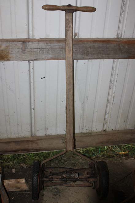

How about this for a winter(?) time project? We have a grasshopper 618 with the Kohler triad engine, it finally did what all those engines do after too many hours with plugged cooling fins, dropped the cylinder sleeve. Also after 1500 hours and 16 years, the hydros were getting very weak. So we had to take a look at all the options for lawn mowing.
Option 1: Set younger brother loose with this thing :laughing::p
Option 2: Buy a new mower,,,,, OK, go check prices on a good commercial front-mount (we have lots of low-hanging apple trees to mow around) :eek::eek::eek:
