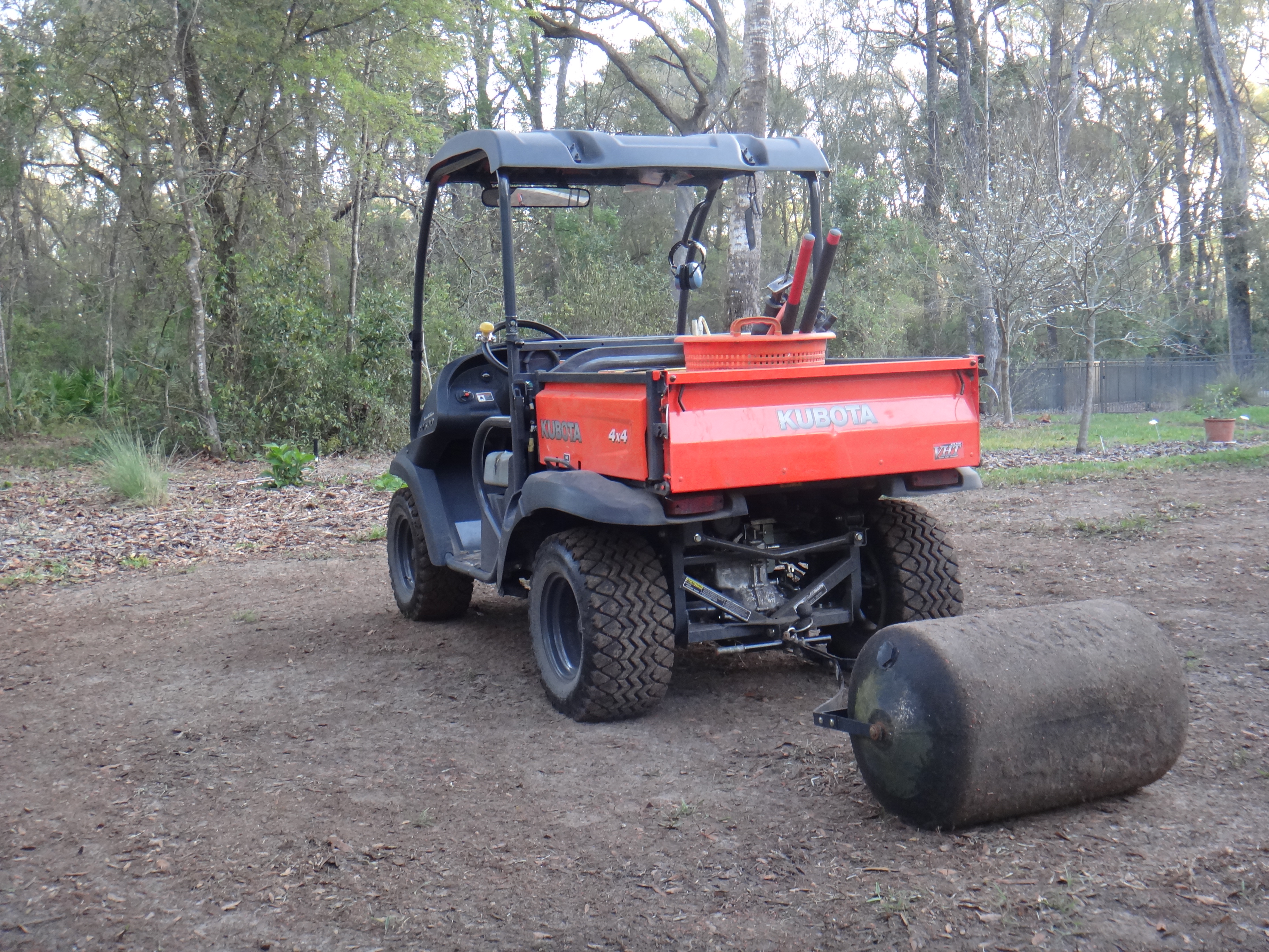

I pull a water filled TSC poly lawn roller behind my 15.8 horsepower Kubota RTV500. I use the UTV tire width as part of the packing area.
You will find a lawn roller will flatten about 1" - 2" irregularities, not more. The soil needs to be WET.
