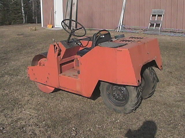

Hers's mine all hydro, air cooled 23HP Kohler twin, 1 1/2 ton & has vibratory on the 36" drum. It really packs down loose moist gravel & does not get stuck on lawns like the drum drive units. Have not noticed any lawn damage.
