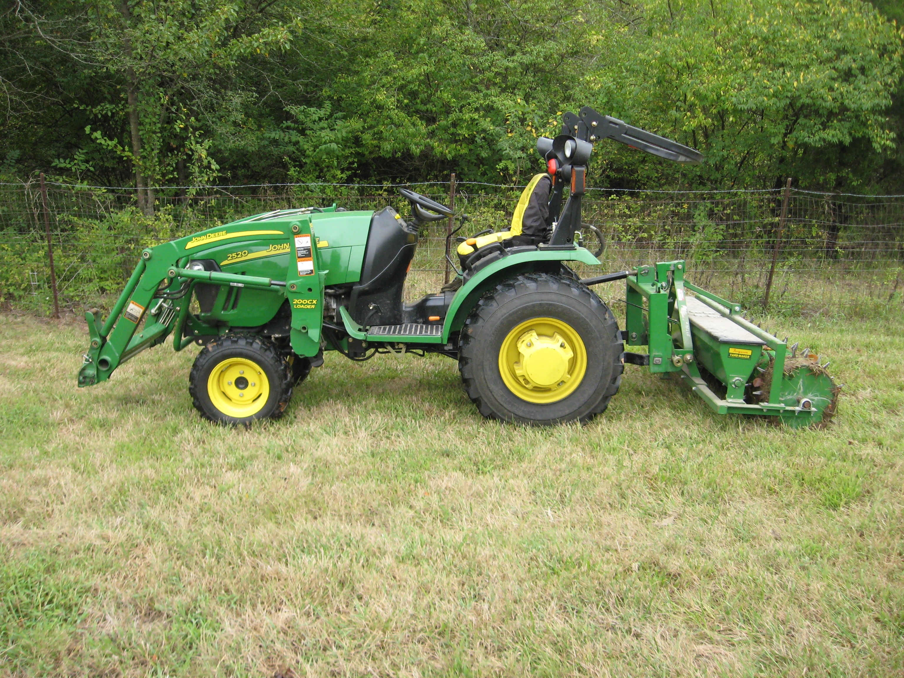

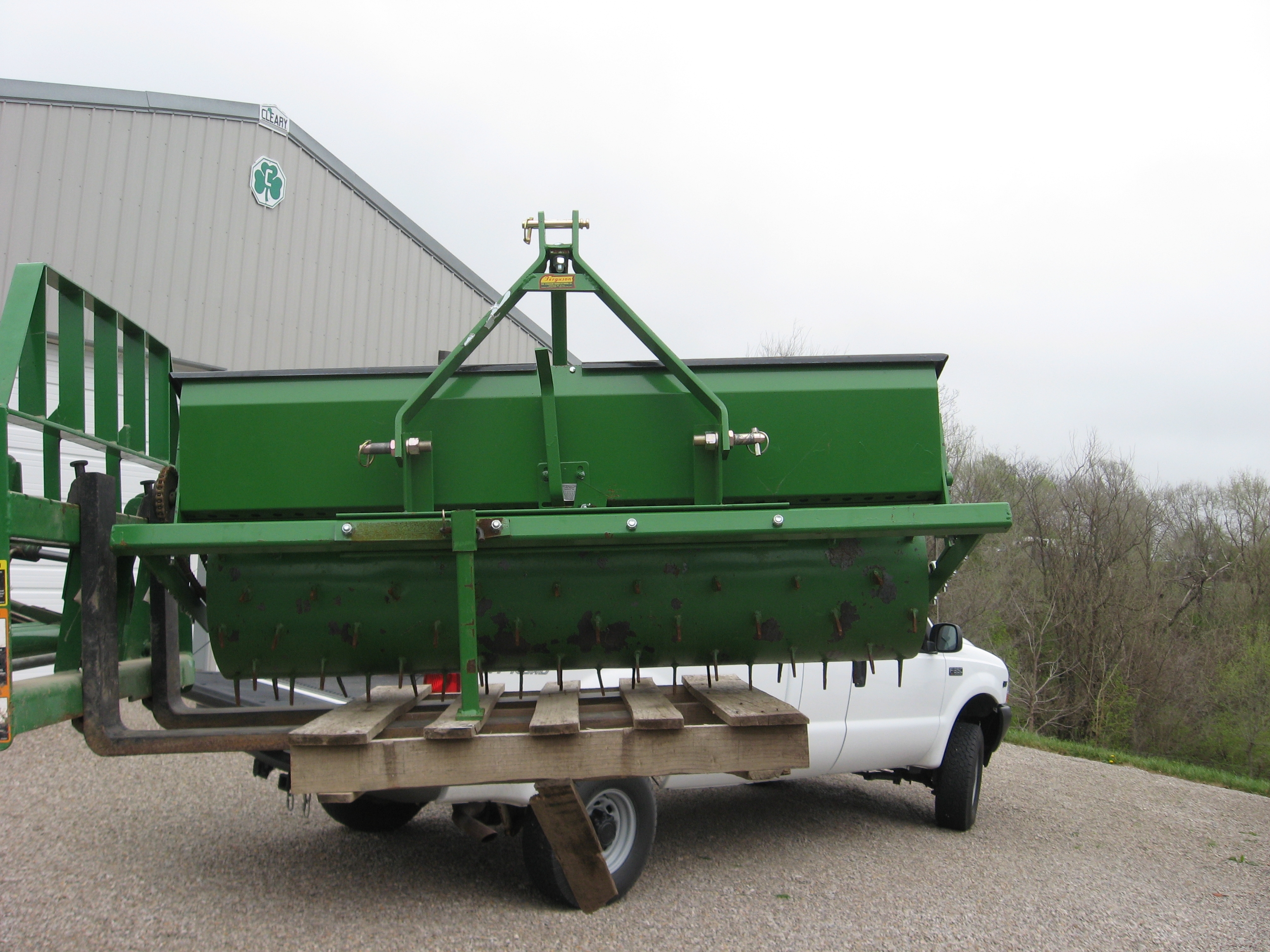

I use a Ferguson Yard Maker for overseeding every year.
Not as good as a slit-seeder, but cheaper and works if you do it right.

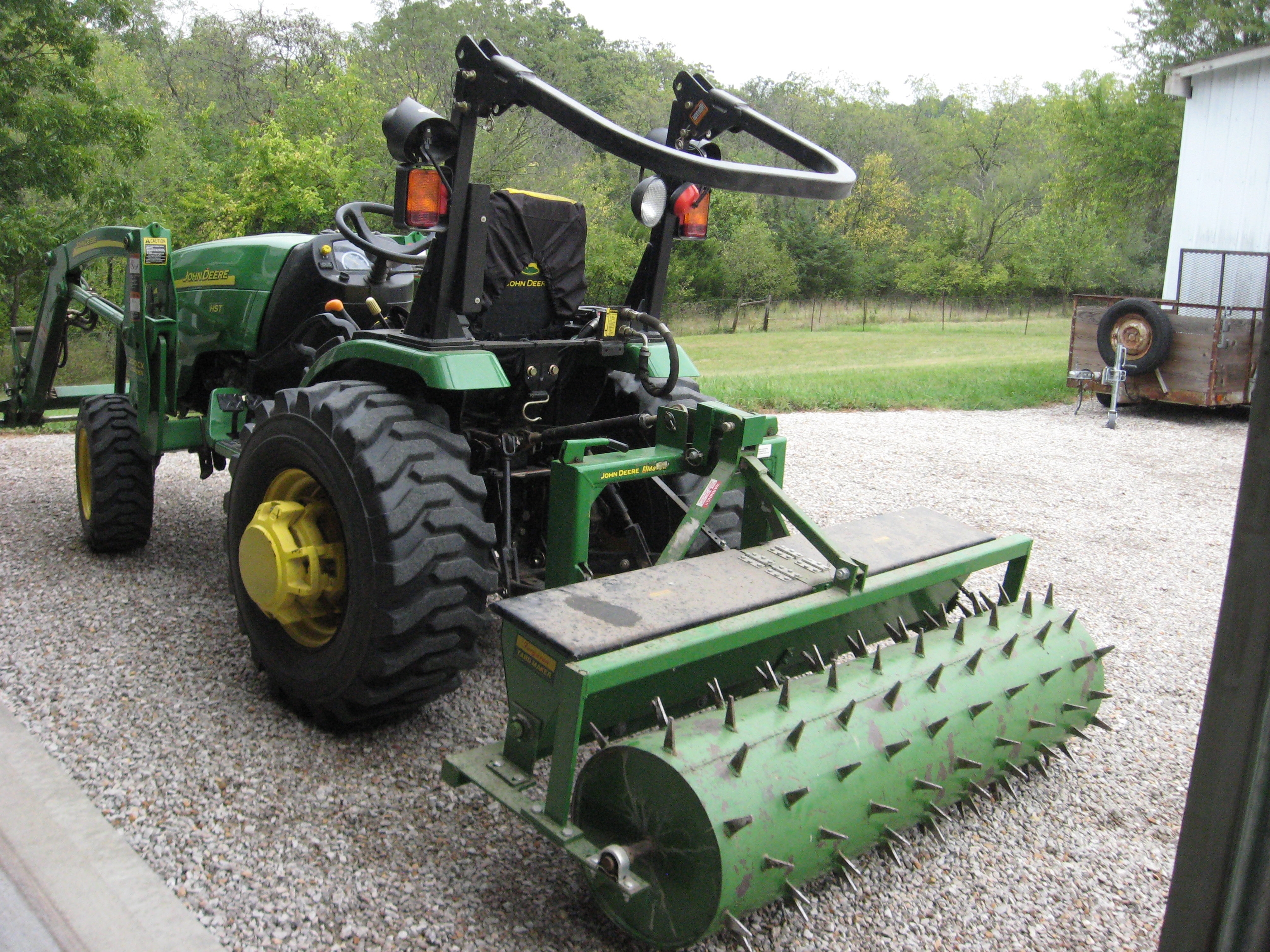

100% agree. I never use the Yard Maker (or anything else) to aerate the lawn, only for seed application. I believe that spike aerators probably compress the soil more than they aerate, whereas the core aerators actually do loosen the soil.
I mentioned that it only works if you "do it right". That means you can't just make one pass like you might with a slit seeder. To get decent results with the Yard Maker, first, the soil needs to be damp. If it's dry, you can't get any penetration (even with the drum filled with water).
Second, even though the seed holes do line up with some of the spikes, just one pass won't get enough seed into the soil. I make at least three passes on each section of yard. First pass is going forward, with the seeder gate open and dropping seed, some of which is being pushed into the soil by the spikes. Second, I shut the seeder gate and reverse over the same area as the first pass (to spike up more holes and to push more seed down into the soil). Then, I make another pass going forward (sometimes dropping seed, sometimes not, depending on how "bare" the area is).
Finally, I make one more pass going forward with the seed gate closed. As mentioned, not the most convenient or best way to do it, but it is cheap and it works fairly well. Depending on the area of yard I'm working on, I'd say maybe a 30 to 40 percent germination rate. If I could irrigate the yard, I feel the germination rate would improve somewhat. Also, some areas are just crappy soil (with lots of rocks underneath), so if they were amended, would probably get better germination.
I am using K31 Fescue.

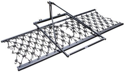

You may want to use a chain or tine harrow to de thatch. There are some 3 point ones out there rather than the drag type. I have a 12 foot 3 pt Priefert Chain Harrow.
