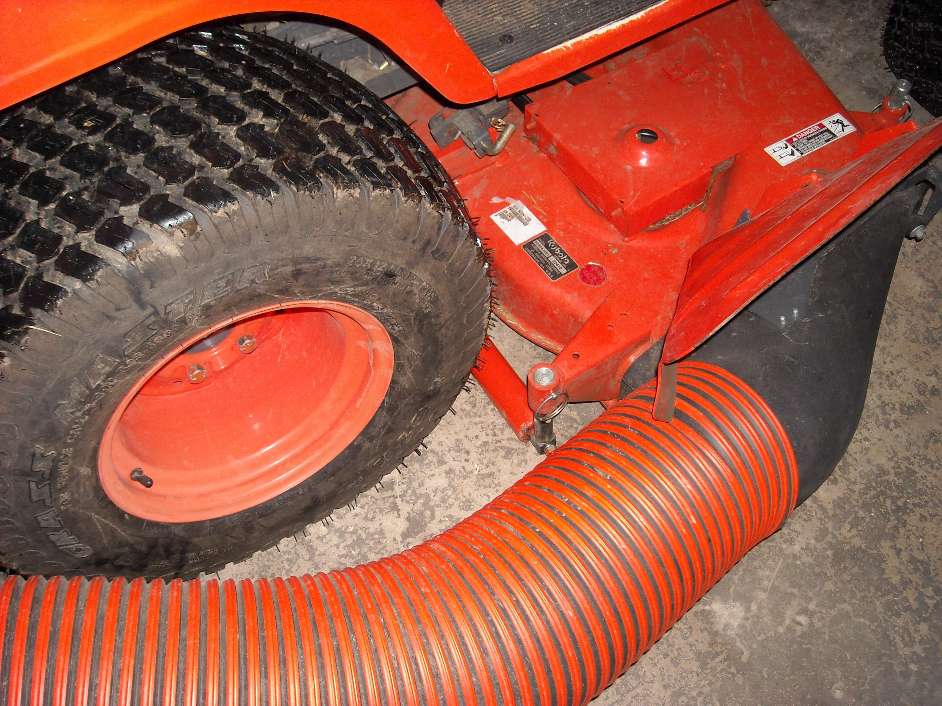

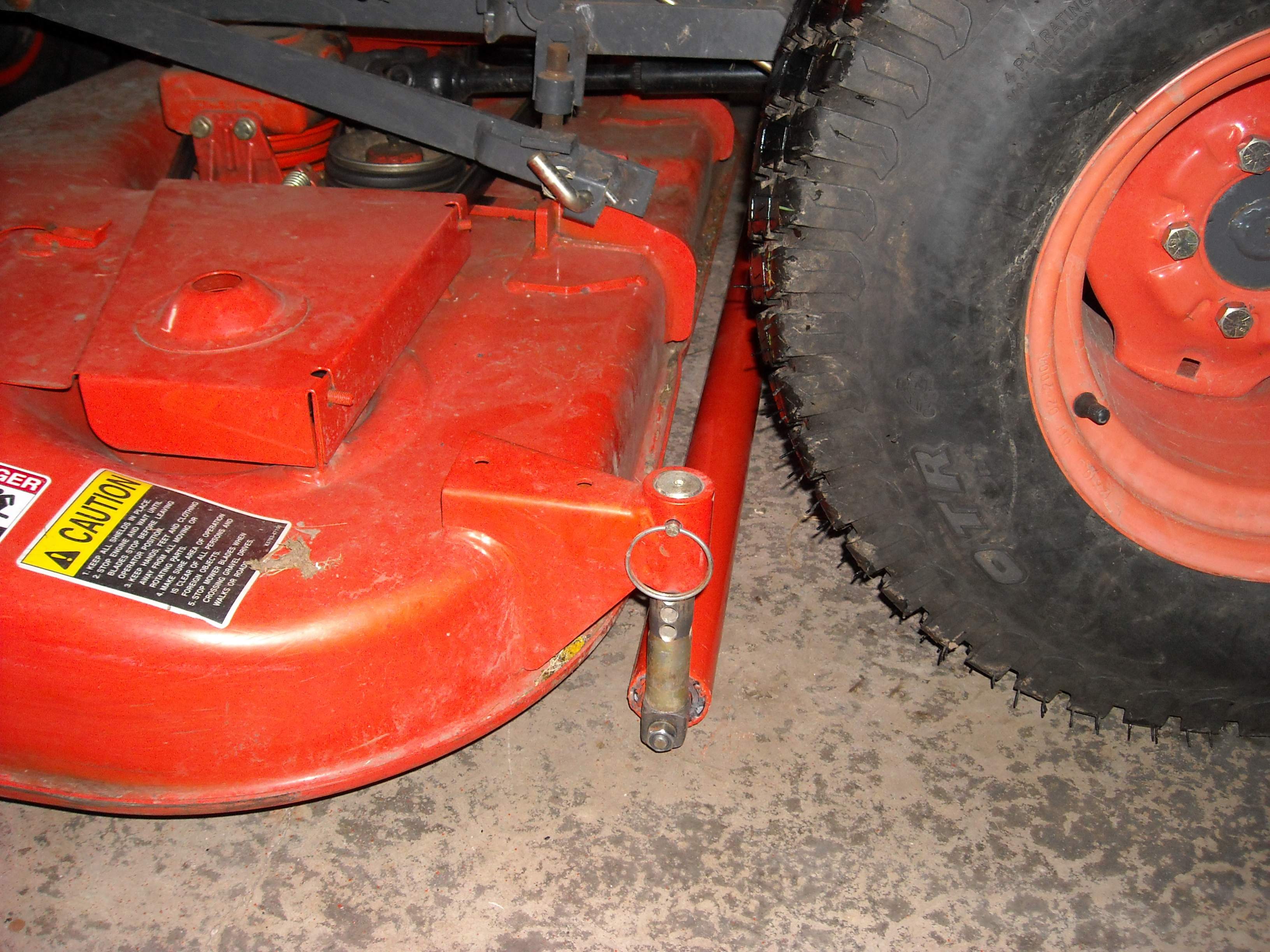

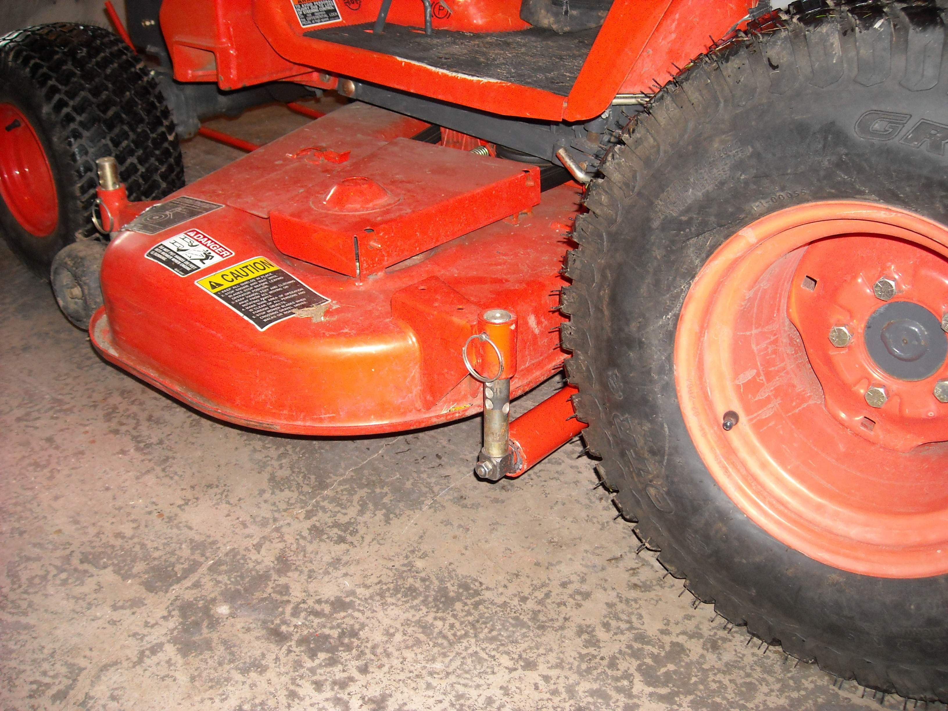

In answer to your question --- No, you don't have to raise the deck after each pass. Sharp turns with the roller down doesn't cause any problems. It functions just like a gauge wheel to keep the blades from scalping the lawn, but it has the added benefit of striping.
As far as the mounting location --- I have two stripers for my Bx2230. One is the deck-mounted roller which has very limited clearance between the rear tires and deck. This is really the only place to put a striper on the MMM on my model. The weight of the deck (200#) provides downward pressure to stripe the lawn.
The other version is a frame -mount model that attaches behind the tractor. It uses sand-filled rollers to create downward pressure. It is also in the picture section of TBN, just search for lawn striper or look at my photos.
