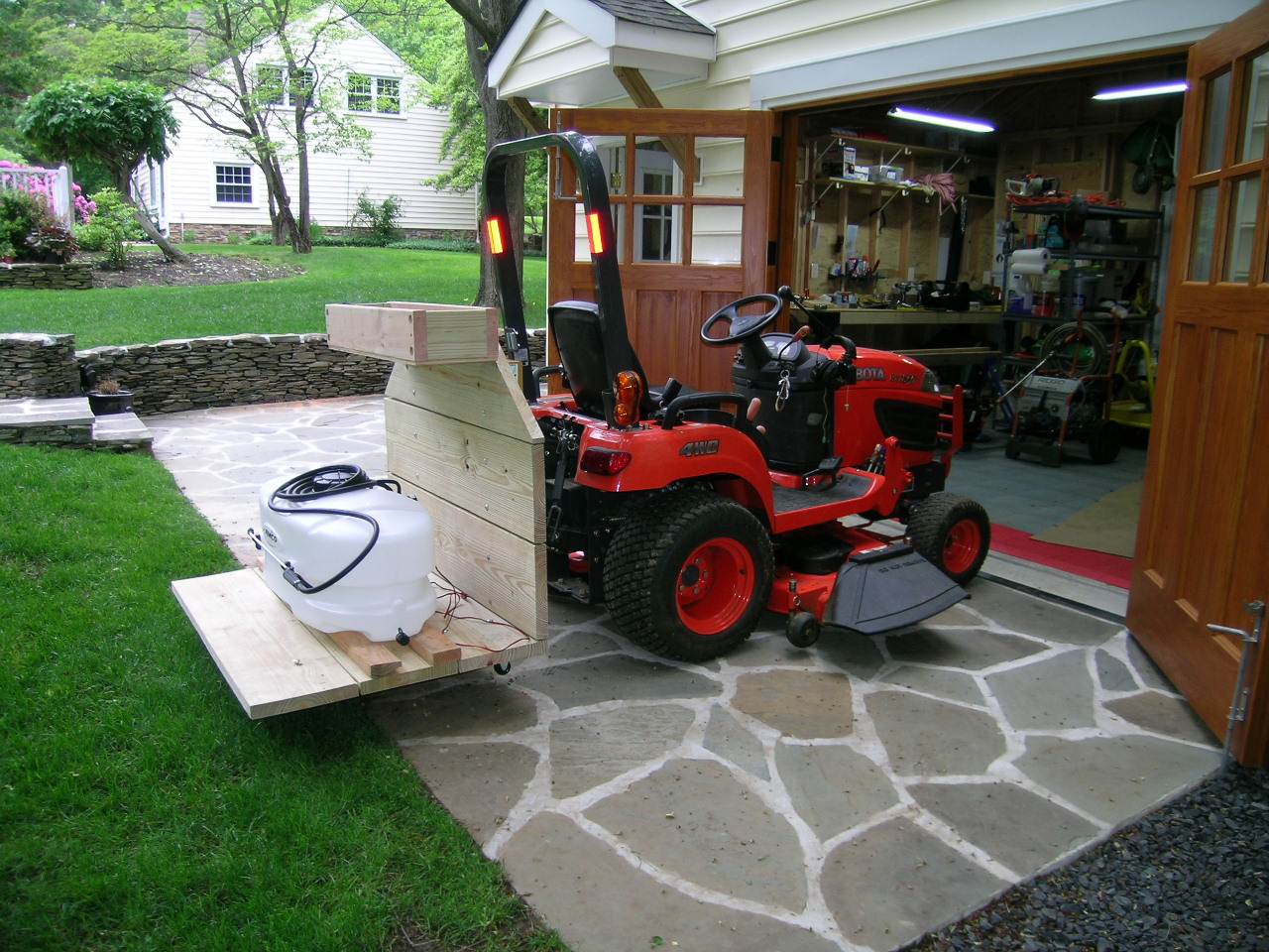

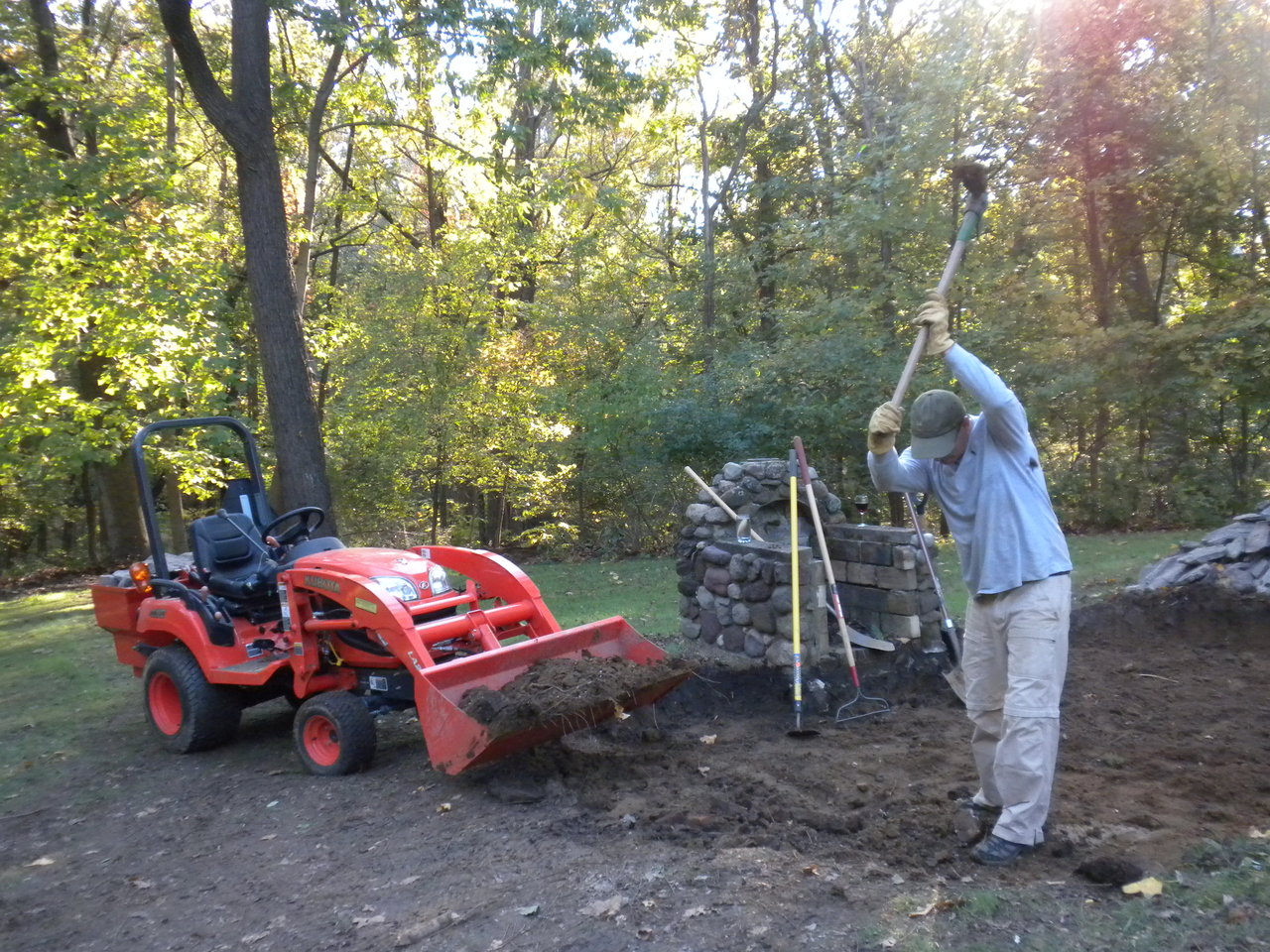

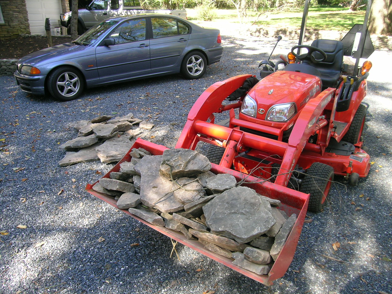

Nice :)
   / Lawn Tractor, Zero Turn, or Sub-compact? #45
wrooster, very nice work:thumbsup:

Wrooster,
You absolutely win the gold medal for compelling responses. Very nicely done - thank you!
And your yard is a LOT like what I have in mind for my place someday. I love what you've done. I bet you get a lot of satisfaction out of seeing the results of your labor. Love, love, love it!

Very nice Wrooster. I don't think you could have done all that with a ZTR. Why do I see a flagstone walk leading to the Barbecue or outdoor fireplace?

Good luck with your decision and new home. Looking back, almost everything I have done landscaping-wise has been with the assistance of my tractor. Nearly every piece of fieldstone and bluestone, and every yard of gravel and mulch that you see in my pictures above was moved by my SCUT. In the beginning, you will think that the FEL is the most expensive wheelbarrow ever and a tractor with a TPH/PTO as a luxury -- but eventually you will come to learn of the utility and the ease at which you can make projects happen. Of course my wife thinks that it is all a rouse to get more seat time... ;)
