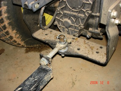

I have a Rubbermaid trailer. It is rated at about 1500 lbs and made of recycled plastic. To say it has taken a beating is an understatment. I used it with a ATV before I got the lawn tractor. I extended the tounge by 18 inches and put a rod end on it w/ a 5/8" hole. I put a cat 0 lower pin on the tractor vertically. this allows movement side to side and front to back with no slop. I adapted my Ranger with this setup also. It allows the trailer to roll with no damage to the hitch. I can take pics if you like.

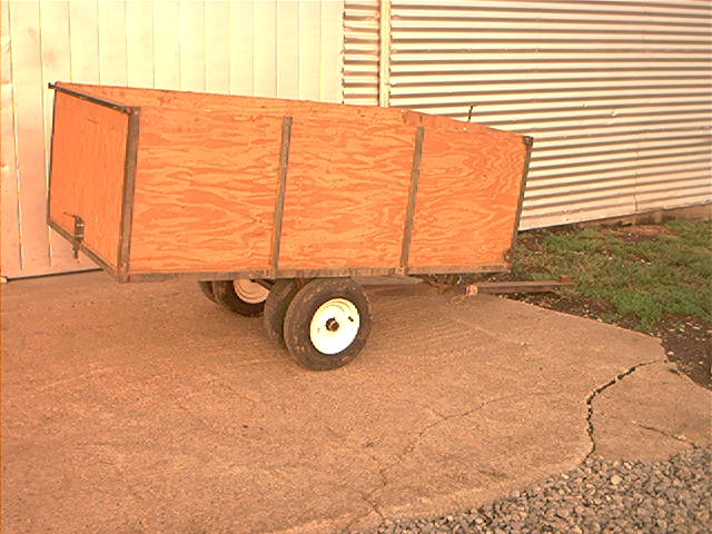

Here is a picture of the cart we built. It is 3 x 5 x 3 foot tall. It has dual wheels on each side and dumps. Have pulled it with lawn mowers, ATVs, and our CUT. Rolling loads are not a problem as long as the towing vehicle has the weight and braking to stop them.

Here is the trailer hooked to the tractor.

I like it. I tkink I'll try that myself. Thanks for the photo. Gerard

I have devised a different way of attaching the rod end but that pic did not come out good. I will post it when I get a better one. I get the rod end from Graingers. Item number 6G192.
