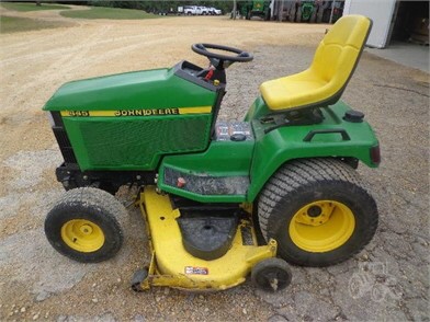

Deff lock is deff a nice option especially when it's wetter outside, I thought I buried that 445 a few times and it climbed out with a little wiggling. It's really nice when climbing uneven terrain. IMG_7332.JPG

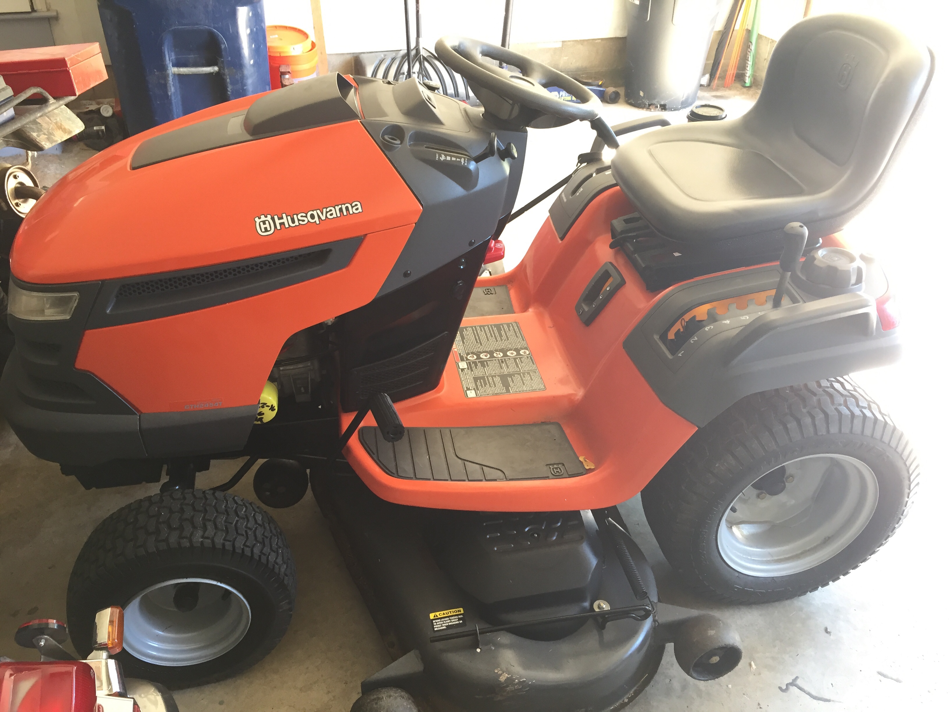

Mine is a GT tractor with the 24hp B&S with a 3 blade 54in deck. No power steering, hydrostatic trans and electronic PTO. IMG_6314.JPG
I bought it off CL with 200 hours on it for $800 last year.
Personally I feel that JD makes a better garden tractor, but for the price I can replace a husky with a brand new one twice for the money of the JD so that's kinda a wash.
Seems huskys burn up more deck belts but as far as longevity, my dad bought his 445 new in 2000 and it had a hair over 1000 hours in it without any issues.

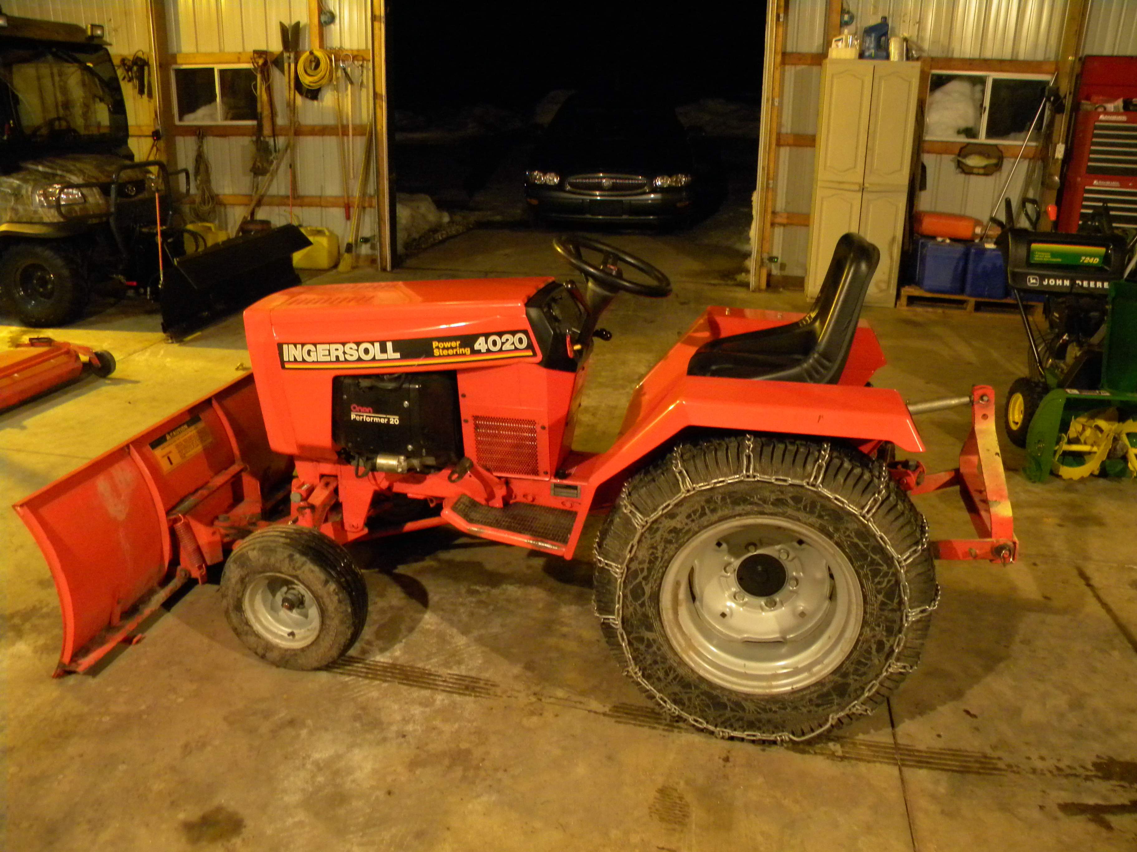

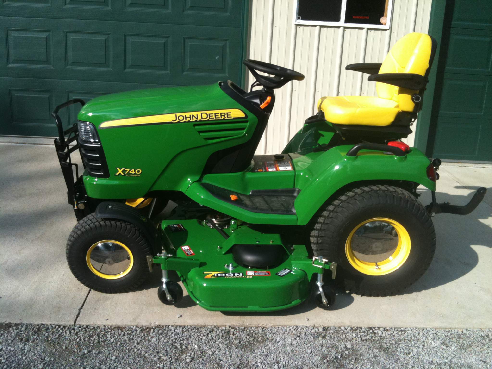

I went the JD X740 route 60 inch 7 iron deck diesel engine.My wife mows with a 1996 ingersoll 4020 with 20 hp onan engine.The JD 500 series are fine lawn tractors.Don,t know much about the huskys.
The ole Ingersoll "rocks" Coobie!!! Which would you rather use to push snow, Ingersoll, RTV???? ;)
   / Lawn tractors, yard tractors, garden tractors, SCUTS, and mowing #9
RTV hands down for snow plowing,love the cab with HEAT.My lovely wife would murder me if I ever sold her beloved Ingersoll.LOL
   / Lawn tractors, yard tractors, garden tractors, SCUTS, and mowing #10
Very cool that she likes to run it. Probly better keep it!!!! :)
