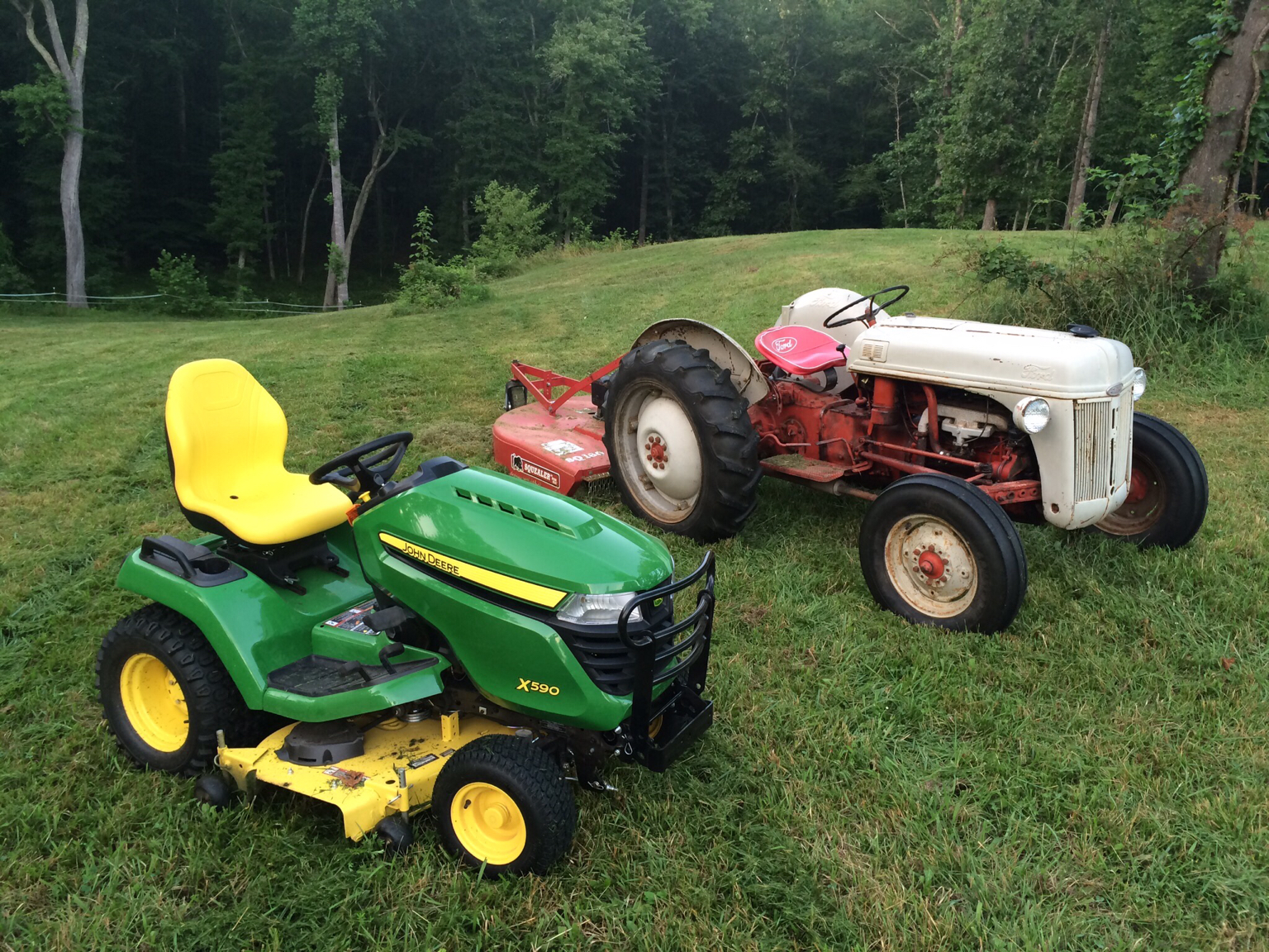

My two mowing machines. The 8N will be upgraded to a new Kubota or Yanmar in the next year or so.
   / Lawn tractors, yard tractors, garden tractors, SCUTS, and mowing #15
That x590 is one heck of a tractor you got there, pretty penny indeed.
I do miss power steering though, my father and I shared his 445 for about a year when I first bought my house, after I was able to buy my own mower it was a step down for sure but at least I didn't have to hook the trailer up and grab his mower or take his back every week, I didn't miss that part.
He only lives 10 mins away but still, that cut down my total mowing time not having to do that.
