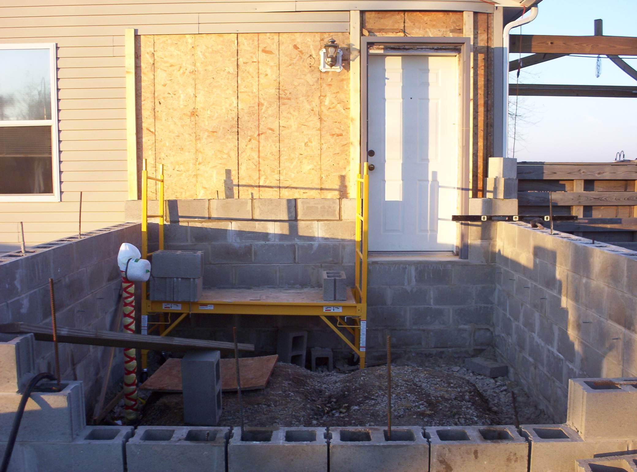

Over the summer I have been busy with my construction project. I'm building a garage that has a block stem wall that will be 3 layers above slab. The basic size is 28x40 with a 12x12 'storm' room. The questions;
1) How cold can it get before it affects mortar mix? I'm using 'S' Type cement mixed 3 to 1. My information is as long as it's above freezing during mixing. Not sure what happens if temps 40 during the day and drop in 20's at night. Opinions?
2) I plan on covering the top of blocks with treated 2x8 but not 100% done. What should be done if anything to prevent rain or moisture from getting inside the block and freezing causing cracking?
