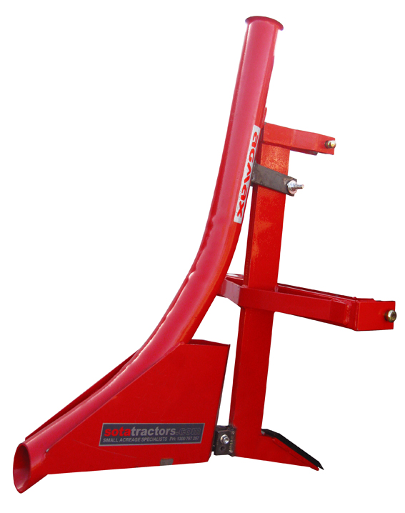

Greetings from down under (Aust) I am not familiar with the term "Middle Buster". This is the pipe layer I use. It takes 2" Poly pipe. Is this the same thing as a "Middle Buster"?
Cheers

no electrarc thats similar to a subsoiler but with that pipe going down the backside that would work great for installing wire and water line
