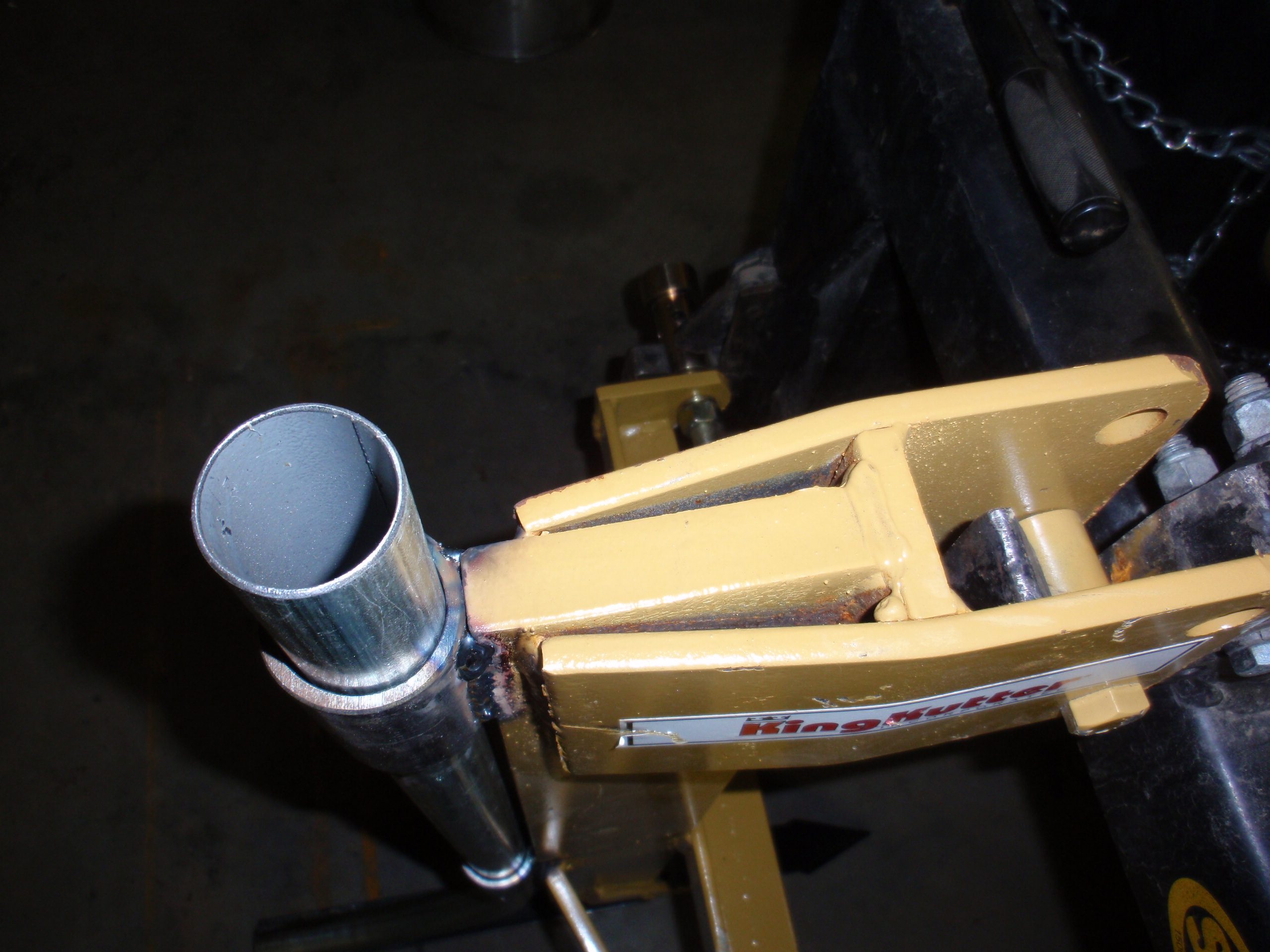

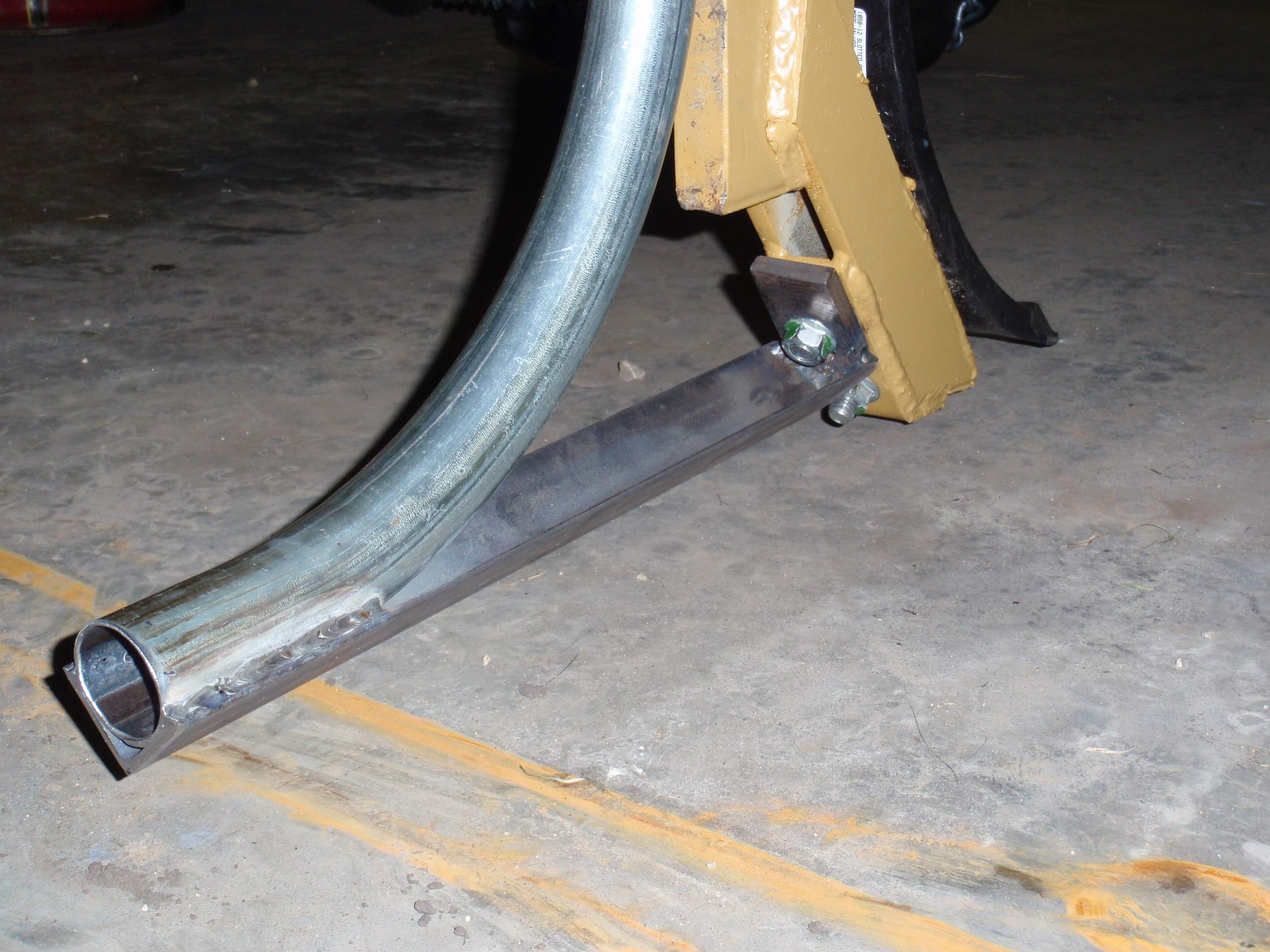

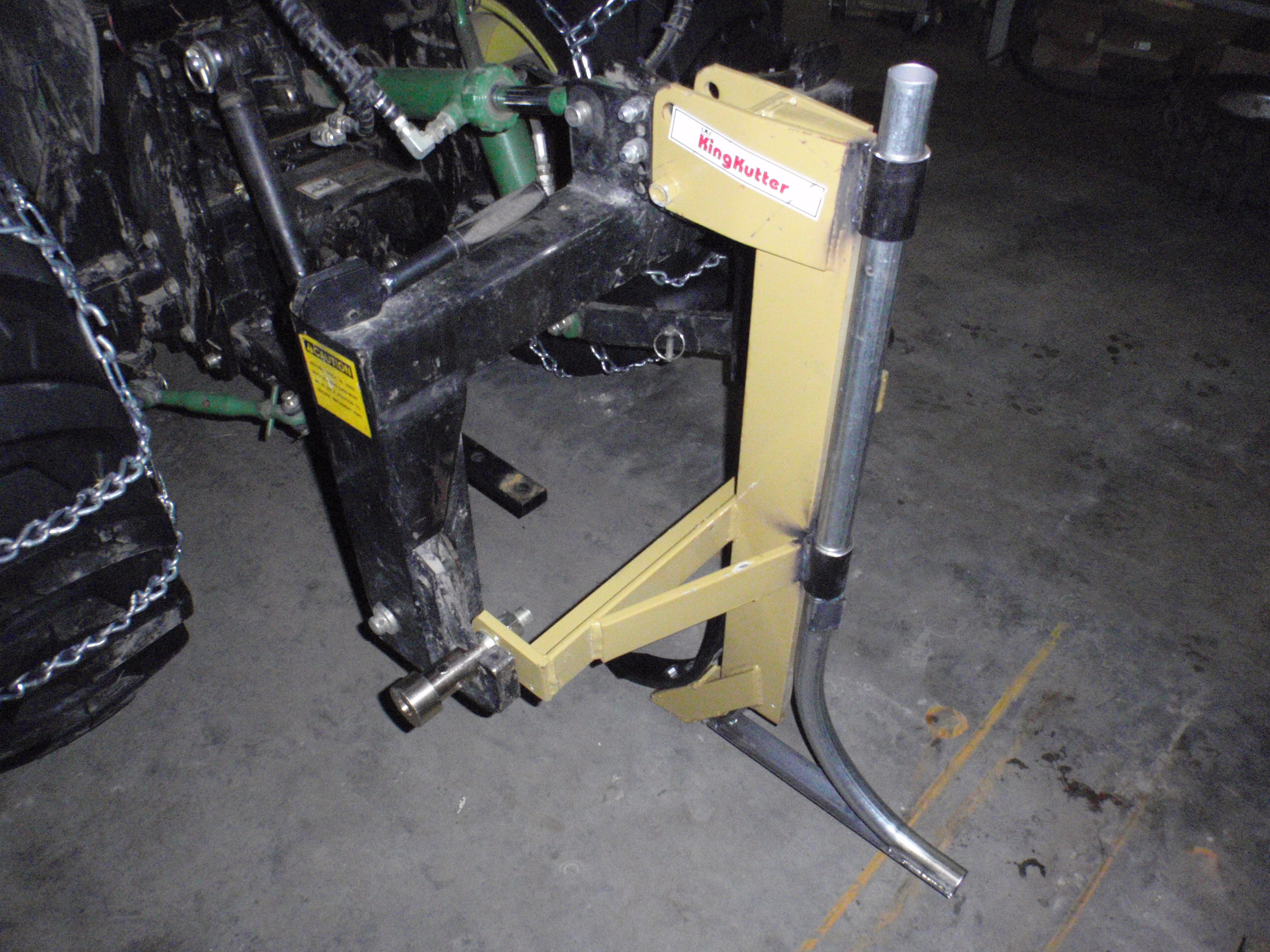

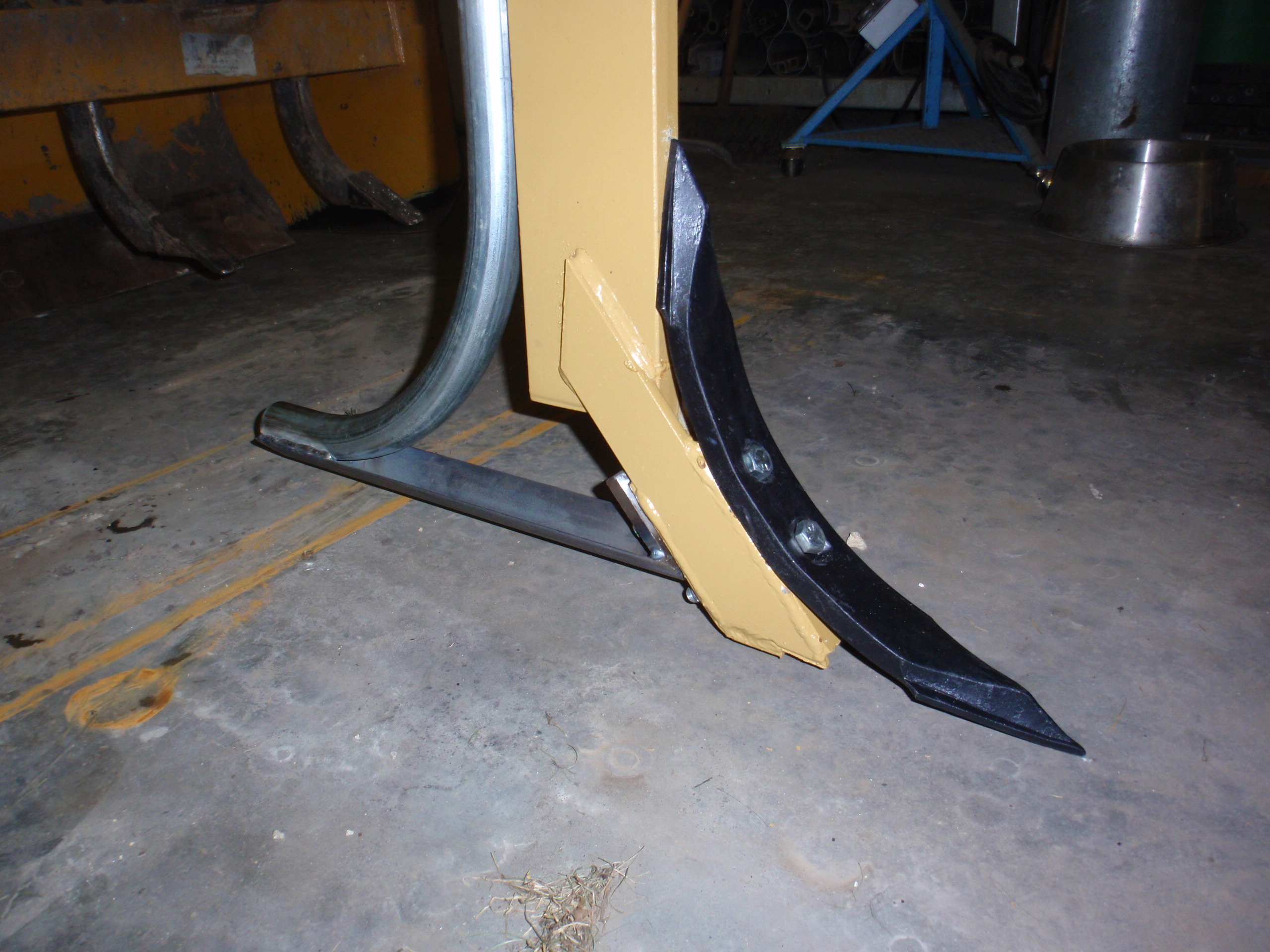

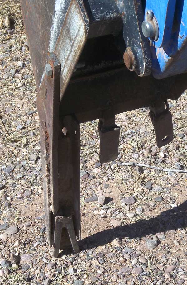

I built this. Haven't tried it yet. It started out life as a KK middlebuster. I added the tooth, and conduit, etc.
Looks good for coiled pipe Jim, and I have the same stuff available including the galvinized conduit sweeps and subsoiler gathering dust. Think I will copy your design. Thanks for posting the pics.
It's easier to just pull PVC pipe with a subsoiler plus PVC is better pipe with better fittings. I've done it with both types.
/ Laying Water pipe #24
Looks nicely designed. Try running it before trying to install anything. I found with mine I needed to add weight to keep it running deep. There's a lot of drag created by the vertical shaft that might cause it to run up. Probably why the other pictures show the use of all the suitcase weights.

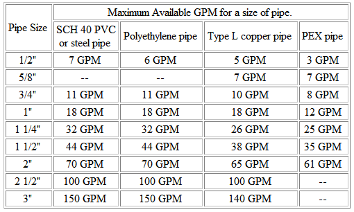

MNBobcat,
I would look around more, our Menards has black poly in 100 and 250 foot rolls and some supply houses have 3-400 hundred foot rolls. The larger rolls can be a pain to man-handle, but it can be done easily with a helper. That would get you to 1-2 couplings.
2" pipe is a lot of water and head pressure.....unless you need the maximum pipe output I'd consider maybe stepping down to 1-1/2", it's easier to handle if working with limited help. I've attached a volume chart for your reference. According to the chart (snagged on line) 2" will greatly exceed your pump capacity.
I've used black poly for years. Most problems I've seen were because of: 1) the use of the white plastic poly fittings that broke, and 2) the use of cheap hose clamps (not all stainless steel). I too have read about issues with plastic...but figure it comes with the territory. I used it 3 years ago on my house (450') ...no regrets thus far. Our local rural water company uses it for all taps from their main to their meter.
If you do use it there's a couple of things I do that make the joints really easy to get tight (and leak free :) )
Install the fittings with the pipe on the soil surface. Pick up "red brass" barbed fittings (as an example), our Menards carries a good supply of them. Use a small propane torch, heat the pipe gently around it's circumference. You know when it's "warm enough" as the pipe will look glossy, it makes slipping the fittings into the pipe (especially larger ones) in a cinch! Secure the fittings with 2 stainless steel clamps on each barbed end, pulling opposite directions and with the screws 180* opposite each other when the pipe still warm, don't over do it.
If you lay the pipe out on a "normal" sunny day and let it warm in the sun for a bit, it handles very easily. Trench the pipe below frost level, turn on the water purging the pipe of air, and to pressurize (looking for leaks) before back filling and you'll be good to go. Watch for stones; taking care to make sure you don't lay the pipe on or back fill with, large sharp rocks against the pipe.
Good luck with your decision....

Hi Rippy,
Thanks for the great info! I definitely want to make sure I size the pipe correctly. Is going too big on the pipe a bad thing? I don't need 70 GPM (which the 2" is rated for according to the chart). But the chart doesn't factor in distance. I thought the larger diameter would help given the long distance but if the larger size is actually a bad thing then I would want to go with the 1 1/2". I was trying to lower the losses over the distance.
Thanks again!

Hi Rippy,
Thanks again!
Here's a series of tables that might help you.
http://www.hunterindustries.com/resources/pdfs/technical/domestic/lit091w.pdf
