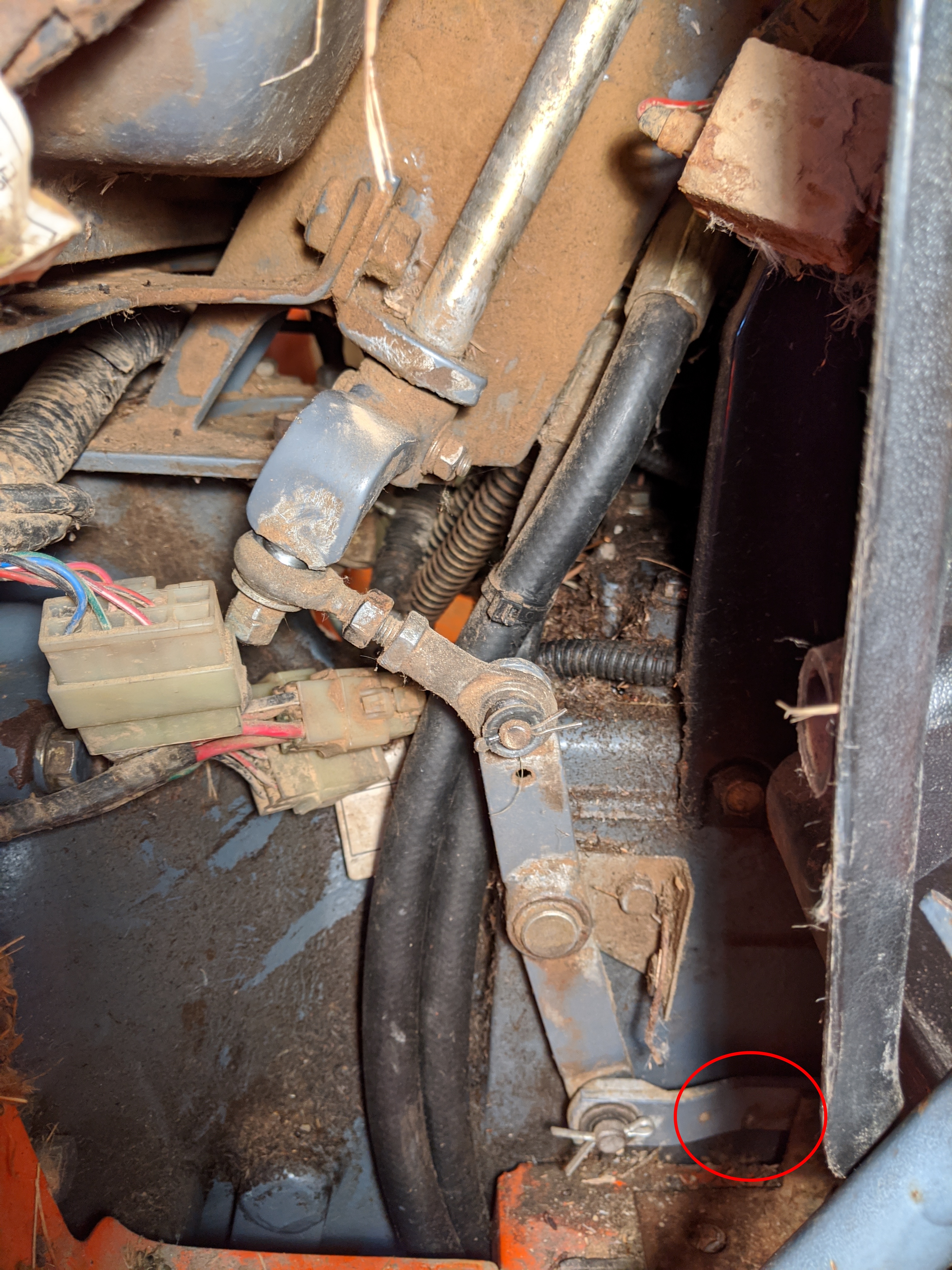

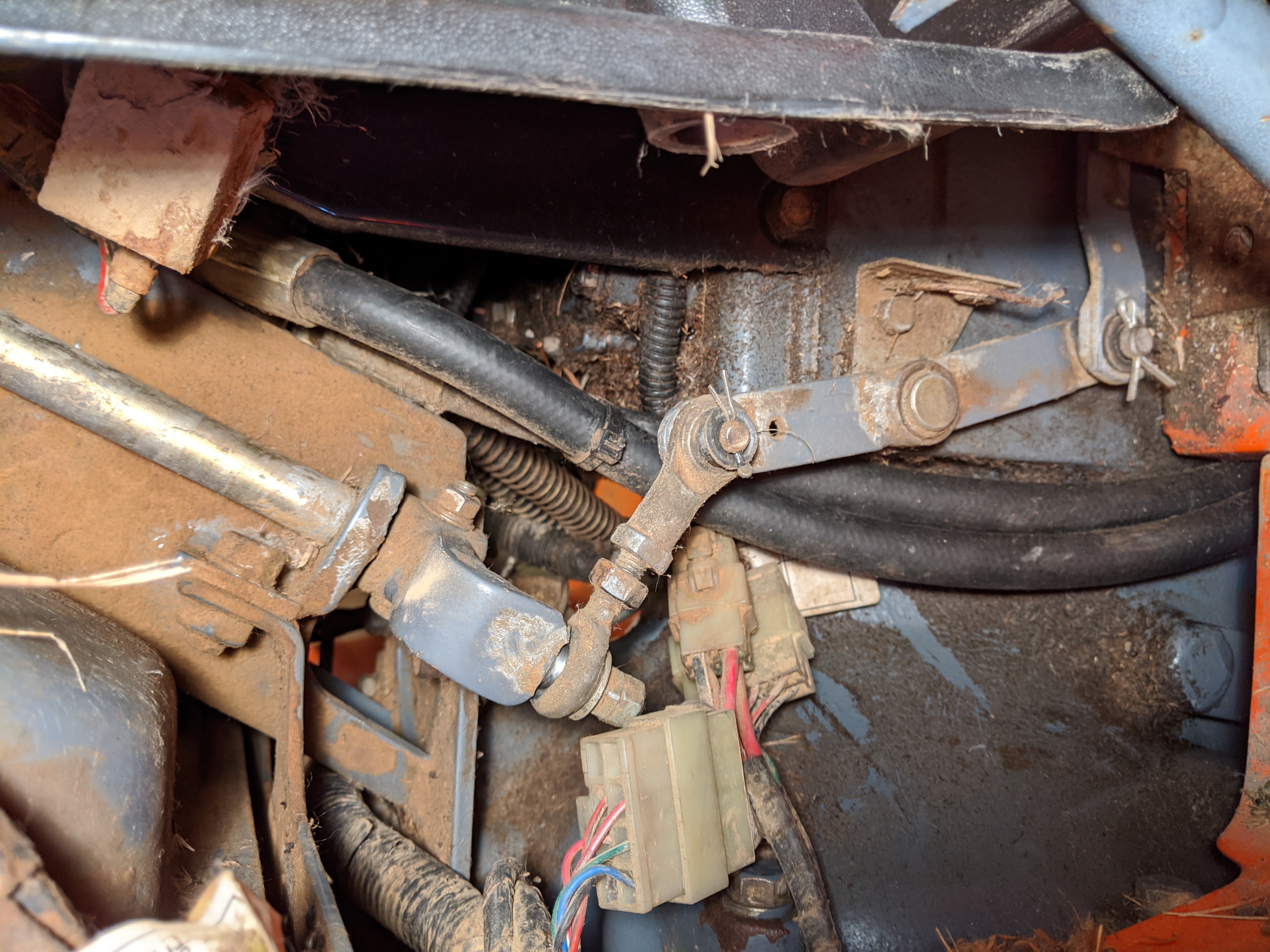

#13
I removed the panel today and this is what I found. In my opinion it needed to be adjusted. When I shift to forward the lever on side of transmission is either going slightly beyond the detent and then falling back into it, or it is not getting into the detent completely and falling out of it. I will need to start the tractor and see what it does. Hopefully I was able to adjust it properly. By the looks of the cotter pin I was not the first person in here which makes me nervous.

   / LB1914 Hard to get in gears/service manual? #14
It does seem like an adjustment might be all it needs. Good news there! I was under the impression it was physically hard to push the shifter handle into the forward position,,,,or does it move freely until it hits a 'stop'?
The shifter mechanisms (& synchronizers) that I am familiar with both have detents. The shifters are made to go ever so slightly past detent (just far enough for the detent ball to go beyond the deepest part of the groove, but not far enough to go past the groove) At that point, the synchronizer has reached detent; then a combination of the spring pressure and engine vibrations will bring the shift mechanism back into detent, which relieves the pressure between the fork and synchronizer.
I don't "think" it would be possible to adjust the linkage to go past detent...I don't think the rod (or fork) would have enough travel. (But that is just me thinking out loud!) Off the top of my head, I also can't think of any shifter that has 'stops' - other than the shift rod coming to the end of its travel, or the synchronizer ring contacting its mating gear.
Check that there is no 'slop' in the pivot (and rotating) points. There are so many of them that a little slop in each of them could really add up.
Best of luck!
   / LB1914 Hard to get in gears/service manual? #15
By the way, In the picture, it appears that the linkage going to the transmission is hitting what appears to be a (rusty) "guide"??? It's really hard to tell from the picture, but as you move the handle to 'forward', do those two items interfere? Does the "guide" appear to be 'factory', or added on? Could it have gotten bent?shifter.jpg

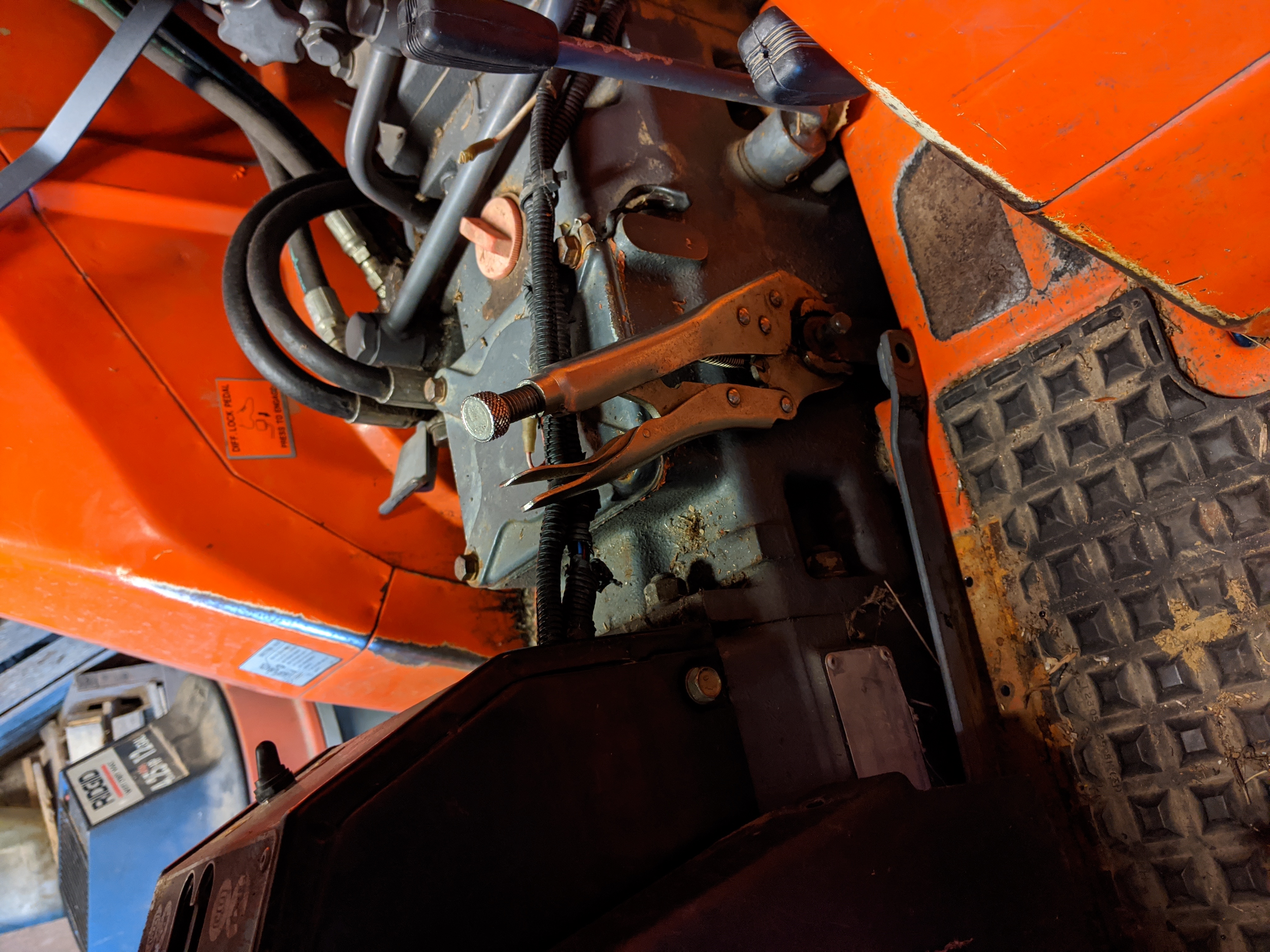

#19
I determined today my problem is internal. I disconnected the linkage from the transmission and put vice grips in its place. With the tractor running I could easily put it in reverse however forward only worked sometime. The lever would only go so far then stop. I would have to keep trying 4 or 5 times before it would go into gear. Sometimes it would work perfect but it resisted going into gear more times than not. I still need to pull the cover on the transmission to see if I can see anything wrong. Going to call dealership and see if they can give me a ballpark figure to fix it.

   / LB1914 Hard to get in gears/service manual? #20
That is a bummer! I would agree with your decision to pull the cover - just 4 bolts, and maybe you could see the problem. Look closely at the shifter fork to see if there is wear (where it fits into the synchronizer).
Your transmission has a very different (shifter) arrangement than my DK45, so I guess I am no help.
Best of luck!
