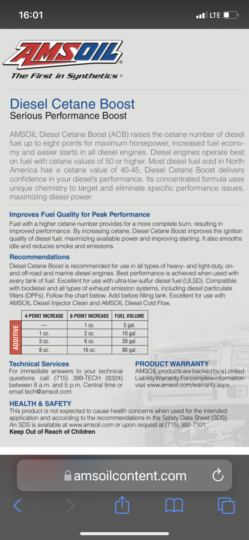

Here’s a picture of Amsoil Cetane boost, with some info, that I use. You should try a Cetane boost of your favourite brand and see if it doesn’t make a difference. Diesel needs to be over 50 cetane to ignite/burn efficiently but it’s generally not even close. Hopefully the picture opens…

One method for troubleshooting diesel starting issues is to buy an inexpensive RPM tester.
Diesel engines require about 200 rpm for reliable starting. Even when the engine sounds like it is spinning fast enough, it is difficult to tell whether it is, if you don’t have a tester.
In cold weather, diesels need a battery that is in above average condition.
