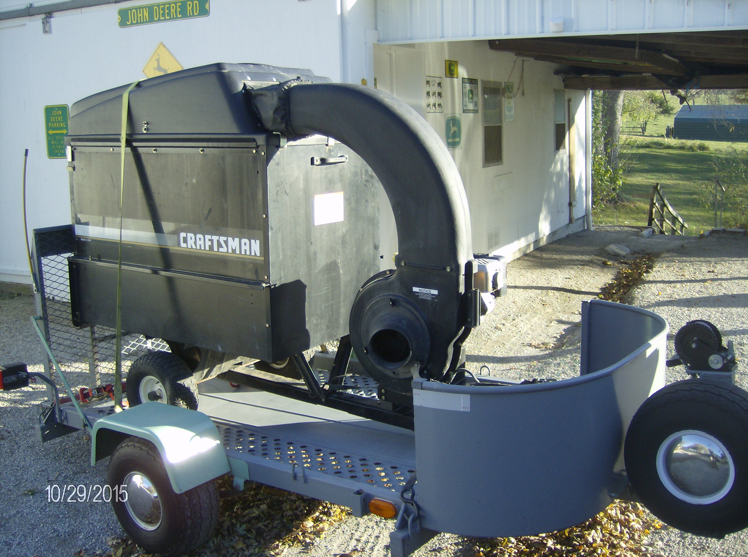

I picked this up off CL last fall: Garden Tractors 2015 001 (4).JPG had enough hose from a previous project to make it to the mower. Bought a new remote hose for it. Use it on my 1980 JD 314: Garden Tractors 2015 001 (5).JPG
