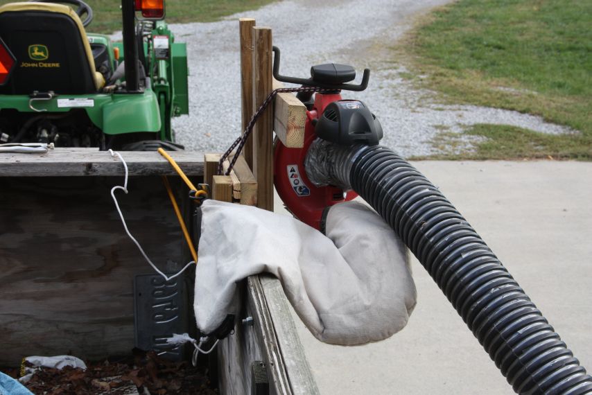

So far I haven't had a real opportunity to put it to the full test. But my plan is to disassemble the tubing and use the blower attachment to blow the leaves into either piles or windrows. I suppose that piles would be the better option at which point I would basically rake the leaves to the end of the suction unit. I might try to attach the original vac attachment to the tubing just to ease the process. The rake is wonderful for long piles of grass but not so much for leaves. By making piles of leaves in regularly arranged rows I could use a sort of hybrid pile/windrow technique by which I simply drive from one pile to the next and use a hand rake to move the leaves to the tube opening. Thus far, the small tests I have done show that the dry leaves get sucked up with no effort at all. We have some gumball trees that leave their annoying gumballs on the ground. But they also get sucked up with ease and get shredded nicely too. This was a good sign as I was a bit concerned as to just how dense/hard an object the vac could handle. It also shredded some small sticks, but I won't through too much of those in the vac. Essentially, I can drive tractor with the trailer to an optimal point and then hand rake to the opening and let the airflow work its magic.

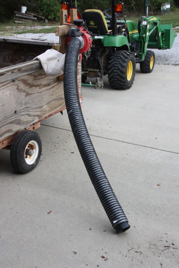

Seems you have the blower attached to the sideboard of the trailer, why not connect the end of the tube near the outlet of the mower deck. Then mow over the leaves and suck in what blows out as you pull the trailer while mowing?
I was thinking you were looking for an easy way to pick up leaves. That to me doesn't involve walking around with a rake or a blower, or dragging a tube around. ;)

I would have made an attachment to the belly mower, but as it stands right now, all I have is a rear discharge Land Pride RFM. While I could block off part of the outlet to concentrate clippings to my vac, this seems like asking for trouble. I think the plan will be to rake/blow leaves into piles then vac/shred them into the trailer.

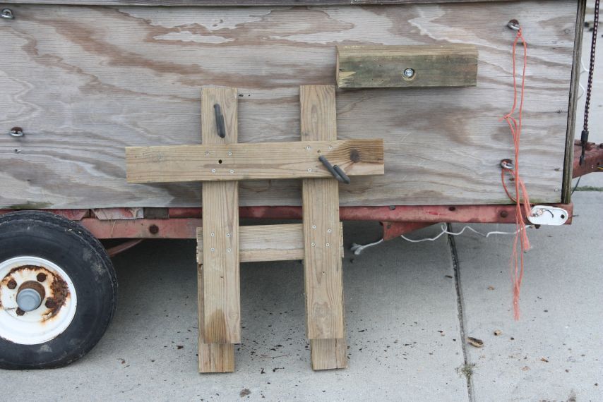

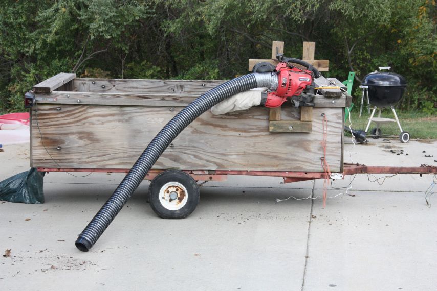

OK, I think I should clarify my reason for my zebra, the 5$ truckloader. Typically, my neighbor lets me take every single leaf from his yard. Normally I would simply rake the leaves into great big windrows, piles, or piles in a line. The raking I find kinda fun and good exercise. The problem with this method has always been getting leaves into the trailer. While the raking is relatively fast and leaves immediate results, hauling those leaves into the trailer is a pain in the back (literally and figuratively). I have used rakes, big rakes, and even grain scoops. While I will eventually get the job done, hauling into the trailer has always been the slow part of the entire operation. further, the leaves tend to not pack well unless I use a grain scoop to push the load down hard into the trailer. Even then, I feel a bit silly as the trailer can carry far more weight than the packed in leaves would suggest.
This is where the truckloader comes in. As I have no belly mower or mower of any type with any sort of adjustable airflow, I mounted the vac and tubing backwards so that it could be driven forward with ease. I still plan to rake by hand, but I might have to switch to using the leaf blower in its conventional fashion in order to collect the leaves. Then I plan to mount it back to the trailer and convert it back to the truckloader configuration and suck up the piles instead of picking the leaves up manually/awkwardly with a large rake and Grain scoop combination. Hopefully then, the actual loading of leaves will be considerably eased and the leaves will come out shredded so I can load much, much more into the trailer (8'x4'x2'). Last but not least, I will then take these back to my gardens and give them a nice dose of chopped up leaves with which to add more organic matter into the soil.
I hope this clarifies the reason and justification for the general design of the vac truckloader.

That explains the activity. I was not thinking that you just wanted to move raked leaves from the ground piles into the trailer.
Keep us posted how well it works out. We'll be anxious to hear about your venture.
